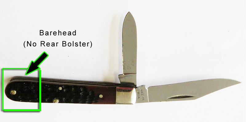

Barehead: This term refers to a knife that does not have a rear bolster. Click for illustration

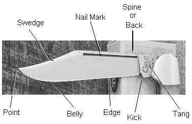

Belly: The curved part of the blades edge. Click for illustration

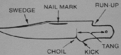

Choil: An unsharpened part of the blade located opposite the point on the sharpened side. Click for illustration

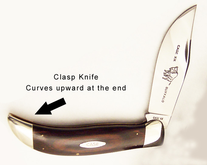

Clasp: A style of jack knife that curves upward at the end. Click for illustration

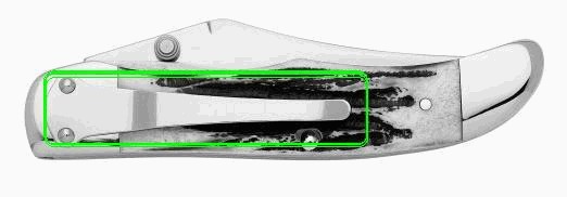

Clip: An accessory on some knives used to attach a knife to clothing or a belt. Click for illustration

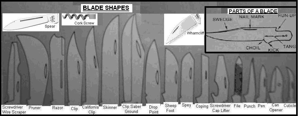

Clip Blade: The clip blade is generally the most common blade found on American folding knives.  They have a concave curve from the back of the blade to the point, and a cutting edge that slopes upward to the point.  These features make them extremely versatile and enable them to perform almost any cutting tasks.  Some of these blades have a longer concave curve on the top that generally makes for a more narrow blade.  The narrower blade creates a sharper tip that is better suited for detail work but are not as strong.  The narrow clips are often called California clips, muskrat clips, or Turkish clips. Click for illustration
Concave Grind: A grind that results in a blade bevel that tapers from the spine to the edge in an arched manner. It is the easiest grind to keep sharp, but has a weak edge that will chip easier than most other grinds. Click for illustration
Coping Blade:  These are narrow blades that have a sharp point.  The edge is flat like a sheepsfoot, but the back angles sharply from the spine.  They are ideal for cutting patterns on a flat surface.  Also, their thin size makes them handy when cutting in tight spaces. Click for illustration

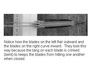

Crink: A bend at the beginning of the tang of a multi-blade knife that prevents the blades from rubbing one another. Click here for illustration

Drop-Point Blade:  The drop-point style blade has a convex curve on the back that slopes downward toward the point, and a cutting edge that slopes upward in a slightly more dramatic fashion to the point.  These features create a wide tip that is very stout and ideal for heavier tasks.  The wider tip is not as handy for penetrating through an object as the spear and clip blade. Click here for illustration

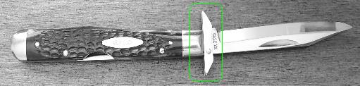

Guard: The metal piece located where the blade and the handle meet. It is designed to stop the hand from slipping into the blade. Click for illustration

Kick:  A projection on the front end of the tang that keeps the blade from touching the spring. Click for illustration

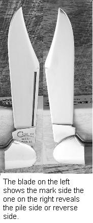

Mark side:  It is the side of the blade with the nail slot and company logo. Click for illustration

Nail Mark or Nail Nick:  Located on pocket knife blades. It is a semi curved slot cut into the steel used for opening with a thumb nail. Click for illustration

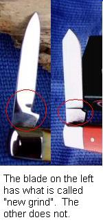

New Grind:  This term describes a knife that has an even taper from the back of the blade to the tang.  It was used on some Case knives in the mid 80's. Click for illustration
Pen Blade:  This blade is very common on knives with two or more blades.  It is popular because of its versatility  in performing smaller tasks.  The back and the edge of the blade generally slope evenly (at the same degree) to the point.   They are much like the spear blade but are smaller.  These blades  were originally designed to sharpen quill pens. Click for illustration
Pile side: The opposite side to the front or mark side.  Also called the reverse side. Click for illustration

Pruner's Blade: These blades have an edge that curves in a concave fashion to the point.  The back of the blade curves in a convex type fashion to the point.  These characteristics result in a blade that resembles a hawk's bill.  Because of this, they are often called hawkbill blades.  They were originally used for pruning shrubs and fruit trees, but are now more handy for cutting sheetrock, carpet, roofing paper and other such materials. Click for illustration

Reverse: The opposite to the side of the blade with the nail slot and company logo. Click for illustration

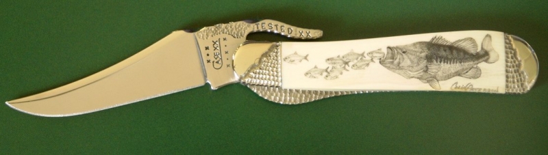

Scrimshaw:  The art of cutting or poking holes & filling them with ink to create meticulous designs. Often done to knife handles made of ivory or other soft materials. Some harder materials such as bone are used on occasion. Knife manufacturers have designed knives that have mechanically engraved images that some collectors refer to as scrimshaw. Click for an illustration of hand made scrimshaw design

Sheepsfoot Blade: This blade has a flat cutting edge, and a back that slopes to the point.  The blade looks much like the hoof of a sheep (imagine that.....).  This blade is ideal in yielding a clean cut on objects lying on a flat surface. Click for illustration

Spear Blade:  This blade has a back and cutting edge that curves in the same fashion or degree and meet at  the point.  Some spear blades are more thick than others.  The thinner blades are ideal for penetrating through an object, while the thicker versions are slightly less handy for penetration, they are quite stout and are handy for heavier tasks.  The blade tip is less likely to break than the thinner version. Click for illustration
Spey Blade:  This blade has a very blunt point that makes it unsuitable for penetrating objects.  This makes them ideal in skinning.  They are much less likely to be accidentally poked through a surface.  These blades were originally developed for use in castrating animals. Click for illustration
Spine: The unsharpened edge of a blade opposite to the cutting edge, also known as the back. Click for illustration

Swedge:  An unsharpened bevel on the spine or back of the blade Usually toward the tip. Click for illustration

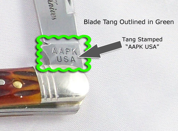

Tang:  The back portion of the blade that extends from where the blade attaches to the handle to the start of the edge. Click for illustration
Tang Stamp:  Any markings located on the tang of a knife. Most often, the stamp will have the manufacturer's name, date identification, or other informative markings. Click for illustration

Wharncliff Blade:These blades have a strongly curved back and a flat edge. This design results in a needle type point that is ideal for cutting cleanly on flat surfaces and for cutting meticulous designs. Click for illustration
