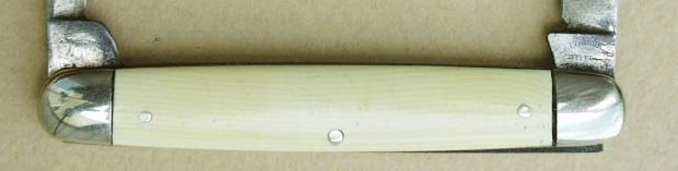

1 = White Celluloid
white_celluloid.jpg (16440 bytes)Celluloid is a petroleum based material that is often colored and/or impregnated with vivid colors. White celluloid is simply died white.... Perhaps to imitate ivory? Knives made of this material should be kept separate from other knives and checked for problem spots more often because the material emits fumes that will promote rust.

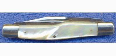

3 = Genuine Mother of Pearl
catt_pearl.jpg (16910 bytes)This materials was made from the inner shell of oysters. Small thin pieces of the shells were bonded together to form large sheets that are then shaped into handles.

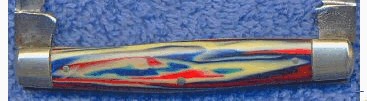

4 = Celluloid
Celluloid is a petroleum based material that is easily molded into handle shapes and impregnated with colors that allow for a large number of handle colors and designs. Knives made of this material should be kept separate from other knives and checked for problem spots more often because the material emits fumes that will promote rust.

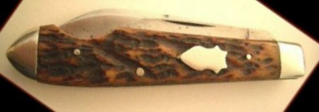

5 = Genuine Stag
stagcatt.jpg (10675 bytes)Stag handles are made from the antlers of deer. It is very popular to collectors because of its beauty, durability, and the fact that no two handles look exactly alike. The material most often comes from the outer cut from the antlers of Sambar Deer from India.

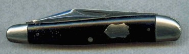

6 = Ebony
ebony_catt.jpg (11830 bytes)This is a dark, almost black colored wood from Africa. It is very hard is extremely fine grained.

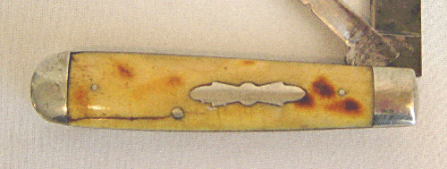

8 = White Bone
9 = Jigged Bone / Bone Stag
catt_bone.jpg (12284 bytes)Bone handles come from the shinbone of cattle. Over the years, it has been the most used material in making knife handles. It allows for numerous variations because it can be died any color, and jigged in many different ways. It was originally used to imitate genuine stag. This is where the name bone stag came from.
