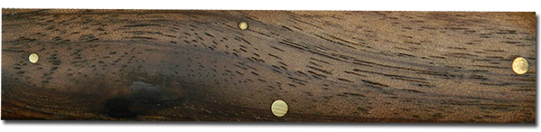

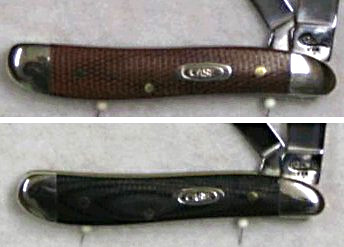

1 = Walnut
Case wood 1199 patternWalnut handles are most commonly found on cheaper work knives such as the 1199 SH pattern and 12031 electrician's knife because it is relatively inexpensive to get and make into a knife handle. It is also quite rugged and durable.

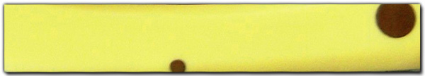

3 = Yellow Composition
Case Yellow Composite HandlesCase created this bright yellow handle material for durability, and unmatched visibility. Knives made from it are almost impossible to loose.

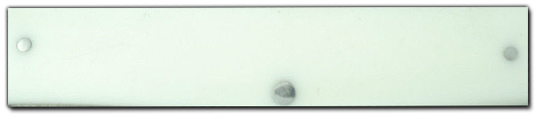

4 = White Composition
Case White Composite HandlesWhite composition is the same material as black composition and yellow composition, but is dyed a cream white rather than black or yellow. Case discontinued it in the mid 70's.

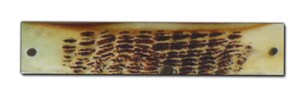

5 =Genuine Stag, Second Cut Stag, Red Stag, or Midnight Stag
These handles are made from the antlers of deer. It is very popular to collectors because of its beauty, durability, and the fact that no two handles look exactly alike. Over the years its availability has been limited and it has been temporarily discontinued several times. From 1972 to some time in the 1980's, Case did not use stag for its regular production. It was used sparingly for a few collectors' sets such as the 1977 blue scroll set, and the 1978 red etched set. Following the 2000 production year, it was limited in its use again for some time because of an embargo on Indian Sambar deer antlers, which were Case's main supply. Case started making knives from left over stock, and some using antlers from deer found in other regions of the world while supplies were limited.

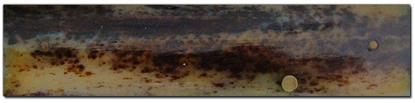

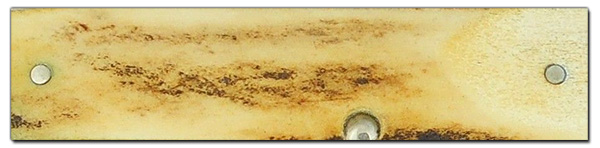

Genuine Stag
Case Genuine Stag Knife HandlesGenuine stag has been used by Case since its early days. The material is cut from the outer part of a deer's antler. The material is treated by flame to seal the surface. This process gives it a darker more pronounced look.

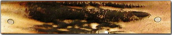

Second Cut Stag
Case Second Cut Genuine Stag Knife HandlesSecond cut stag is made from deer antlers. Many collectors say that it is taken from the antler after the first layer has been removed and then jigged.

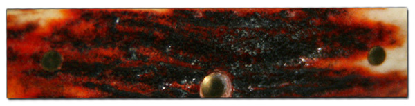

Red Stag
Case Genuine Red Stag Knife Handle CoversCase's recent Red Stag is the same as genuine stag except that it is died a red color. Some red stag Case knives have an R preceding the 5 in the pattern number.

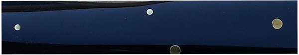

Midnight Stag
Case's Midnight Stag Handle CoversMidnight Stag is the same as Genuine Stag except that it is much darker in color. There is often an M preceding the 5 in the pattern number.

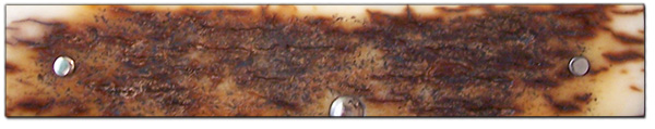

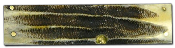

Vintage Stag
Case's V5 Vintage Stag Handle SlabsVintage Stag Has a V before the 5 in the pattern number. This material is cut from the outer part of a deer antler, and is much like genuine stag, but is not flame treated.

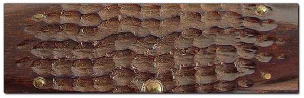

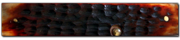

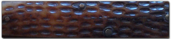

Case's Jigged Pretty Bone Handle Scales
Case's Jigged Green Bone Handle ScalesBone handles come from the shinbone of cows. Over the years, it has been the most used material in making knife handles. It allows for a wide range of variations because it can be died any color, and jigged in many different ways. The earliest colors used by case were green, brown, and red. Now you can find about every color under the sun. In addition to the color variations, there is many different cutting or jigged patterns including: Smooth, Standard, Rogers, Corn Cob, Rogers Corn Cob, PeachSeed, etc...

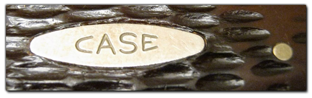

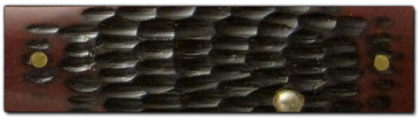

Case's Jigged Delrin Handles
Case's Jigged Delrin Handles - Front With Shield
Delrin was introduced by Case in 1967. It was created to look like genuine bone, but was cheaper and more durable. Knives made of this material are usually less collectible than bone, and can be hard to tell apart to an untrained eye. (especially since it has the same handle material number as bone). Case started producing delrin handled knives without a circle around the shield in 1975. Before 1975, the shields are the same.

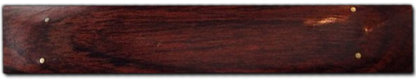

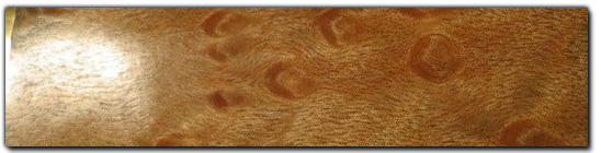

Case's Curley Maple Knife Scales
Curley Maple

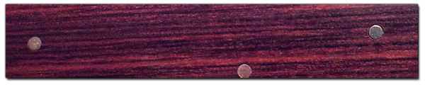

Case's Rosewood Knife Handles
Rosewood

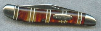

Imitation Tortoise Shell
This material was used by case on knives manufactured prior to 1940. It was intended to look like genuine tortoise shell.

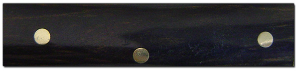

Black Pakkawood
Case XX Sharkstooth Black Pakkawood HandlesWhen Case introduced the Sharkstooth pattern knife, they intended to use Curley maple handle material. Because of this, they stamped the blades with a seven. The company ended up using black pakawood. Rather than throwing out the pre stamped blades marked with a seven, Case put them on the Pakawood Sharkstooth knives.

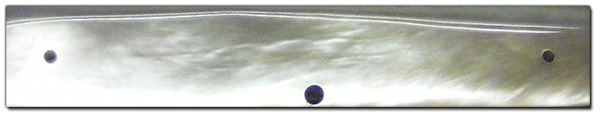

Genuine Pearl or Mother of Pearl
Case XX Genuine Mother Of Pearl HandlesThis material comes from mollusks located in the Orient and Australia. At various times in Case's history, this material has been in short supply. There have been several years that Case did not use the material.

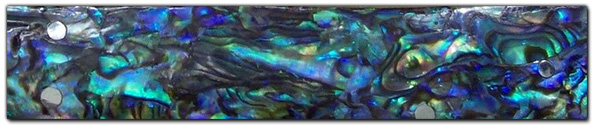

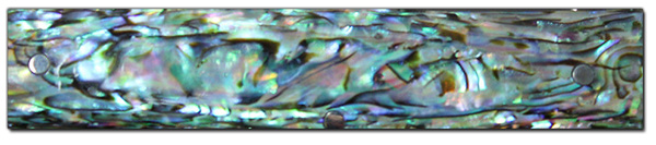

Abalone
Case XX's Genuine Abalone Knife Handles Abalone is the same as Genuine Pearl except that it is made from more colorful gastropod shells that come from the waters of California and Mexico.

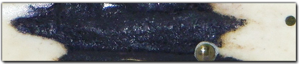

10 = Micarta
Case XX's Micarta HandlesMicarta is a durable and light weight paper or linen based laminante that is bonded together with epoxy resin. It starts as large sheets and is later cut into the desired handle shape. Case has manufactured a few special factory orders, and a limited number of standard issue knives (Lockhorn in particular) using micarta.

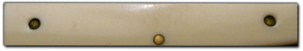

A6 = Appaloosa Smooth Bone
Case's Appaloosa Bone Knife HandlesAppaloosa bone is derived from the shin bone of cows. It is smoothed rather than jigged like most bone handled knives that Case produces. Case first used it in 1979.

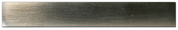

M = Metal
Case's All Metal Pocket Knife HandlesMetal ismostly used on cheaper case lock-back knives. It is usually aluminum and makes for a durable, light weight, corrosion resistant handle.

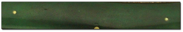

SG6 = Smooth Green Bone
Case's SG6 Smooth Green Handle SlabsThis material is made from the shin bone of cows. It is smoothed and died green.

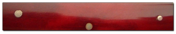

Case's Smooth Rose Bone HandlesThis material is made from the shin bone of cows. It is smoothed and died red.
