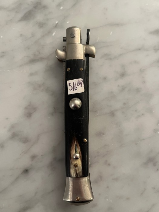

Busted spring and bent back lock. Not sure if it’s worth fixing or not?

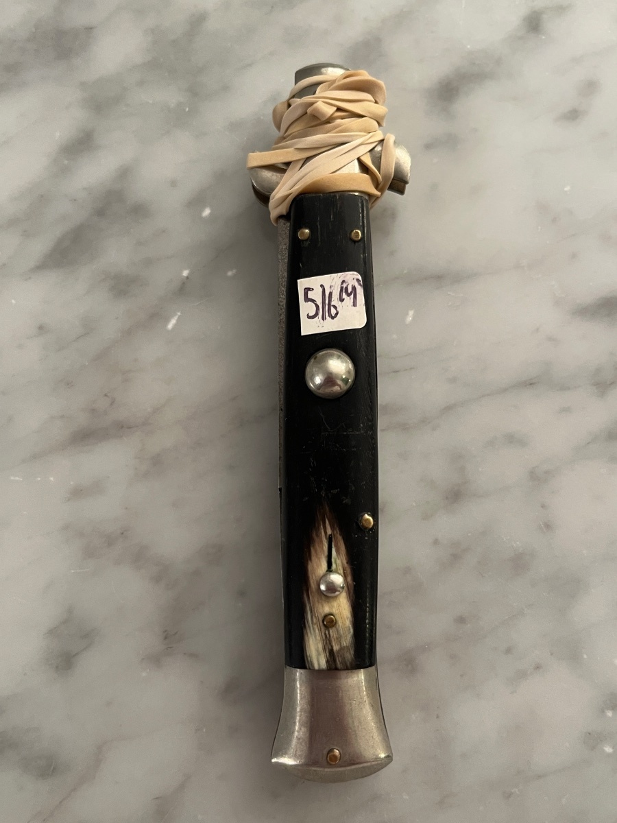

Maybe if you open the knife up to vertical and push the lock over the blade pin, and then put a million rubber bands around it for a month itll fix it

Is there a blade hiding in there? else its an old Italian handle.

Like this?Pile Driver wrote: ↑Fri Nov 21, 2025 11:40 pm Maybe if you open the knife up to vertical and push the lock over the blade pin, and then put a million rubber bands around it for a month itll fix it

Yes like that but try and have the blade standing upright
You have the idea though. I'm pretty handy around knives and repairing them

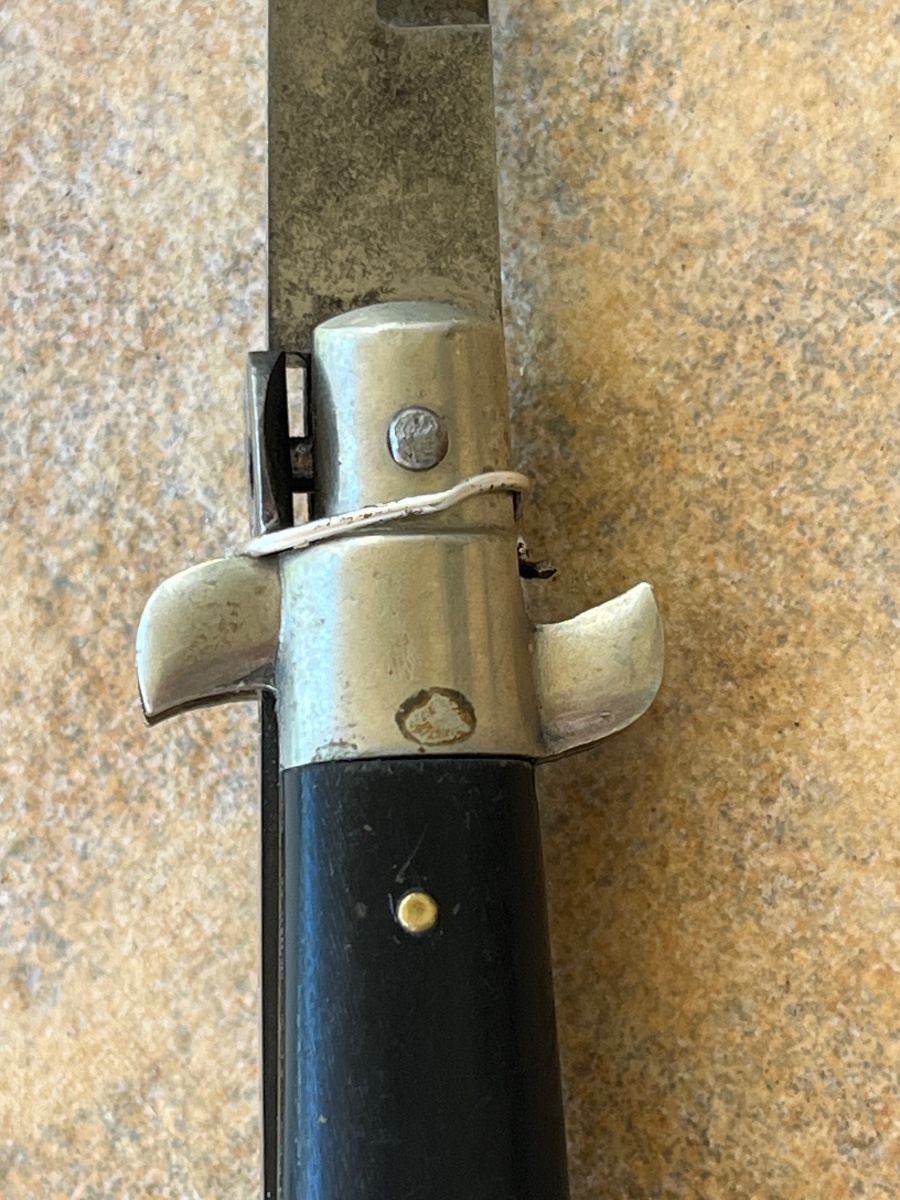

Thanks pal. I think that helped. I had a spark go off just to take some pictures I added a little wire around it to hold it in place. Now what to do next?Pile Driver wrote: ↑Fri Nov 21, 2025 11:40 pm Maybe if you open the knife up to vertical and push the lock over the blade pin, and then put a million rubber bands around it for a month itll fix it

How’s this? I added the wire just for the pictures to hold it straight.Folgore1 wrote: ↑Sat Nov 22, 2025 1:23 am rubber bands are not going to workthe knife will have to be dis-assembled so you can bend backspring to original shape, you only need to remove 1 pin (bottom bolster) then you can swing back spring around so you can bend it back to shape. kick spring will be the hardest , you will have to cut one shape it then spring temper it then hope it works without breaking after 1000 times opening and closing . the knife will be great once restored to original function.

Do you think it’s busted?Bill DeShivs wrote: ↑Sat Nov 22, 2025 4:36 am It's very possible the backspring is broken at the backspring pin. Some are ground very thin on the inside, and breaks are hard to see.

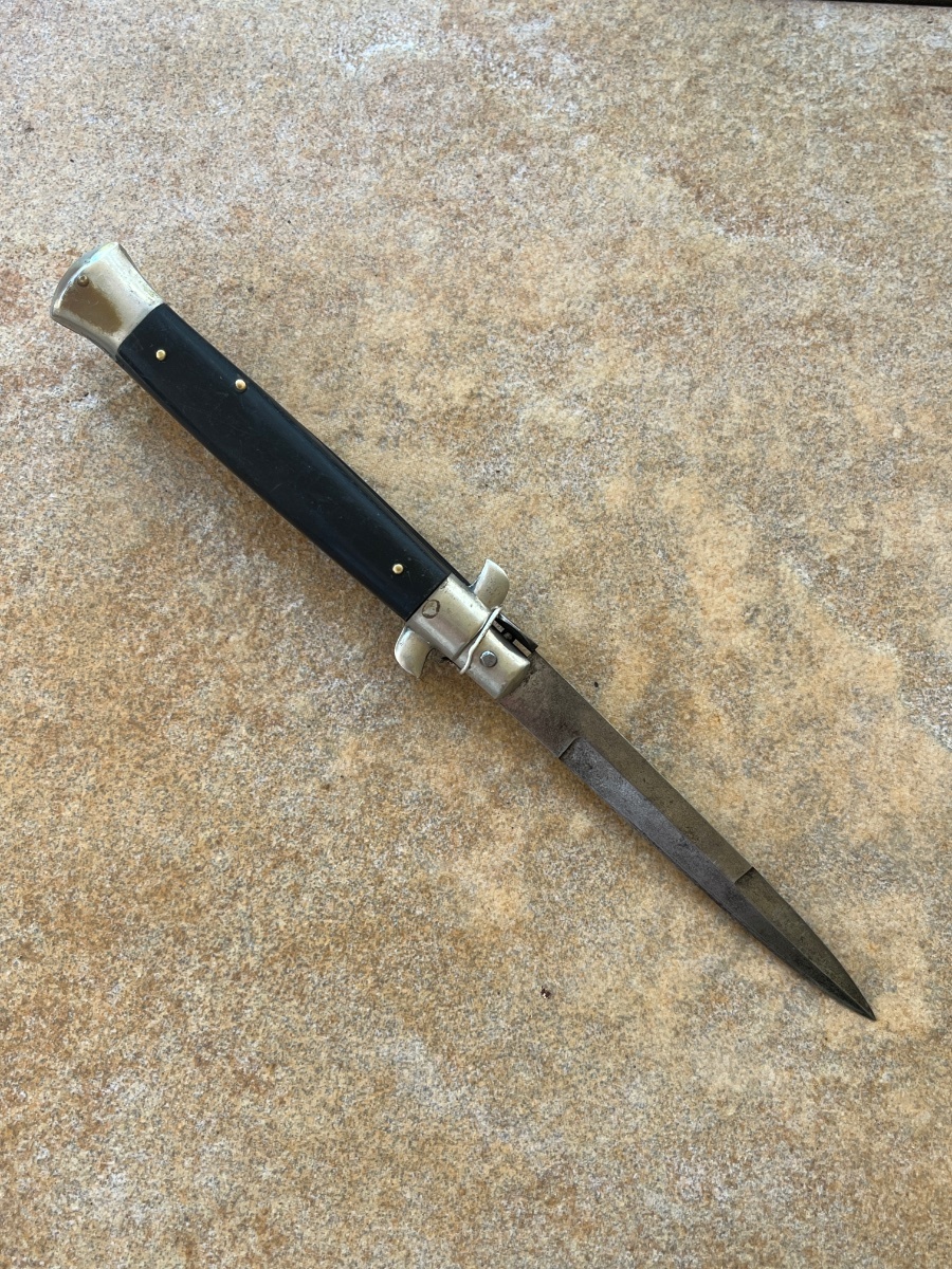

Is there a stamp mark on the blade ?
Some people collect certain tang stamps on Italian stiletto knives, that alone can weigh up if it’s worth fixing.
