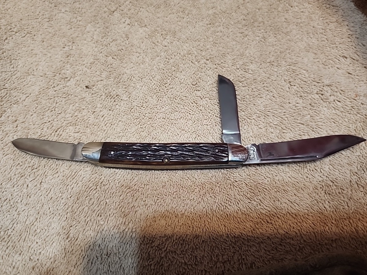

Hope no one here is bidding on this one. https://www.ebay.com/itm/297257030532
“ Vintage CASE TESTED XX 1920-1940 3 Blade Pocket Knife”

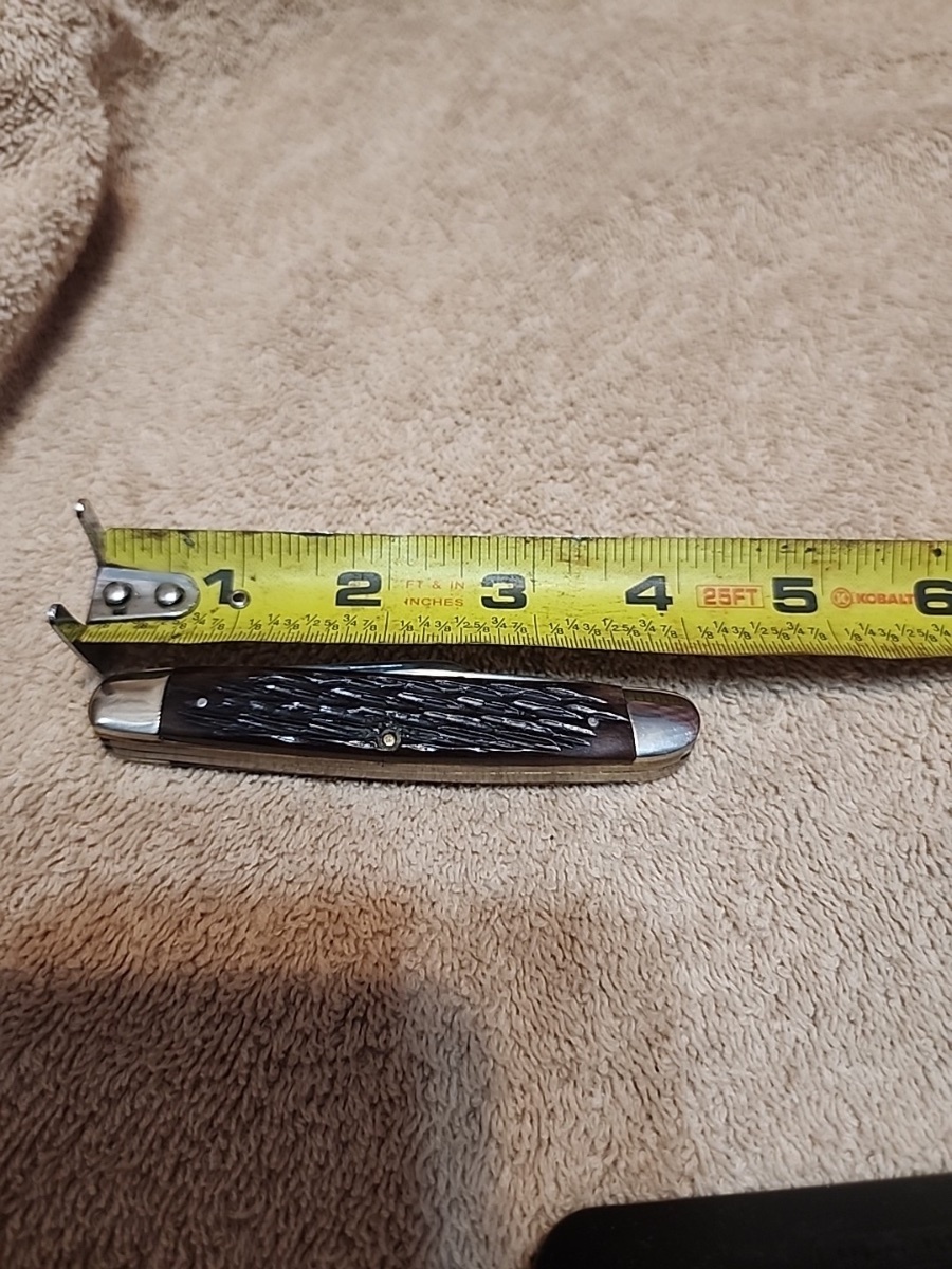

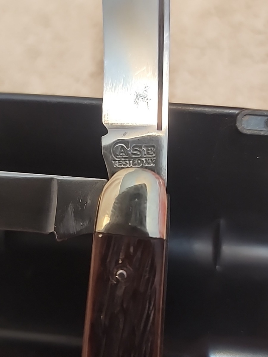

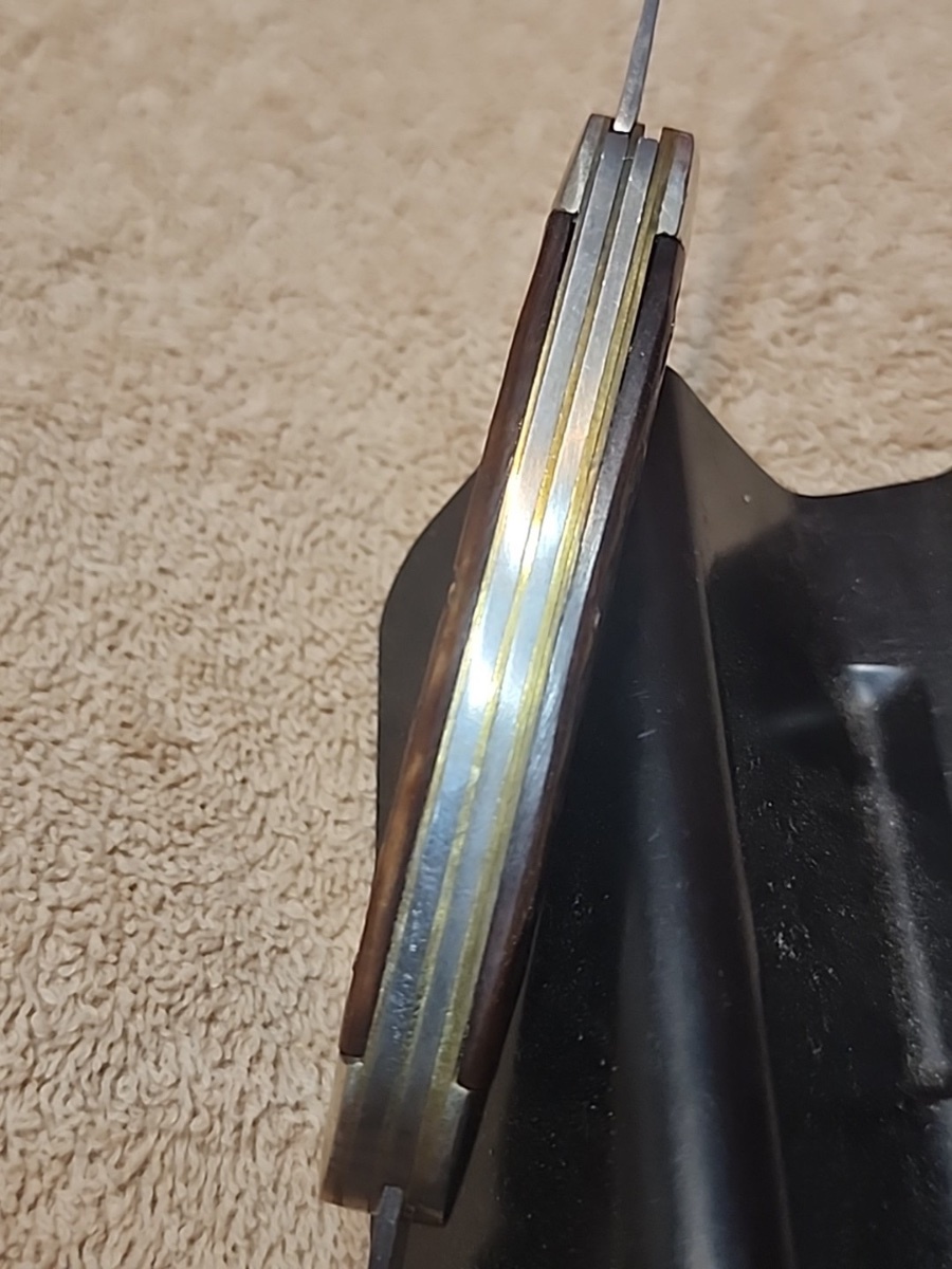

Classic example of a shaved tang and cold stamp. Note the corners and ends of letters are not square. Not a valid Case stockman pattern at that length (but hard to tell exact measurement from pictures of a knife laid next to a ruler). The knife has brass liners - Case stockmans of that era should have nickel silver liners.
Terrible fake

Pictures 7, 8 & 9 tell the true story of this knife.
Camillus jigged and frame? Cold stamped, reground tang, long pull running into the tang . . .
- Posts: 5357
- Joined: Fri Feb 03, 2006 3:41 am
- Location: Central Massachusetts
Re: Terrible fake
It is a rework of a Kutmaster.
