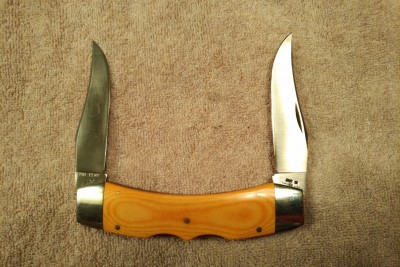

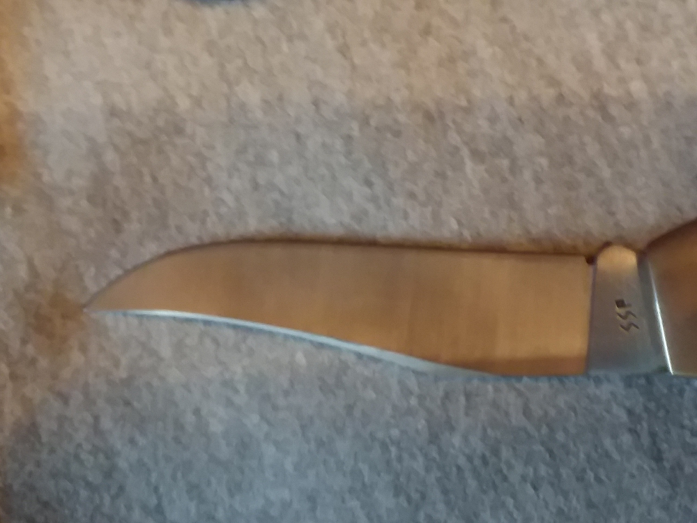

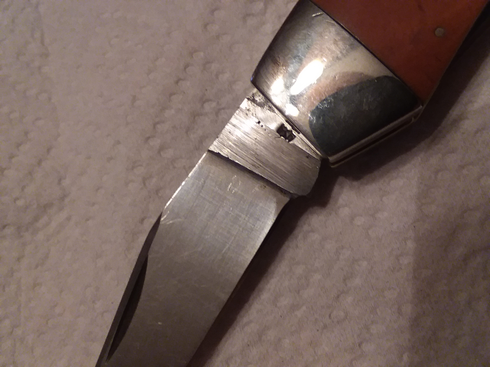

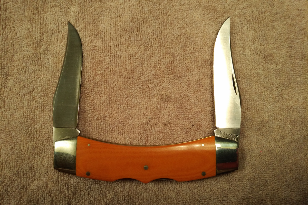

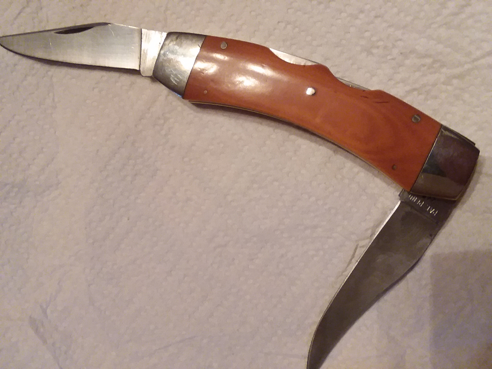

I recently bought a Texas Long Horn on Ebay . I looked at the knife with a magnifying glass and the blades under a 10x loop and does not appear to have been ever used. Strange thing is that the Case tang stamp is 85% missing. 4 dots to the right of the lightning bolt ss and the USA at the very bottom are present only. I find it hard to believe it has worn off.

This guy on Ebay sells what looks to be thousands of knives and didnt mention this in the auction. Im gonna keep it i think and for a hundred bucks im not too bent. I havnt left feed back yet.

Gary, Welcome to AAPK. That knife just doesn’t look correct to me. I have never seen a tang stamp worn off like that. I think someone has done something with this knife.GARRYOWEN83 wrote:I recently bought a Texas Long Horn on Ebay . I looked at the knife with a magnifying glass and the blades under a 10x loop and does not appear to have been ever used. Strange thing is that the Case tang stamp is 85% missing. 4 dots to the right of the lightning bolt ss and the USA at the very bottom are present only. I find it hard to believe it has worn off.

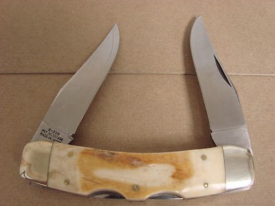

I agree. Blade doesn't look right to me either but may be just the odd angle of your pictures. Here's what it should look like.

Mumbleypeg wrote:I agree. Blade doesn't look right to me either but may be just the odd angle of your pictures. Here's what it should look like.
There you go Ken. That is what I am use to seeing. I think the blades on Gary’s have been replaced.

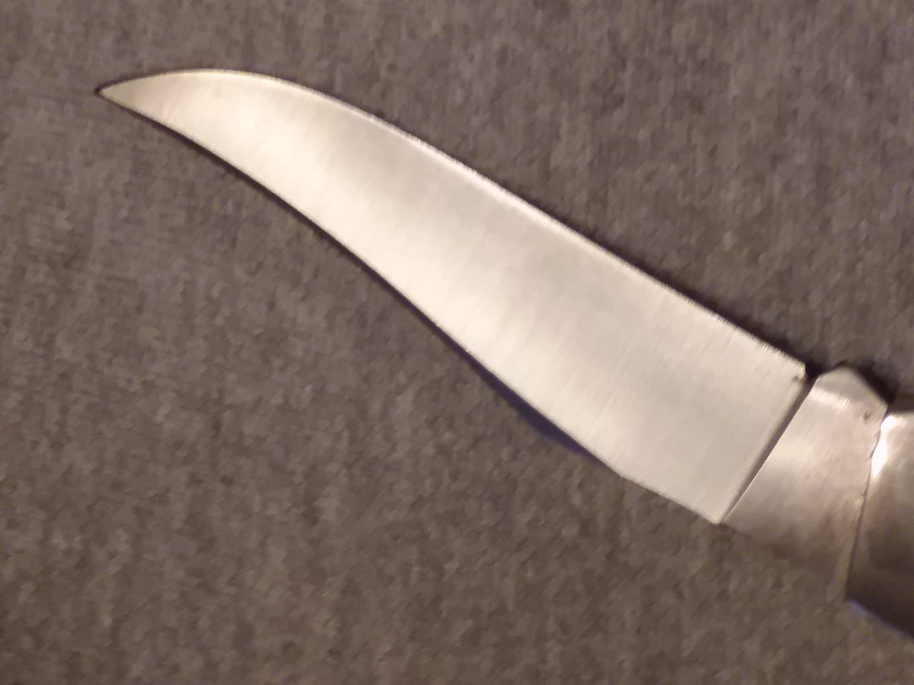

I believe this seller offers returns so if you are unhappy return it for a refund. The blade with the stamp removed does not have the profile of a Lockhorn blade. Case would not have ground the name off during reconditioning.

Ken you might know the answer to this. I had a Parker Texas Lockhorn that I sold a few years ago. It had smaller blades like this one has on the one side. Could that blade have been replaced w/ a blade from a Parker knife? I have deleted my photographs of that knife, otherwise I could compare them myself. That could explain what the seller has done to the tang stamps. Thoughts?Mumbleypeg wrote:Be sure to post some pictures here when you receive it.
Mark

Here is someone else’s picture of the Parker knife from the internet. Compare.

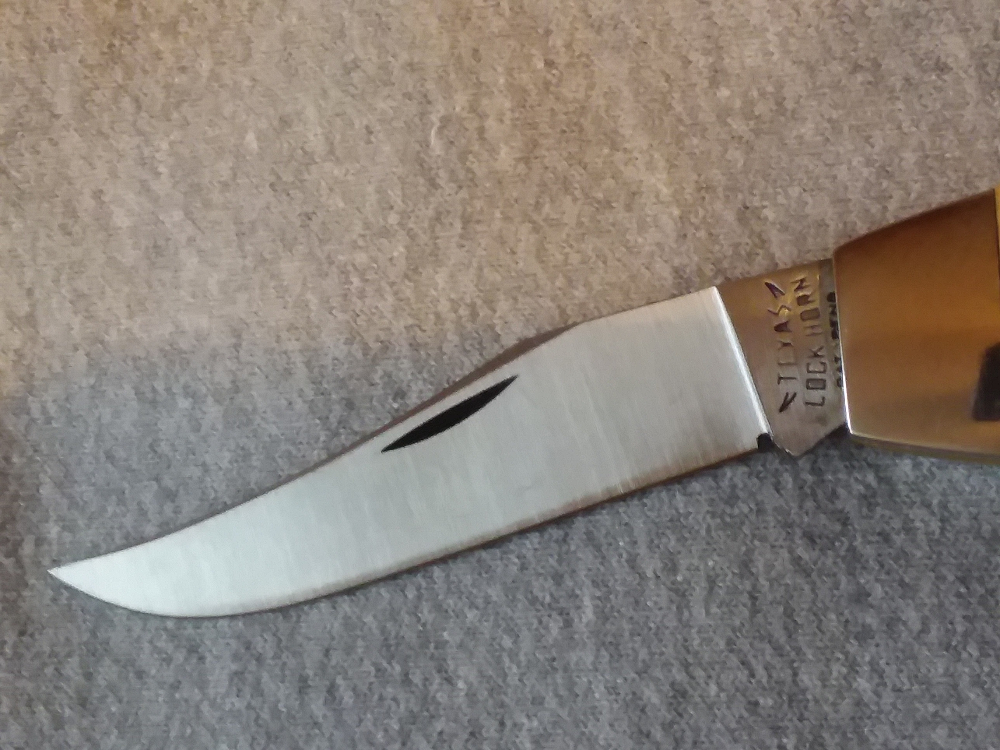

If I’m viewing the pictures correctly the OP knife blade has what appears to be an altered Case 1980’s “lightning S” tang stamp, so my deduction is that it’s a Case blade, either from another pattern or possibly a Lockhorn blade that was re-profiled for some reason. The other blade has the “<TEXAS> LOCKHORN” tang stamp and looks good.Sharpnshinyknives wrote:Ken you might know the answer to this. I had a Parker Texas Lockhorn that I sold a few years ago. It had smaller blades like this one has on the one side. Could that blade have been replaced w/ a blade from a Parker knife? I have deleted my photographs of that knife, otherwise I could compare them myself. That could explain what the seller has done to the tang stamps. Thoughts?Mumbleypeg wrote:Be sure to post some pictures here when you receive it.

It appears to me that the original poster misread what he saw through his 10X loop. The side of that blade is lightly scratched all over. I think it is a used knife and the blades are not as broad as expected because they lost metal while being resharpened. Both blades lost so much metal their choils are completely gone. Choils are notches that separate a cuting edge from the tang to make sharpening easier. Knives that receive more expensive hand work like Case and Queen normally have choils. Less expensively made knives like Buck and Camillus normally do not have choils. Choils are easy to see in the picture Mumbleypeg posted of the Texas Lockhorn he formerly owned.
It appears that a used factory second was sold as a knife with no defects in as new condition. The computer program that is eBay sides with the buyer if the buyer clicks NOT AS ADVERTISED as the reason they are returning an item. The last time I had to do it the wording was changed to put that in the last half of a sentence but it is not hard to pick out the right reason to click on. It makes no difference what the seller wrote their return policy is in the ad. eBay automatically offers the buyer a postage paid return shipping label to print out. I presume eBay charges the cost of that label to the seller's credit card.
I kept a file of the different ways various manufactures defaced their knives to mark them as factory seconds but the antique computer it was on kicked the bucket. If my memory is good grinding off the tang stamp was one of the ways Case did it.peanut740 wrote:The knife is a second.

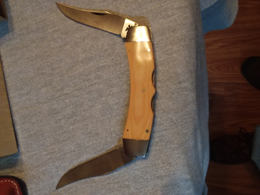

Here is a few pics of the replacement Lockhorn

Re: case tang stamp
I agree - there were a bunch of Case factory seconds showing up on Ebay last year. The partial grind-off of a tang stamp indicates a "second".peanut740 wrote:The knife is a second.
