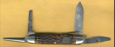

Hello all,
My search for a civilian or boy scout pocket knife (preferably with can opener and lanyard ring) dating to the 1920s or 1930s that I could use for a 1941-1944 US army soldier impression continues. Some have already helped me out in understanding that for soldiers in non-specialized roles (i.e. paratroopers, engineers, signal corps etc.) there was no military issue knife at least until 1944 with the Knife, Pocket, General Purpose (which probably didn't actually reach the lines well into 1945). So a civilian or a boy scout knife coming from home would be more historically accurate.
I am no expert on the subject (and actually very ignorant) so I please bear with me. I appreciate if you could give me some guidance in telling if a knife is pre-WWII manufacture or post-war.
I've found this anonymous-looking Ulster knife that fits my budget and needs for sale. Can anybody tell me if it looks like pre-WWII manufacture or if it's a postwar knife?

IMHO, and it could be wrong. Look for funky can openers. The hook shaped can opener on the knife you show I think first appeared in ww2. Then everyone (except SAK) used it going forward. The older scout knives had various other types. Usually 2 piece can openers.
Also the ww2 knives that had the hook can opener would have had a longer bottle opener/ screw driver.
The one you show looks like 1970’s and up to me.

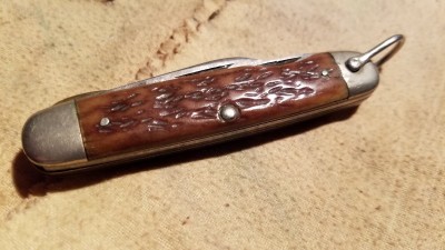

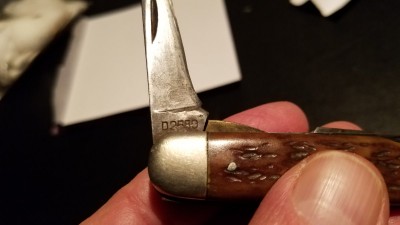

Both Ulster Model 1502s I had my eyes on are gone.
I very much like to get one of those, but since the Army issued P-38 can openers ad nauseam,having a knife with a can opener is not a conditio-sine-qua-non for me. So I was looking at other models that would also be historically accurate for the period 1941-1944.
What do y'all think about this?

That is a 1936-1952 era stamp, so it could be authentic ww2 era.

One of my favorite knifes. Tough, useful and beautiful.PvtRossi wrote:Both Ulster Model 1502s I had my eyes on are gone.
Does it have steel liners?

The Imperial EO is an excellent choice - very popular knife at the time and many were made. I have that knife in both bone and black synthetic - both still walk and talk beautifully and take a keen edge. OH

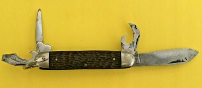

What do y'all think about this bad boy? I haven't bought it yet.
- Mumbleypeg
- Posts: 14738
- Location: Republic of Texas
Re: My search for a pre-WWII civilian/boy scout knife
That looks like a nice one. Missing its bail though if that means anything to you.

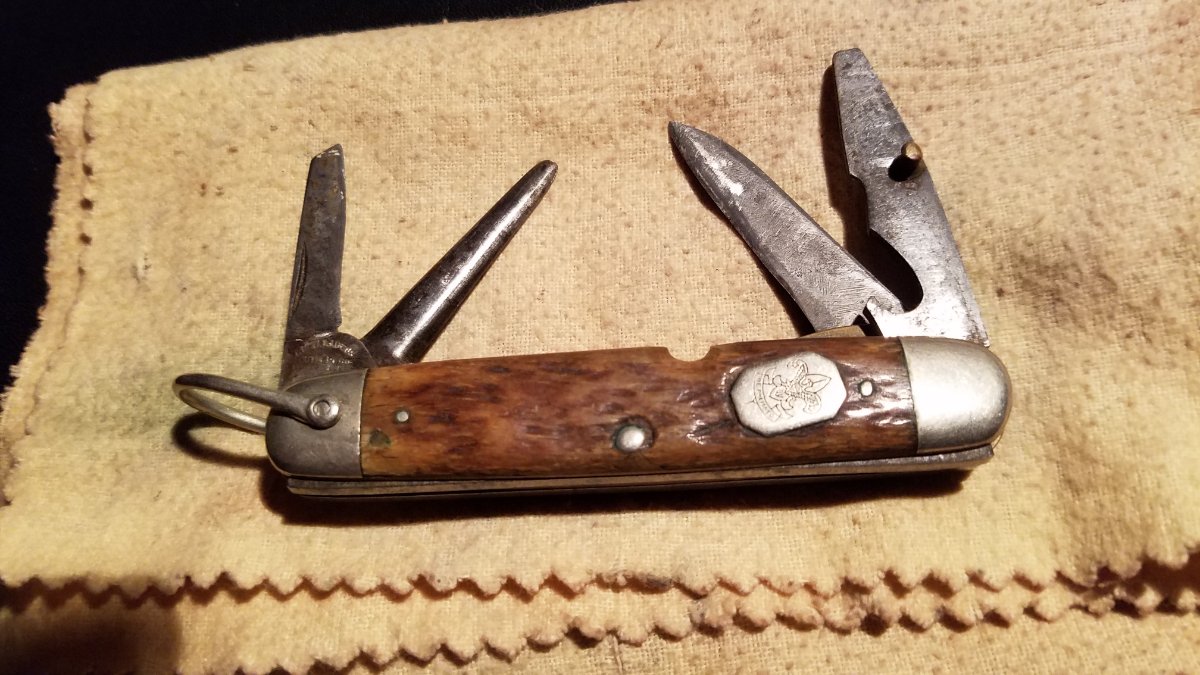

Just got to see this post. Here is my Dad's knife. He carried it every day and used it plenty. I remember him having it in the 50's and 60's. I don't know how long he owned it before then, but it could have easily been in the 1940's. The camera focused on the bolster not the tang, but I think it is Cattargus Cutlery Little Valley. I am interested if any has info.
- Posts: 5375
- Joined: Fri Feb 03, 2006 3:41 am
- Location: Central Massachusetts
Treejakal wrote: ↑Mon Dec 02, 2019 10:24 pm Just got to see this post. Here is my Dad's knife. He carried it every day and used it plenty. I remember him having it in the 50's and 60's. I don't know how long he owned it before then, but it could have easily been in the 1940's. The camera focused on the bolster not the tang, but I think it is Cattargus Cutlery Little Valley. I am interested if any has info.
Great knife with a great story!!
Yes it is a Cattaraugus Whittl Kraft knife. It was made in both BSA and non-BSA versions. In fact IIRC they made some for LL Bean.
The blades are all designed for whittling. The blade that appears to be a punch is sort of a chisel blade. The bottle opener has a semi-sharpened edge at the screwdriver for rough shaping.
Catt sold the knives individually and also as part of a whittling kit that included a booklet, wood blocks, and a cloth bag.

The BSA versions of the Cattaraugus whittling knives were made between 1932 and 1943 (all were pre-war). There is one story where the design of the knife was based on the results of asking boys at a National Jamboree for the features they desired in a pocket knife. There is also a story that the knife was designed when the BSA began the whittling merit badge in 1927. I have no facts to backup either story but both could be possible. They also made a 4-blade version without a bail and 3-blade versions that were the same length closed as the 4-blade versions but without the screwdriver/cap lifter blade. And given the provenance of yours, the value is priceless.
Hope this helps along with what others have added. Tom

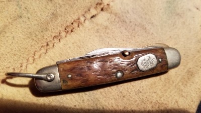

Found an pic of one without the bail in good condition
