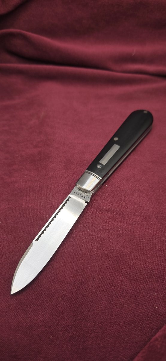

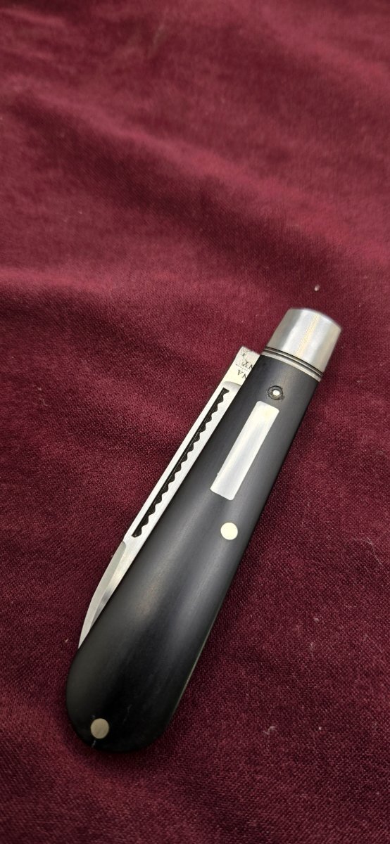

Regular Jack knife 3.57" Closed, 14C28N stainless steel, black paper micarta, milled liners

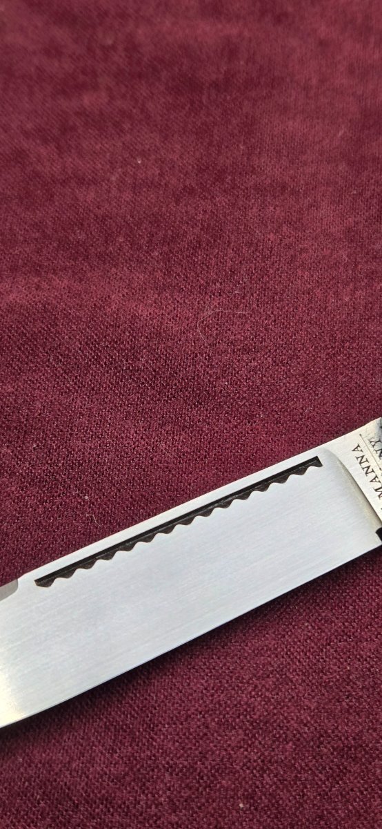

Nail nick is inspired from a scan of a Maher and Grosh knife that I vectorized and brought in to the laser software

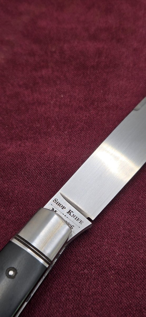

This one ended up just for practice because of an issue with the grinding. I've marked it as a shop knife.

This paper micarta split at the bottom hole. I need to stick with tougher materials like basic canvas micarta, maybe Richlite for now.

Do you mind if I ask how the match strike pull is done? Must be a jig in a press?

Hi. This nick is done using a fiber laser. I have a 60W fiber laser.
I either draw them in cad or I find a picture.of a vintage one. The picture needs to be converted to an SVG (scalable vector format) outline.
I use laser software called Lightburn. Lightburn has a type of image burn called 3d slice. I use this to create a ramped profile which is essential in a basic crescent nail nick. It simulates the profile of one cut by machine or stamped.
I use that approach but use the outline of the nail nick I scanned.
I'll look for the original Maher and Grosh knife that this one originated from so you can compare.
Ive successfully followed the same method on a more jagged looking Remington matchstrike
