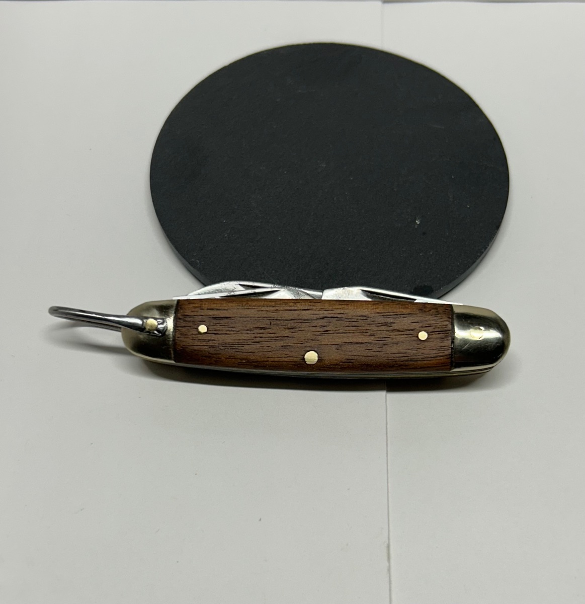

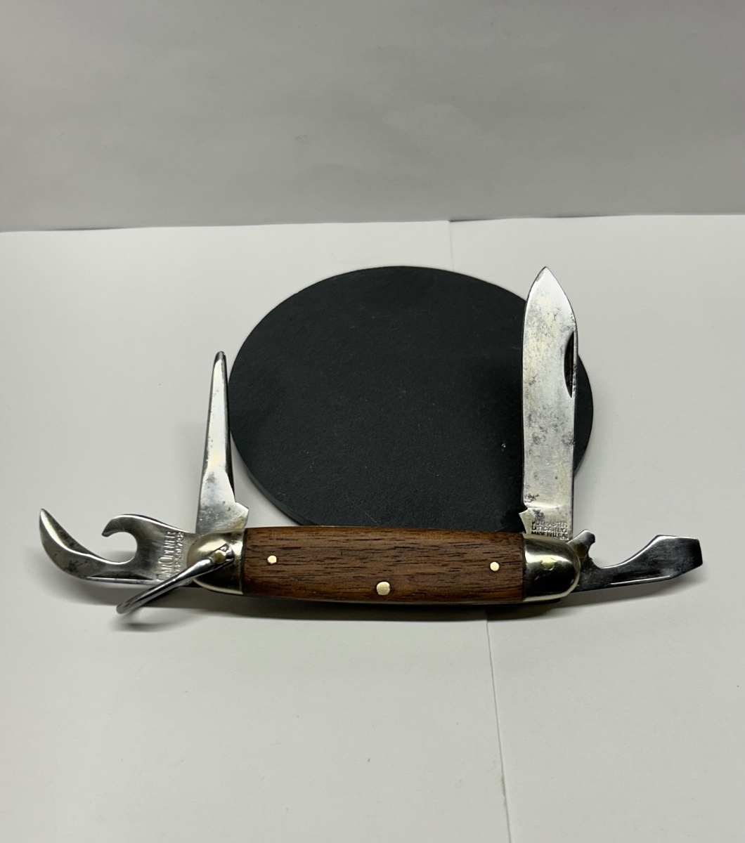

Unfortunately I don’t have any before pictures but the knife was crusty and rusty. It was the first time ever I used PB Blast on a knife. Well I learned the hard way not to do that. It ended up melting the plastic scales. I never knew it does that. So I disassembled everything and cleaned it up with a fiber wheel and Dremal wire wheel. I used black walnut for the scales. I don’t have nickel pins so I used brass. Yes it’s visible in the bolsters but I don’t think it looks bad.

That's a tough lesson. But she looks great.
Too bad you couldn't fit a Girl Scout shield.

That is some very nice looking black walnut!

Thank you. I honestly didn’t even think about putting the shield on it.1967redrider wrote: ↑Sat Nov 15, 2025 12:49 am That's a tough lesson. But she looks great.Too bad you couldn't fit a Girl Scout shield.

Thank you. I’ve replaced scales on multiple knives with different types of wood and my favorite is probably black walnut. I was fortunate to get my hands on a decent amount of it so it ends being my go to scale material.

Nice clean-up (and save) on that one. The brass pins look fine, adds some class to the knife!
