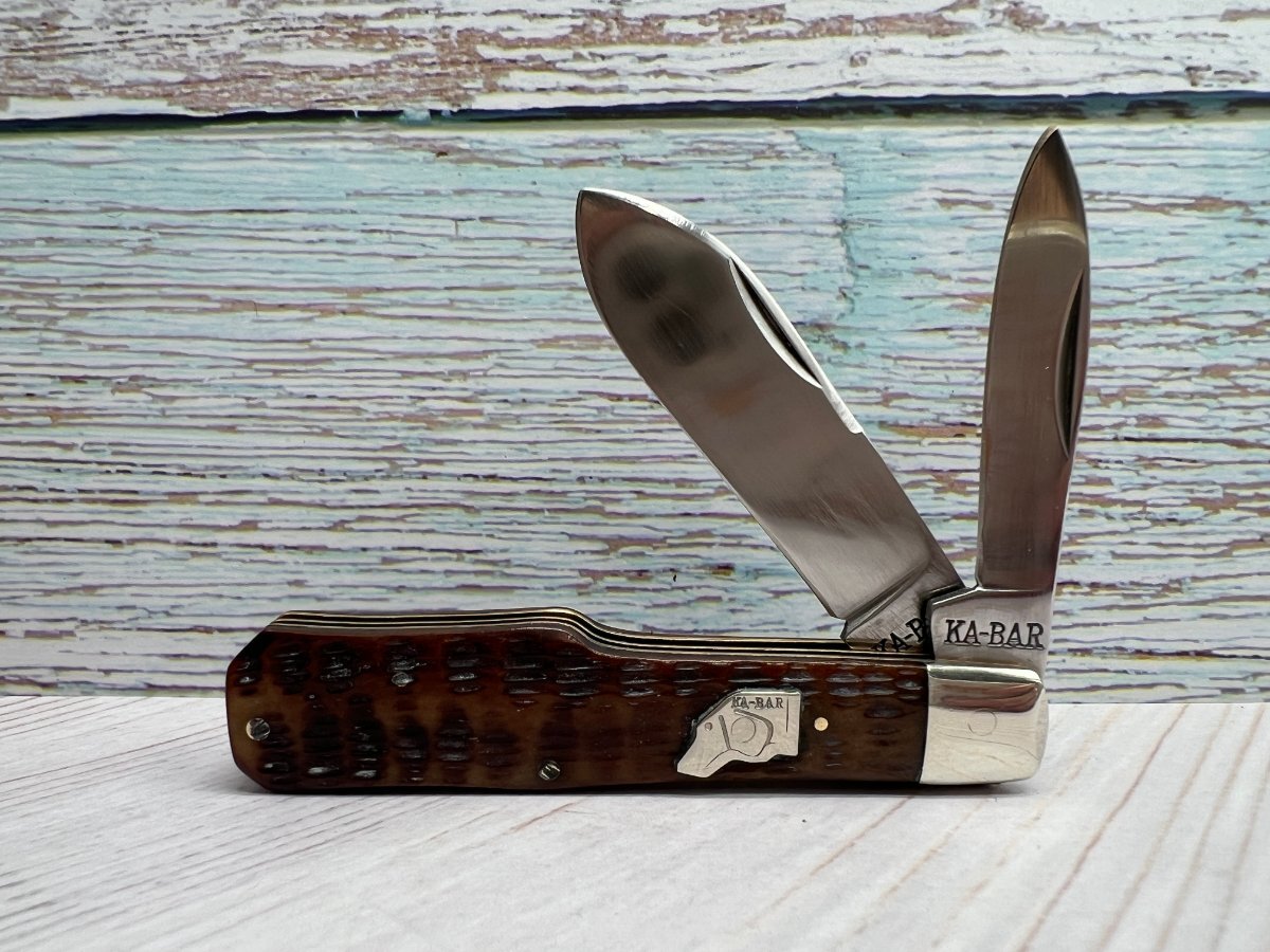

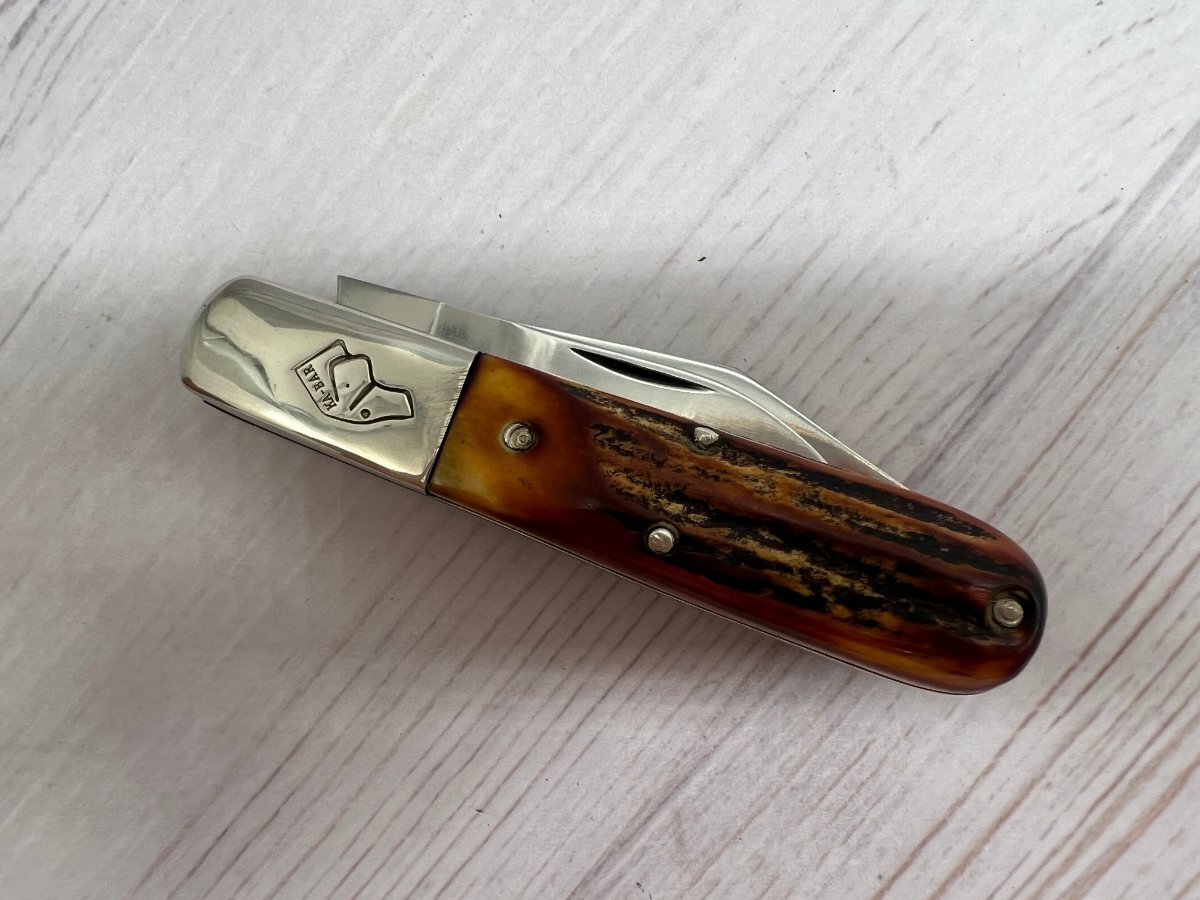

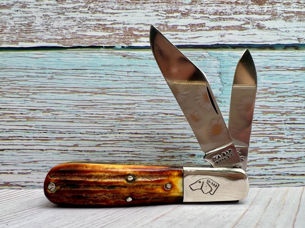

I've got some Ka-bar knives im having a bit of trouble finding out in the internet ether. Looking for some insight, I have my thoughts but I want to get other opinions on them first. Thanks in advance knife friends.

Don't think it's an original, authentic Doghead. Sorry. Others will probably agree. J.O'.

No worries, i was leaning in your direction, was just looking for some other sets of eyes. Its a bit of a giveaway when I can't find the same model, on something that doesnt look 50+ years old, and the Ka-bar gunstocks dont really have that shape, but Ka-bar has been such a mess its hard to believe anyone would want to make fakes, but they're out there

I have seen some dog heads with the nose pointed down, but forget what the general consensus was?

The green bone jack is a complete fake. The stag barlow is a club knife or limited edition, 1980's to 90's.

The gunstock like Steve says is a modern fake. The barlow may be a limited edition sold by KA-BAR but it certainly wasn't made by them.

What's fake about the first one, just the dog head or is there more? I ask for a curious friend (me)

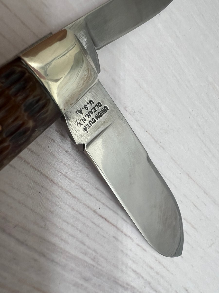

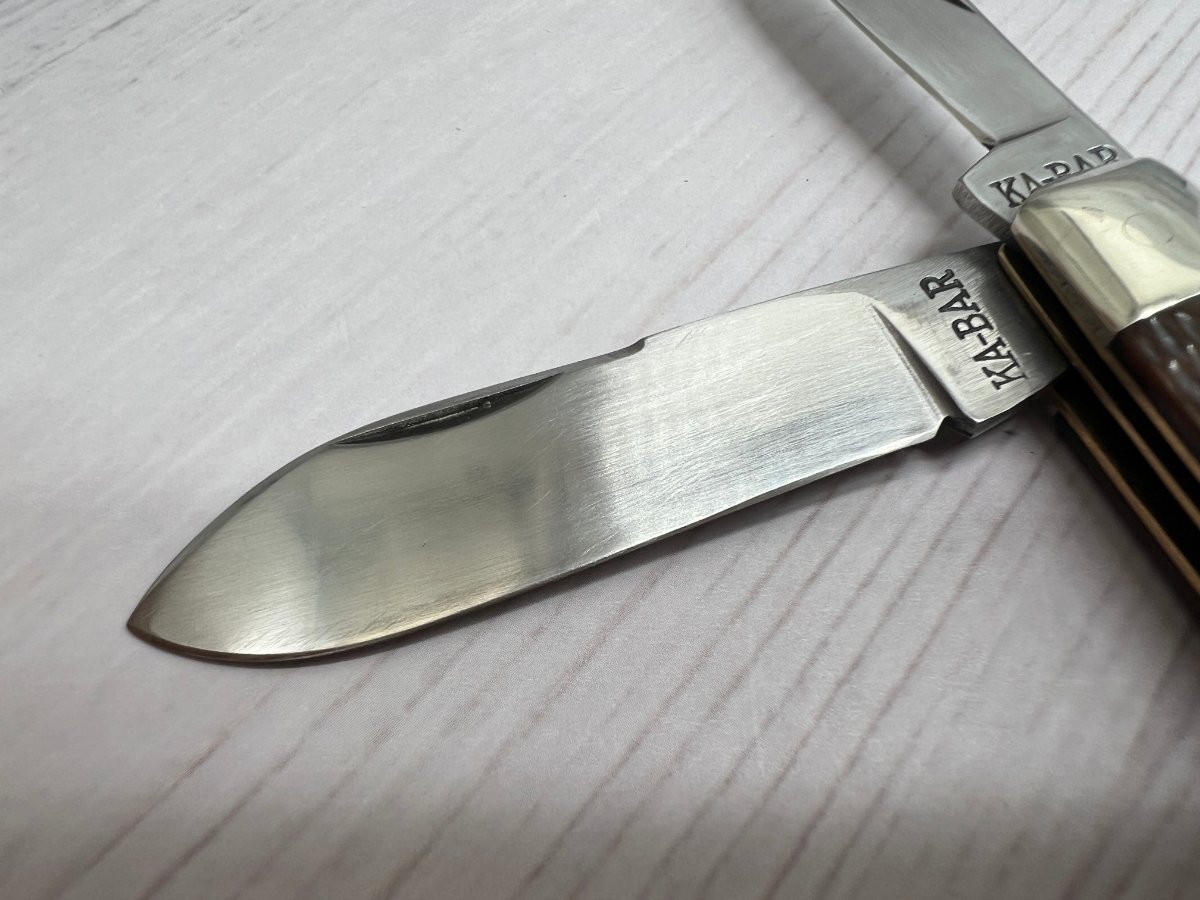

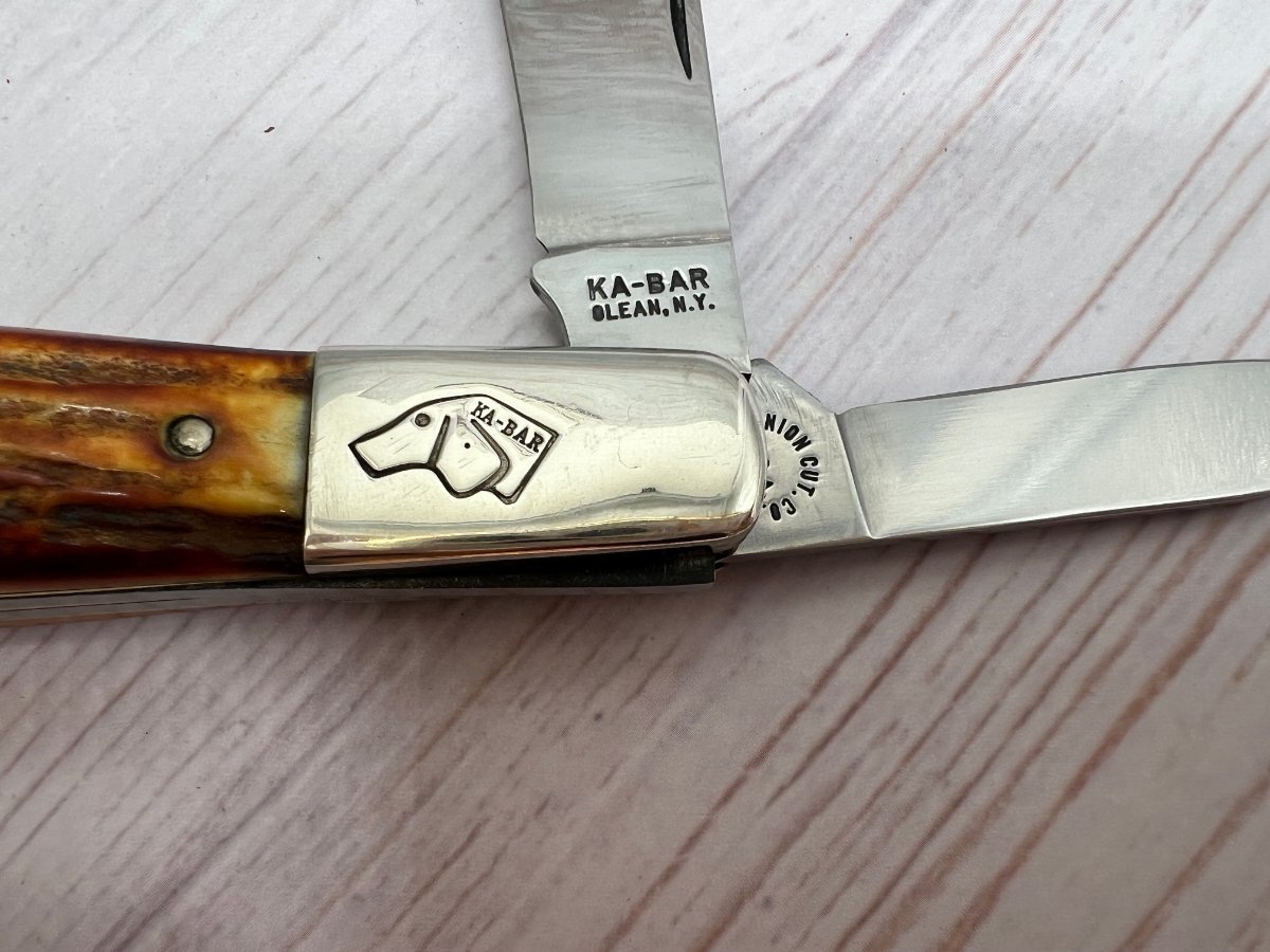

First thing to learn about KA-BAR dog head knives is that the originals - made in the KA-BAR/Union Cut era, pre-1940 - were all large patterns. All 4-1/2" and over - folding hunters like the Case 65 and 050 patterns, the large "banana" lockback and the similar hobo pattern, and the jumbo trapper like the Remington R1123.SwedgeHead wrote: ↑Tue Jul 29, 2025 8:33 pm What's fake about the first one, just the dog head or is there more? I ask for a curious friend (me)
There were no small patterns made back then with the dog head shield. So if you see a trapper, jack, barlow, stockman, or penknife with the dog head, it is either a modern fake or it is an authorized repro or club knife. Queen made most of these, but Camillus made some.
Regarding the OP knife specifically, in addition to what I just wrote about the patterns, the stamps and blade grinds look like modern faked blades, the dog head shield is wrong.

I believe Canal Street has made some recent dog heads for KA-BAR.
