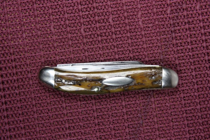

I had picked up this Cattaraugus 32029 Sowbelly at a flea market a couple of months ago. After mulling the options I decided to do a rebuild, but try to keep the original bone handles even though they had cracks and pieces missing. The master blade was broken and the spay had been replaced with a different blade that didn't belong to the knife prior to my ownership. An AAPK member Ridgegrass suppied a catalog picture of the original knife and blades (thanks Ridgegrass that was very helpful), see pic here viewtopic.php?t=84921 as well as pic of the original knife, 2 new blades were made from 1095 bar stock. The bone handles were patched with Acra Glas, and everything reassembled. My first Sowbelly now as an EDC. Below is a short section on the process used to cut the pulls on the newly made blades, viewtopic.php?t=85048This process of using the Dremel cut off wheel has evolved over the last few years.

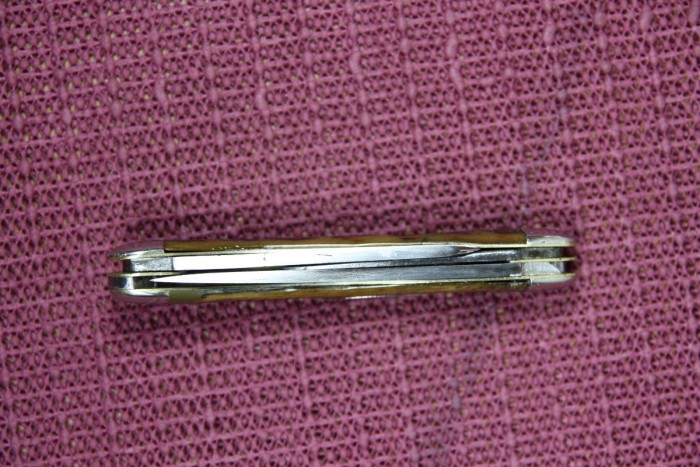

The blade well is pretty much packed on this one. The spay had to be carefully crinked to get everything back in.

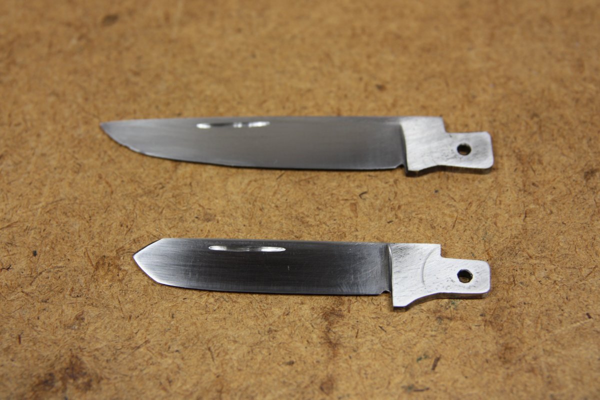

The 2 newly made blades
