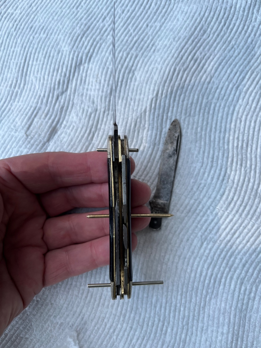

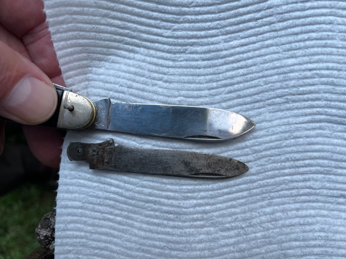

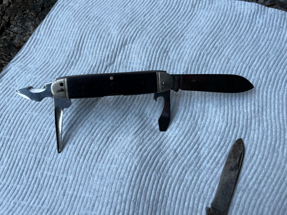

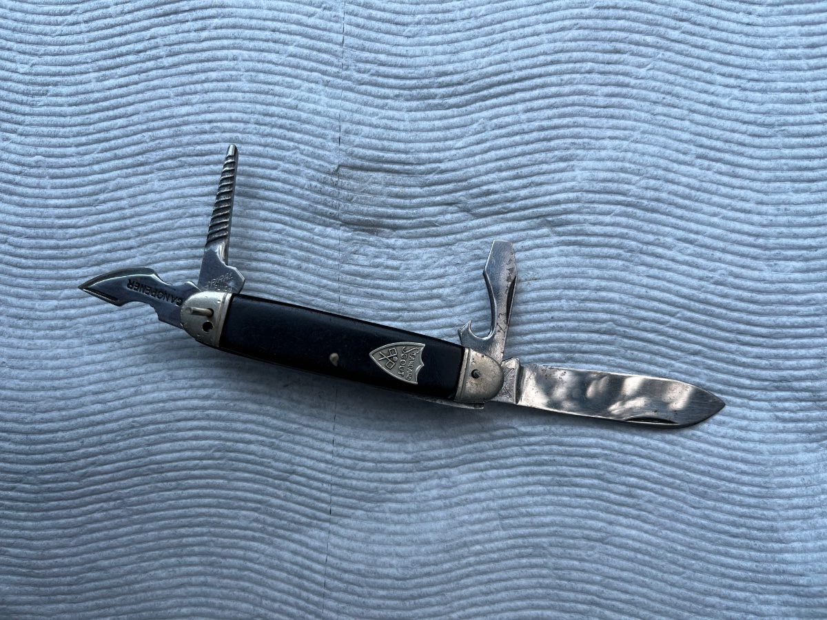

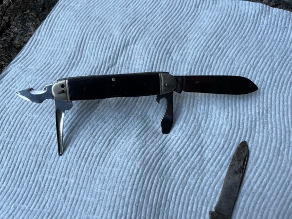

Hello,
I am looking for tips from more experienced restorers. I have an old Camillus scout with bolsters and removable bail that I decided to restore. The scales were in decent shape, but the tools were all rusty and trashed. I got the donor tools, springs, and spacers from an identical knife with ruined shrinky-dink scales. I don't think the donor knife was ever used or carried -- the blade and implements are that nice looking.
I have the knife re-assembled, but I need to finish off the pins. I've built a few alox SAKs, where the pin finishing is visible and there are no bolsters to worry about, but I've never done this to a bolstered knife. A few questions for a more experienced builder:
How close to the surface of the bolster should I trim the end pins? My gut tells me to trim them very close, but I don't want to trim them too close and not have enough material to expand in the hole.
I am used to using a 6 oz ball peen hammer for peening a SAK back together. Is there a better tool to use for this bolstered Camillus?
Other than just going by feel and tool snap, is there a way to judge when the pins are just right?
If you have any other tips, I'm all ears! In the meantime, here are some pictures. The old blade can be seen in the background.
Thanks,
Myron
Thanks,
Myron

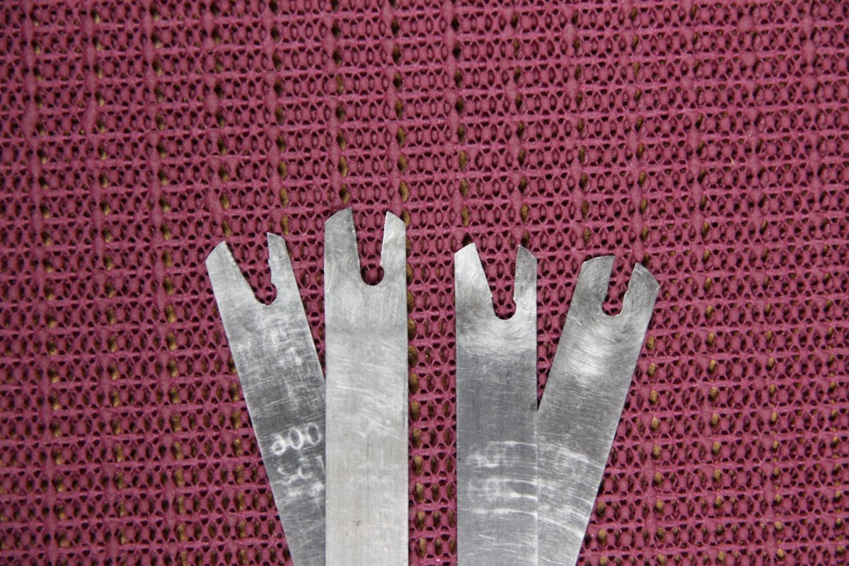

After you get your feeler gauges, to make them into slackers cut or notch the ends to fit around the pins.
