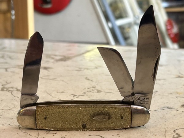

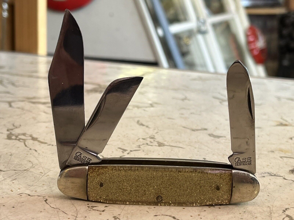

Here’s an interesting listing for a fake Case Tested cattle knife. https://www.ebay.com/itm/115915149018?h ... R5bn2Z3SYg Seller’s listing says it’s from an estate sale in Kentucky. This is what happens when a collector buys a fake, passes on with it in their collection, and the heirs sell it. I suspect the only person in the chain of events who knows it’s a fake is the guy that made it to begin with. Now some other unsuspecting collector will buy it, and the whole mess starts all over again!
From the shape of the blades this one probably was a Kutmaster. (Note the curved spine on the spey blade). The tangs were shaved and re-stamped, a Case shield (too small for the pattern) was attached, and off it went. Another “Kentucky wonder”! Wish I had a dollar for all the fake Case knives in Kentucky and Tennessee. ::nod::

Typical to see these fakes with all blades stamped. To the unsuspecting buyer this reinforces the fallacy that it is a Case knife. ::shrug:: The new German made goldstone celluloid handles look to be outgassing which is the norm for this material.
Many of the similar fakes sold on eBay have been purchased "from estates" which I always take to be the sellers' instant disclaimer of authenticity.

I agree. When I saw it I had the thought that the one thing that could save a future collector from being burnt on it was if the outgassing celluloid destroyed it. :lol:

Mumbleypeg wrote: Thu Sep 14, 2023 4:23 am Here’s an interesting listing for a fake Case Tested cattle knife. https://www.ebay.com/itm/115915149018?h ... R5bn2Z3SYg Seller’s listing says it’s from an estate sale in Kentucky. This is what happens when a collector buys a fake, passes on with it in their collection, and the heirs sell it. I suspect the only person in the chain of events who knows it’s a fake is the guy that made it to begin with. Now some other unsuspecting collector will buy it, and the whole mess starts all over again!
I notice that the "C" curves around and touches the top of the "A" as is typical of most all these KY....TNN modifications.

Knife appears to have started out as a Utica Kutmaster. The humped spey blade is usually the giveaway. Case's speys have a straight spine.

couple of questions
1) what is the "spey blade"?
2) if they are using other brands of knives and putting the Case logo info on the blades - are they grinding off the other names or "China" and just how do they get a stamping on the blades - I guess I figured at the factory they logo work was done before the blade was assembled and most likely with quite the machine. Wouldn't they have to take the knife apart to get the logo to fit? That'd seem like more work than what it's worth to me. ::shrug::
Oh, and also on this one - there is the same logo on all three blades - don't they just stamp one blade?

1. The spey blade has a curved shape near the end of the cutting edge, designed to slice without puncturing (it has no sharp pointed end). Typically found as one of the blades on stockman and cattle knife patterns, they were designed for “neutering” and other veterinary tasks on farm animals. Some makers etched the words “For flesh only” on spey blades. You will find similar shaped (but longer) blades on trapper patterns, designed for skinning animals. Again, slice but not puncture. See here for examples of knife blades, found here in AAPK Research https://www.allaboutpocketknives.com/ca ... ed-by-case
2. Counterfeiters usually take the knife apart, to make it easier to grind off the old stamps and apply the new (fake) stamps. The process of grinding off the old stamp and buffing the tang is called “shaving” the tang. The original stamps were applied by the manufacturer before the blades are tempered/hardened. Counterfeiters use what is called a “cold stamp”, which means it was applied after hardening. There are subtle differences usually detected by a trained eye, either in the stamp itself, or the metal missing from the tang. After making the alterations they re-assemble the knife. Sometimes you can tell the knife has been apart. Sometimes close examination will reveal the blade’s tang is now narrower than its backspring - a sign the tang was “shaved”.
Depending on the manufacturer, older knives were sometimes stamped on all blades at the factory. Some counterfeiters try to fool the buyer by imitating this (or they’re so enamored if their fake stamps, they get stamp-happy). ::hmm:: Knowing what stamps are authentic and when they were used is part of being able to detect fakes.
Counterfeiters often take a $20-$50 knife and try to make it look like a $200+ knife. Sometimes they get a knife someone re-handled simply to repair it, or just to put something different on it. The seller will misrepresent it as something it’s not. They seldom fake a newer knife, but may try to turn a newer one into an older knife, more valuable to a collector. It’s all about the money. If you’re not sure what you’re buying, don’t!!
