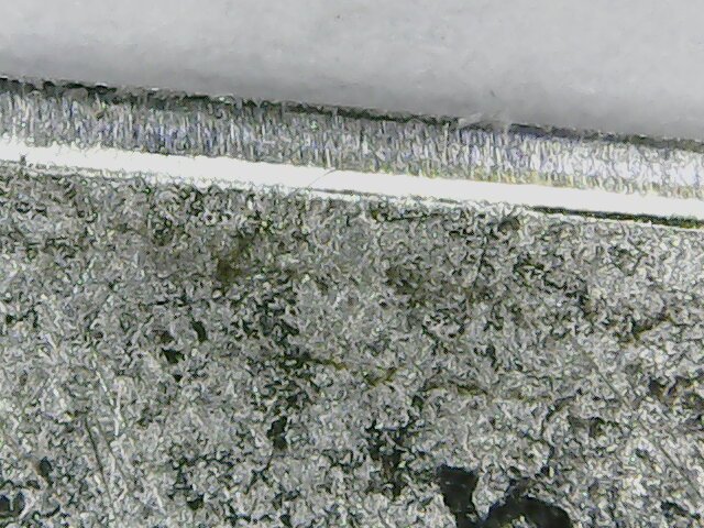

So with these stones, I did a free hand sharpening at 12 degrees as best I could. This was very close to the existing angle on the blade.
First up, I decided to use the KME “Super-Tuff” Ceramic Stones. These stones are inexpensive (about $20) and they use Aluminum Oxide. The coarse stone is about 120 grit and is very aggressive. It made pretty fast work and left a serviceable edge on this old knife. This first image shows with most of the dip removed. I have seen almost no reviews of these stones. They are very inexpensive, so I gave it a try.

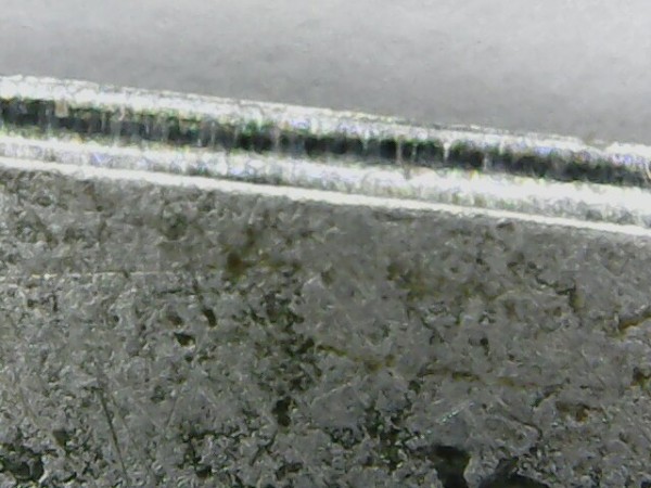

This is the edge after the Coarse stone. KMEAO62C

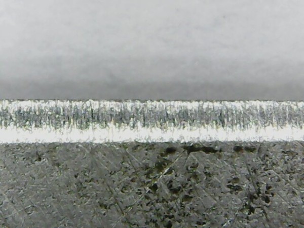

This is the edge after using the medium / fine stone. This did a great job and the knife is able to cut news print, not great, but OK.

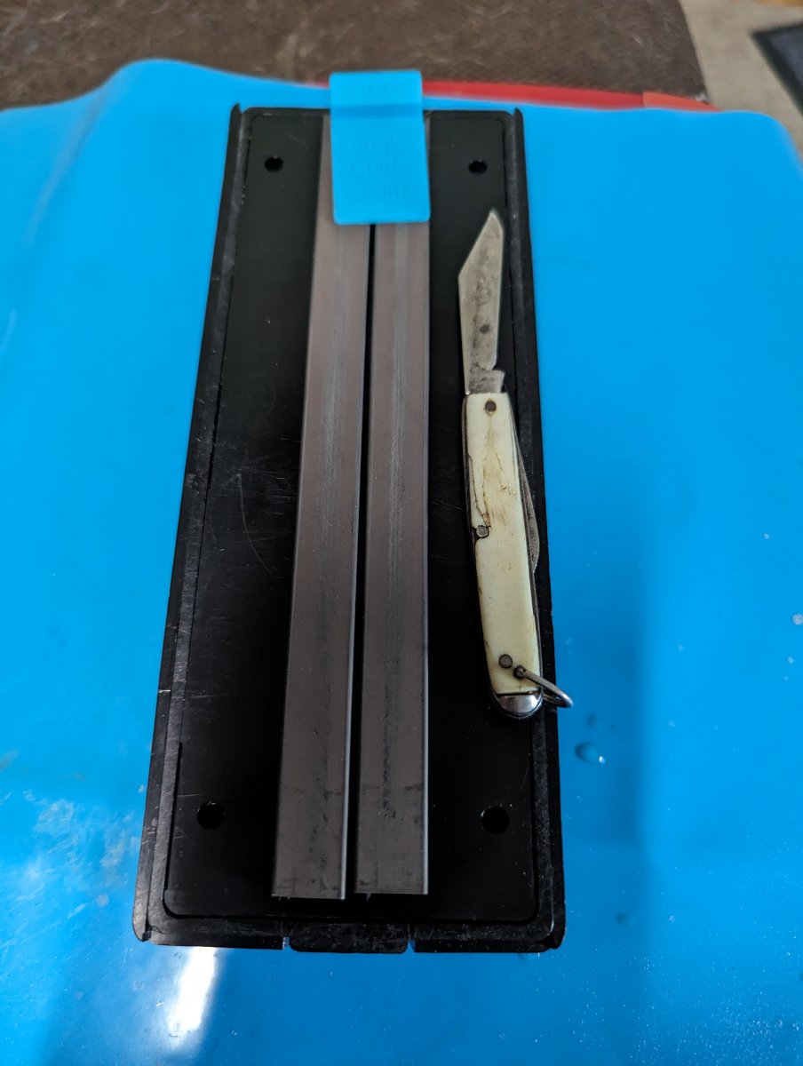

This is a picture of my Sharkmaker with the two medium rods. Note the blue thing, this is a 12 degree angle that I use as a reference. I highly recommend these
https://www.amazon.com/Wedgek-Angle-Gui ... B01N4QMO7U

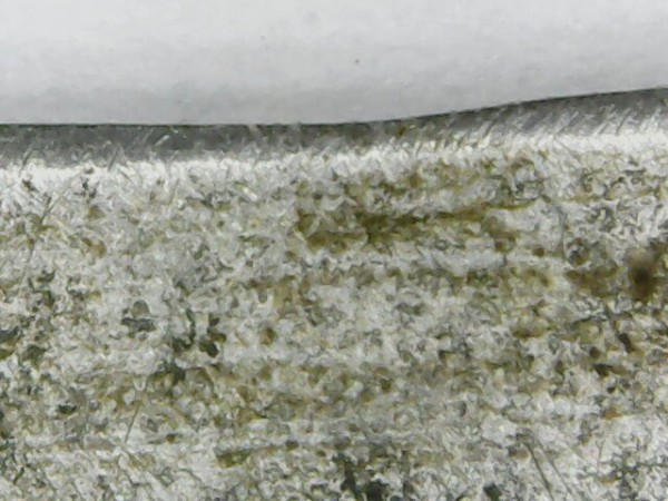

After using the Spyderco Medium stone, the edge is starting to refine nicely. The blade finally feels almost satisfyingly sharp. Note that we are still free hand.

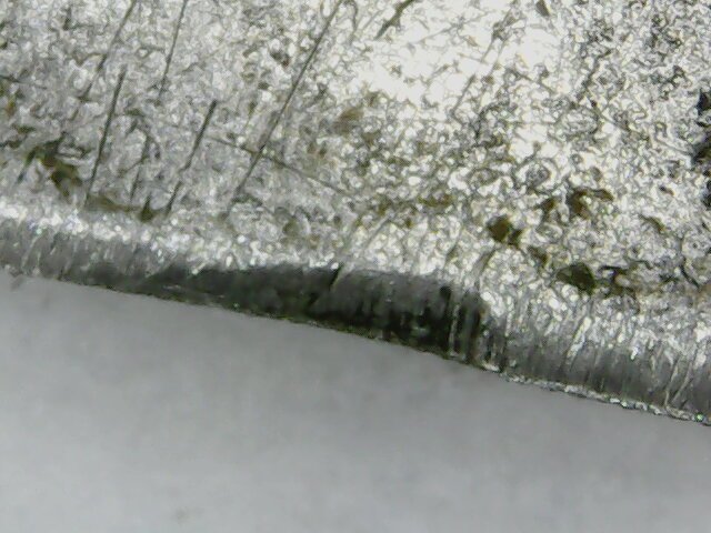

Now the Spyderco Fine stone. This is as far as I usually go with a knife and yes, it is sharp. Again, I do not have a Fine bench stone so I used the Spyderco as my bench stone. Yeah, this is sharp.

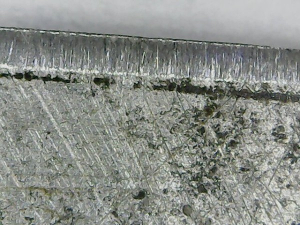

And finally on to the Norton Ascent Ultra Fine stone, which has left a really fine edge on this knife.
