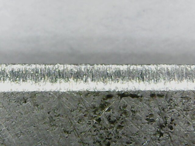

First up, I decided to use the KME “Super-Tuff” Ceramic Stones. These stones are inexpensive (about $20) and they use Aluminum Oxide. The coarse stone is about 120 grit and is very aggressive. It made pretty fast work and left a serviceable edge on this old knife. This first image shows with most of the dip removed. I have seen almost no reviews of these stones. They are very inexpensive, so I gave it a try.
This is the edge after the Coarse stone. KMEAO62C

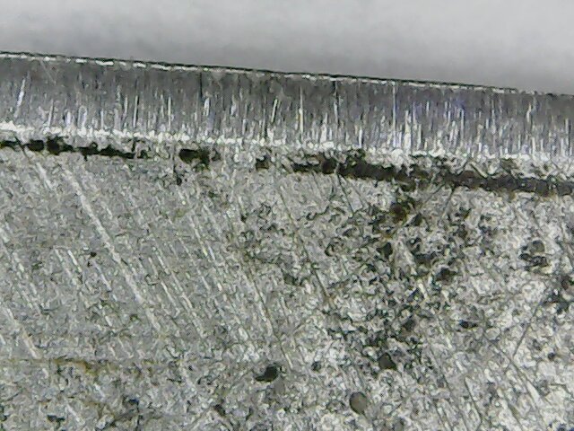

This is the edge after using the medium / fine stone. This did a great job and the knife is able to cut news print, not great, but OK.

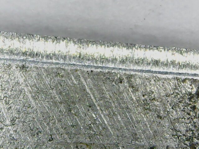

And finally on to the Norton Ascent Ultra Fine stone, which has left a really fine edge on this knife.
