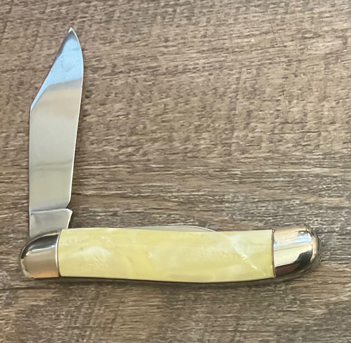

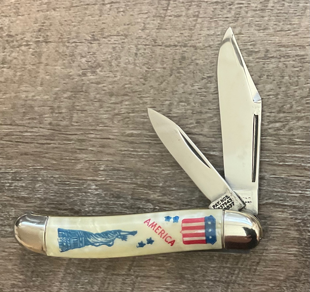

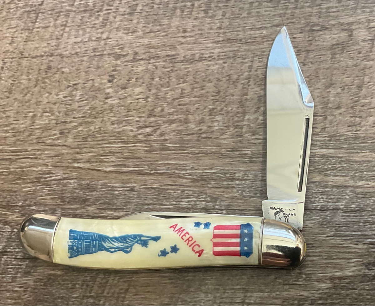

What would say about this one? Celluloid?

MadeinUSA wrote: Mon Feb 06, 2023 1:59 pm What would say about this one? Celluloid?
CE36D256-2420-4CBF-9B64-3007A9F4805D.jpeg80FA13A6-B396-43B9-9039-5DAE6539894D.jpeg4ADBCCE6-93A0-4DCE-804C-07230B00248D.jpegB1D43A7C-8610-4B75-A0B5-F512A6E6279C.jpeg
Yes. Celluloid wrap on shell construction handles. Not solid celluloid though.
That looks like a shell scaled knife to me. Are there tabs at the bolsters ends?

Sorry… don’t know what a tab on the holster end means…

Thank you…. I posted it for sale… I don’t want to risk ruining my other knives should this one start gassing

You can see the tab inside of the bolsters on the right. It clips a shell scale to the liner/frame. Hope this helps.

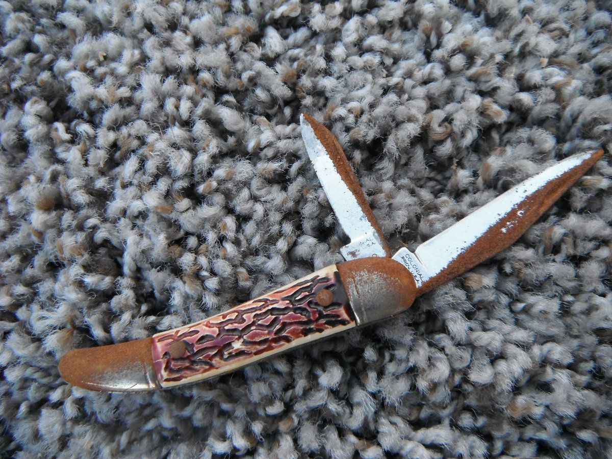

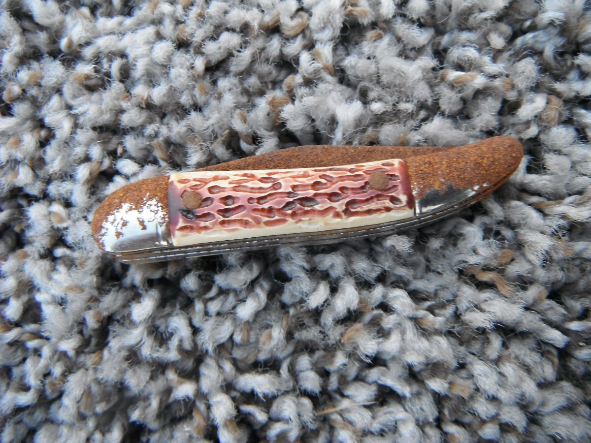

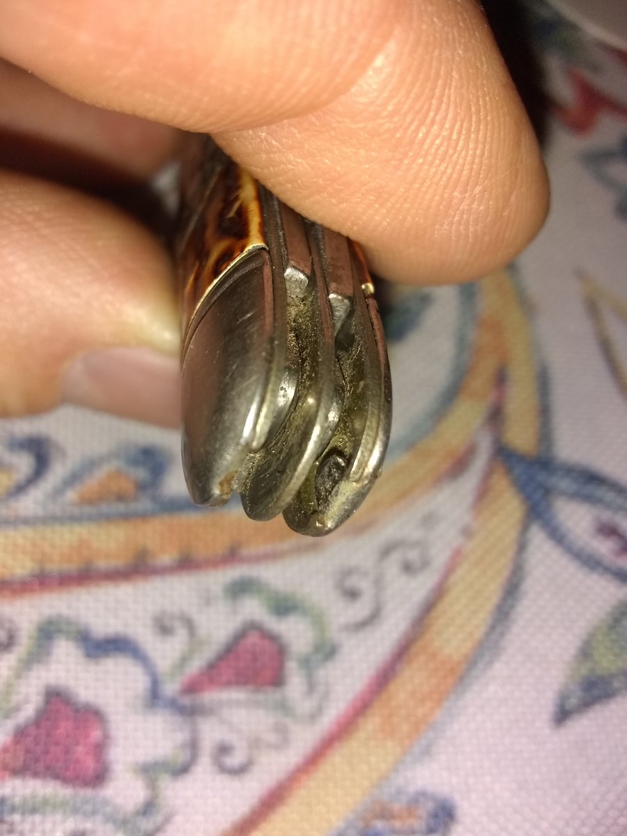

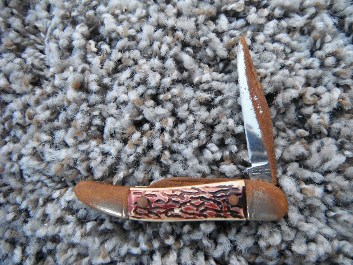

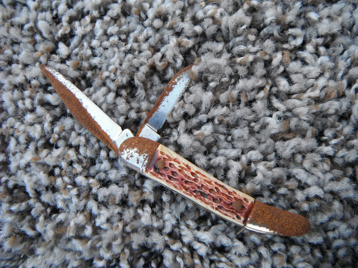

I just posted a new thread on outgassing ... ::dang:: I did not see this thread... ::facepalm:: well, I guess I did not need to make a new thread. ::facepalm:: Does this look like rust from out gassing? ::hmm:: I had this knife in a cigar box with other knives from the 1930's and the knives ended up rusting in the same way. It seems mainly on the tops of the blades and not on the bottoms/springs of the knives as they were sitting upright. ::hmm::

GSPTOPDOG wrote: Tue Feb 07, 2023 4:00 am I just posted a new thread on outgassing ... ::dang:: I did not see this thread... ::facepalm:: well, I guess I did not need to make a new thread. ::facepalm:: Does this look like rust from out gassing? ::hmm:: I had this knife in a cigar box with other knives from the 1930's and the knives ended up rusting in the same way. It seems mainly on the tops of the blades and not on the bottoms/springs of the knives as they were sitting upright. ::hmm::
Yes, that is celluloid outgassing damage. The exposed edges of blades and any nickel silver parts (like bolsters and shields) and brass (liners) may be damaged. If others were also damaged it may have originated from that knife or spread from another in close proximity. ::shrug:: Once one goes it will take others with it, including knives not having any celluloid. Eventually, after long enough time, it can disintegrate the entire knife leaving nothing but rusted pieces.
GSPTOPDOG
Posts: 9133
Re: outgassing prevention
Post by GSPTOPDOG »
Mumbleypeg wrote: Tue Feb 07, 2023 4:14 am
Thanks, ::handshake:: I tried to clean the one in the photos up, but it has DEEP pitting...and the others nearby all look similar... ::facepalm::

Thank you, that helps explain. Mine does not have the tabs
Posts: 21489
I replied in the other post, GSP. That is outgassing but not from that knife. Better check the other 30 in that cigar box. ::nod::

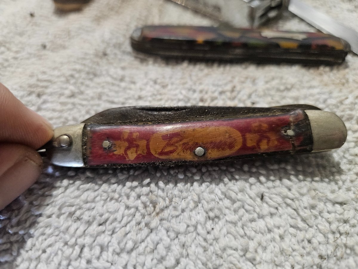

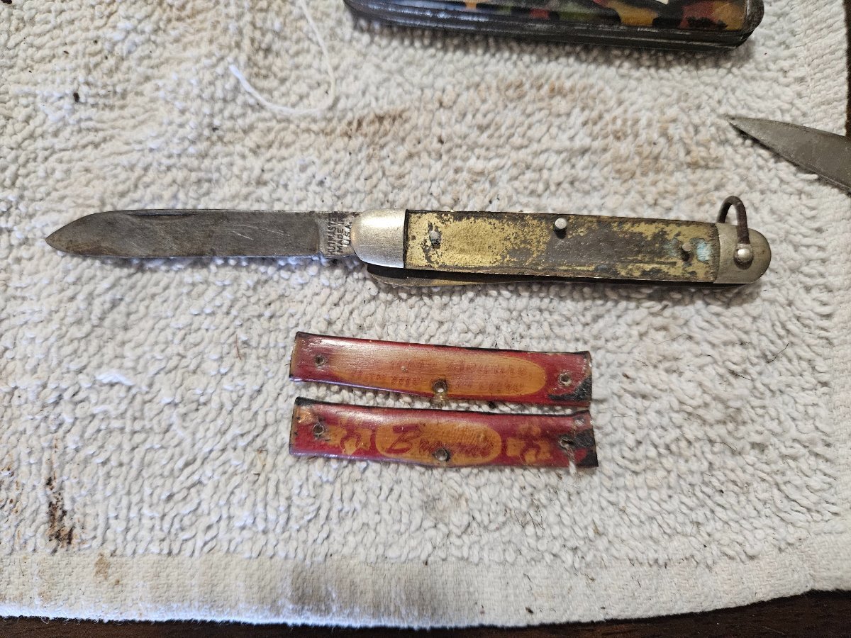

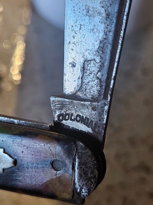

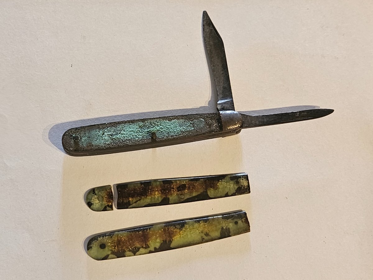

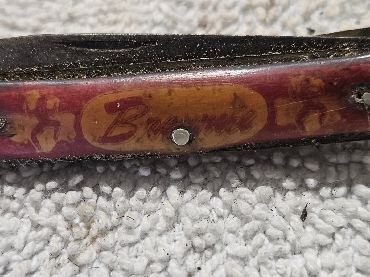

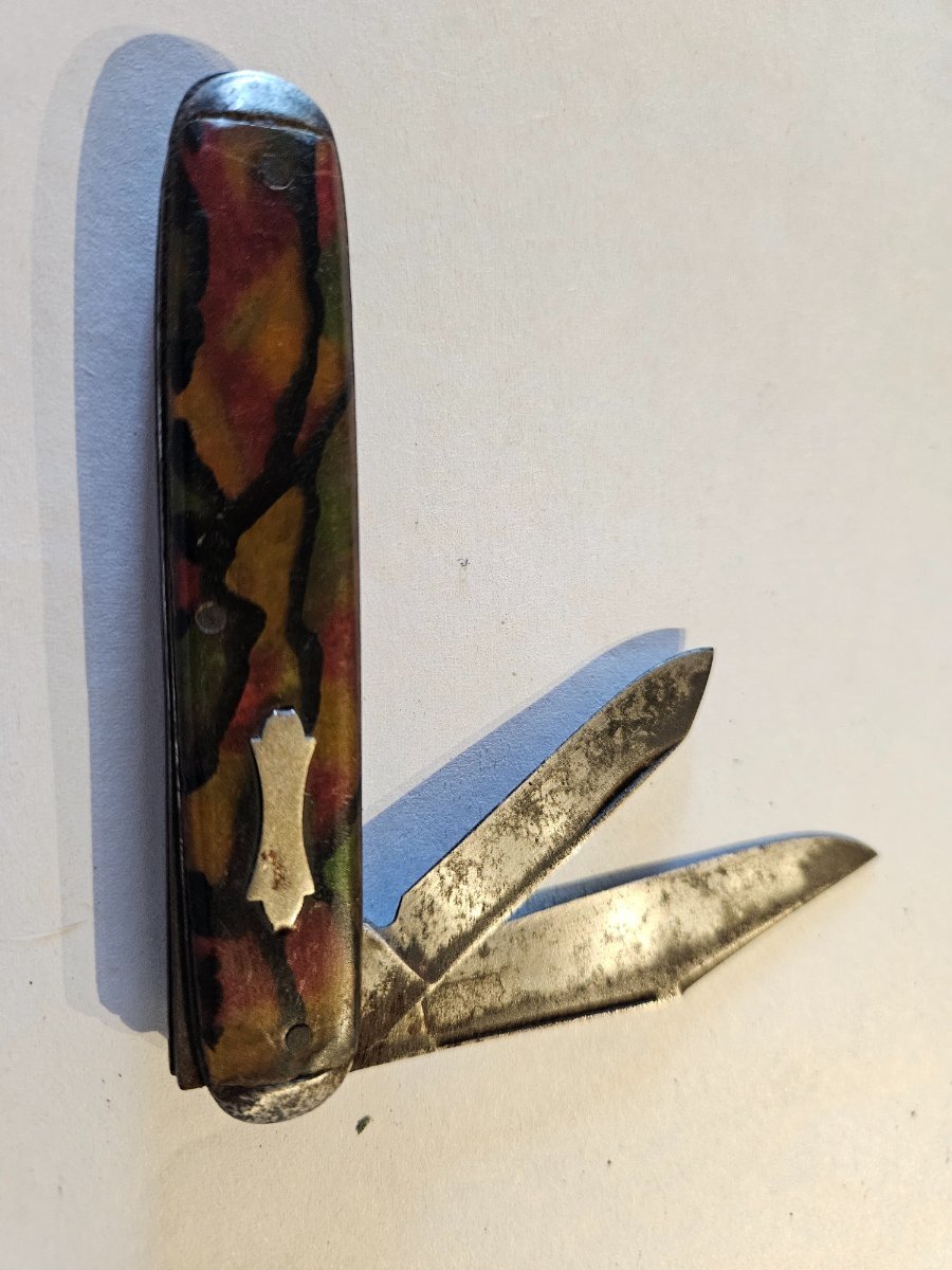

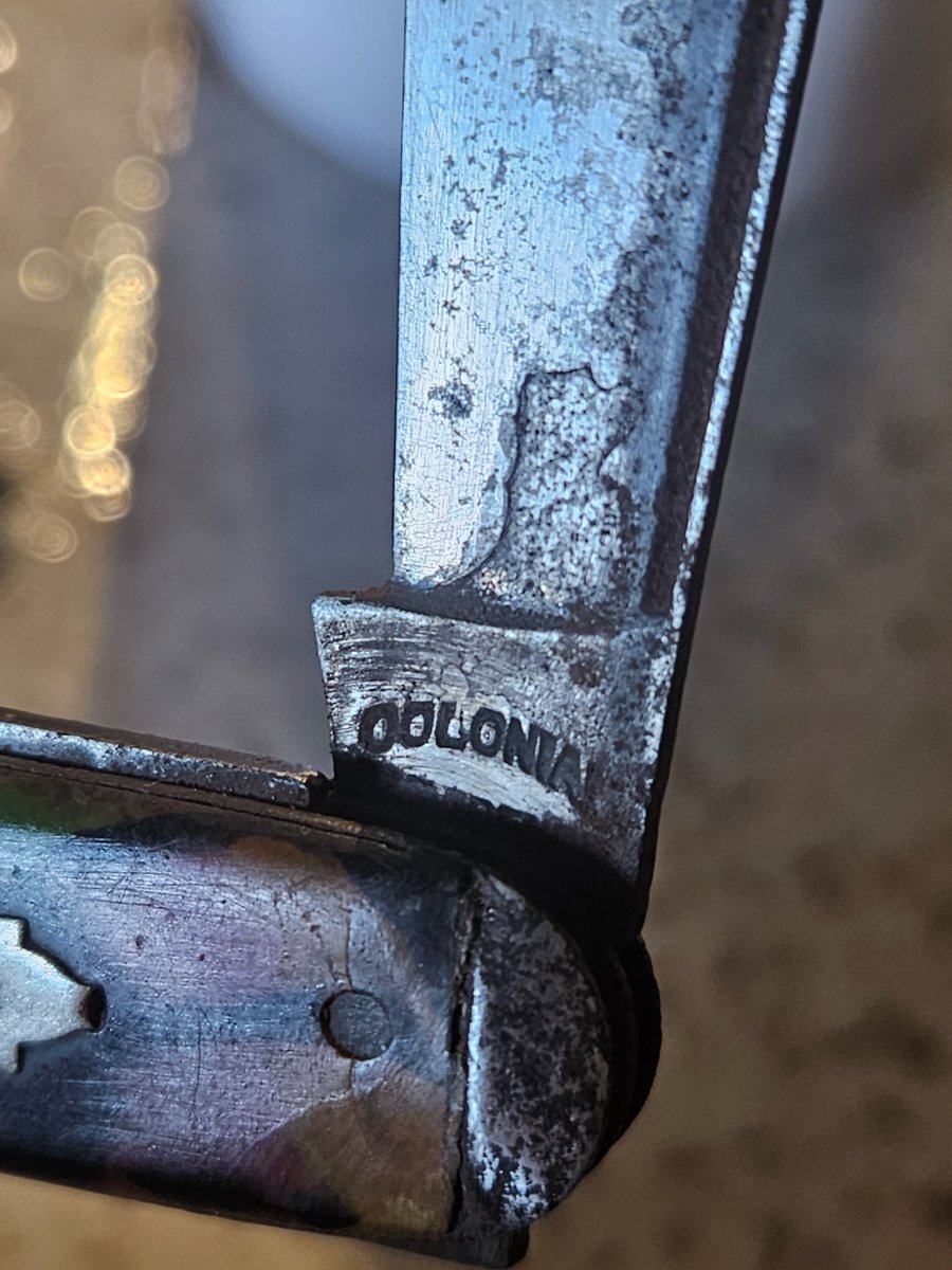

Well I recently got a batch of knives from auction and sadly, a number of them seem to have celluloid scales in rough shape. I'm really bummed about the Brownie knife. I yanked the scales off as carefully as possible in hopes their may be some way to save them within an epoxy or something.
I'm pretty sure the answer is "trash can" but just checking if there was something I could do with them.
Single blade Kutmaster liner lock Brownie.
Remington barehead
Colonial Christmas tree EE jack
Should I yank the Colonial scales? Or not quite yet?

Posts: 21489
Wow, I've never seen a Kutmaster outgas like that. Thanks for posting, now I need to do some more separating.
