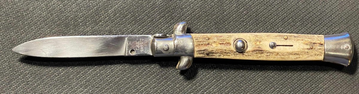

Re: Newbie questions
Of all of the stiletto style switchblades in my inherited collection, this the only knife I have with the red dot (although it is hidden in this photo).
