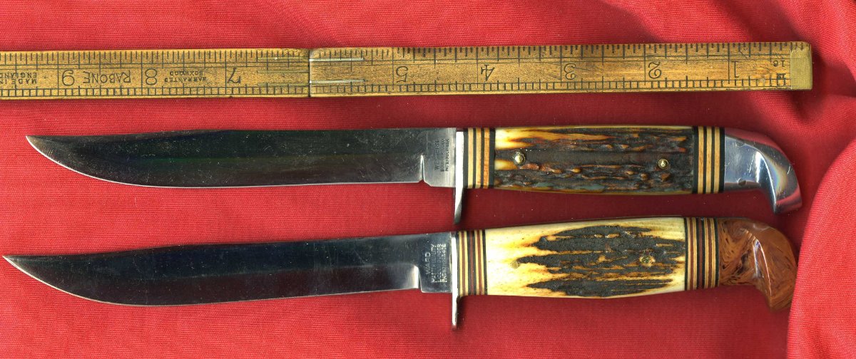

Here is a Western with the brown swirly.
