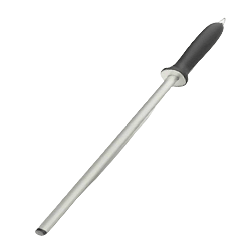

I was thinking more like this:
- cudgee
- Posts: 6930
Re: Are Pocket Sharpeners Bad
If you can use one properly, they are okay. But remember they are only one grit, so if you want different grits, eg.. course, medium and fine or even super fine, can workout an expensive way to go. But if you are confident in using one, then yes by all means they are okay.

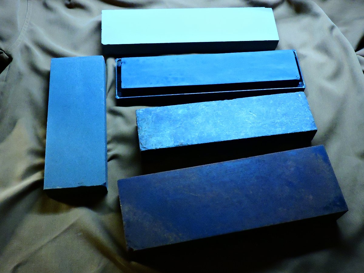

Since you're considering other options; have you considered stones at all?

If you can get larger stones, 6" and larger, they offer a great variety in grit for not too much money if you buy them used. Yard sales and flea markets are a good source for a variety of grits and sizes. Start with coarse stones first so you can see a obvious change in how your edge is developing.
If you can do this, In my opinion, with some practice you will be at a huge advantage.

Thanks! I'll have to look into this.FRJ wrote: ↑Thu Mar 24, 2022 1:47 pmIf you can get larger stones, 6" and larger, they offer a great variety in grit for not too much money if you buy them used. Yard sales and flea markets are a good source for a variety of grits and sizes. Start with coarse stones first so you can see a obvious change in how your edge is developing.
