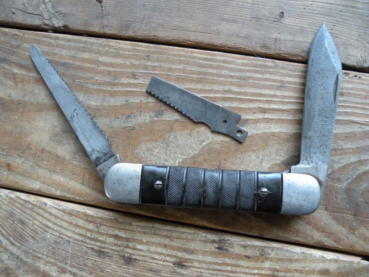

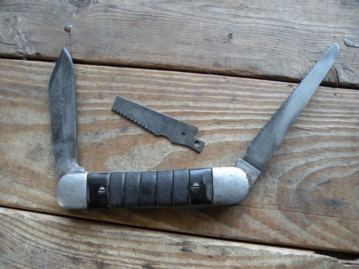

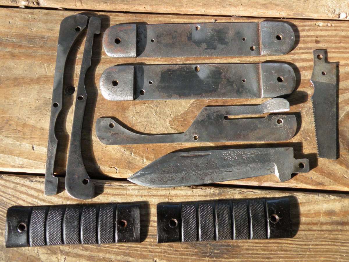

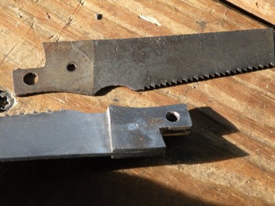

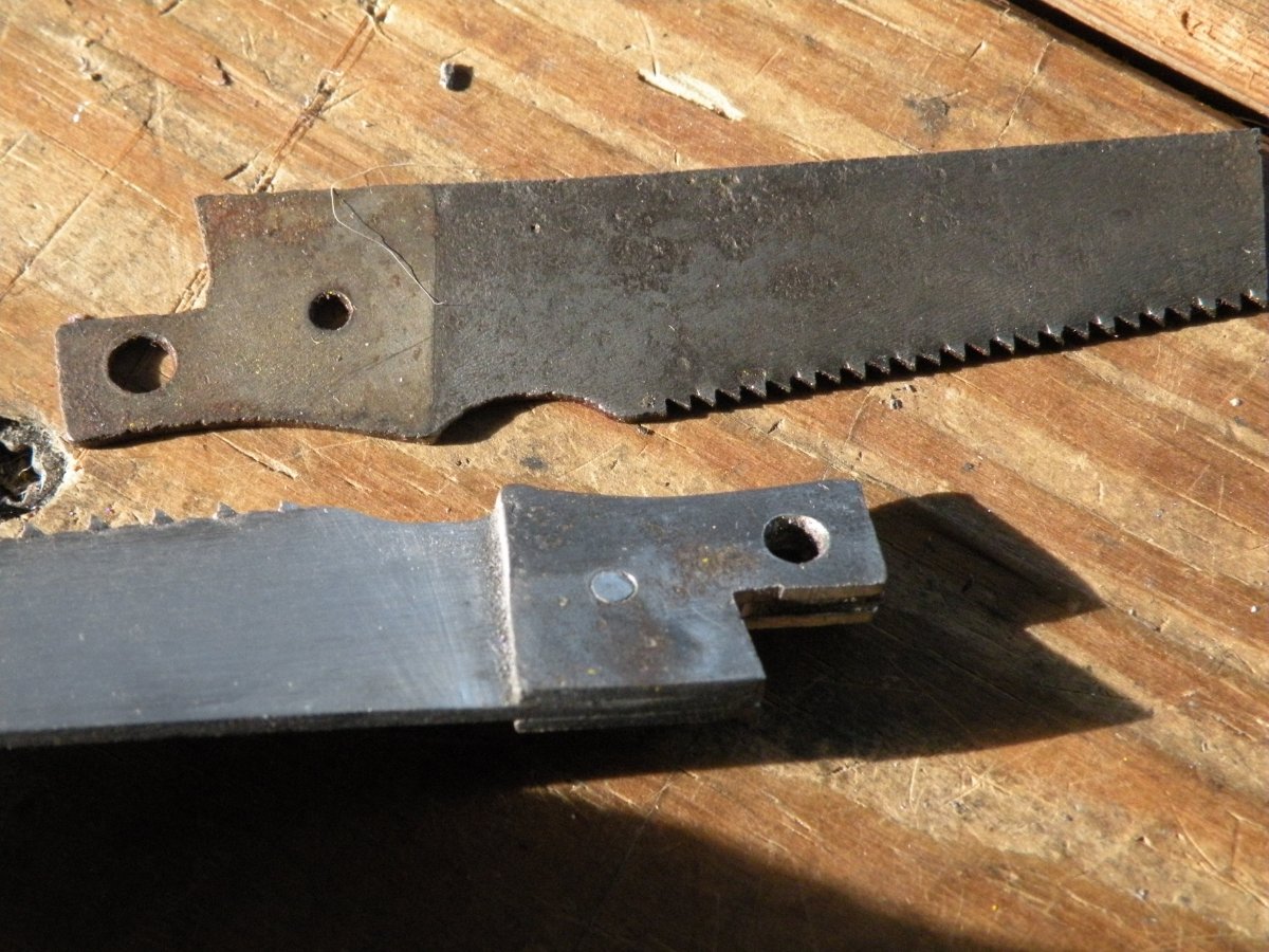

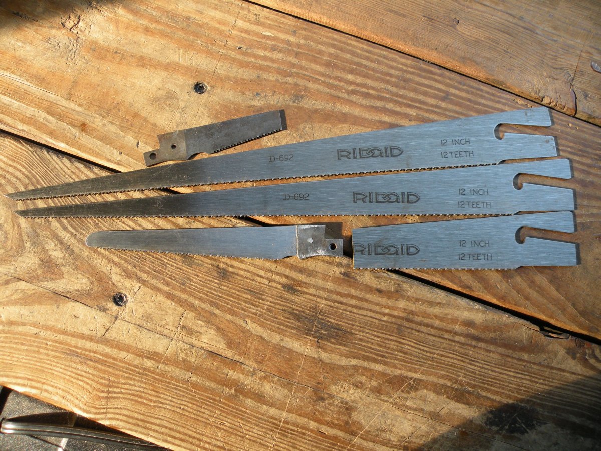

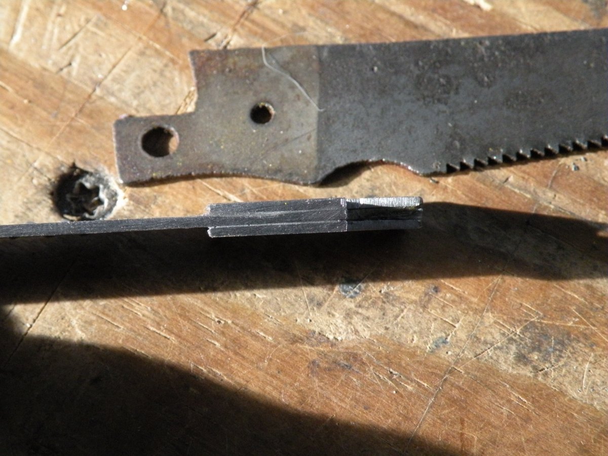

It seems like at least half of these pilot's survival knives that I see have a broken saw blade. Other than the saw, these are among the sturdiest, heaviest, folding knives that I have ever worked on and are truly "built like a tank". So I've never been able to understand why they put such a thin, fragile saw blade in them. Anyway, I'm sure that I'm not the first person who has contemplated replacing a broken saw blade in one of these. I think I may have even seen a post about doing this some time ago, but I haven't been able to find it. I've had a nicer one of these knives with a broken saw sitting in my collection for a long time and I've been itching to give it a try for quite a while. But, I was concerned about possibly messing up a WW2 artifact, so I bought a cheap, heavily used "beater" to work on as an experiment, and here it is. I went with a thicker, stronger saw blade as an improvement, but when I get around to replacing the saw on my good one, I've got an old keyhole saw with a nicely rusted, thinner blade in mind for a blade donor.

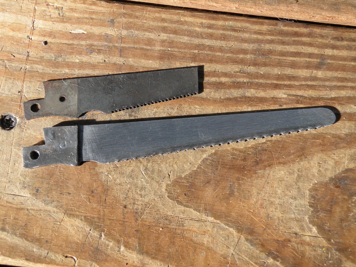

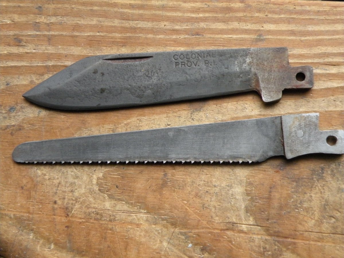

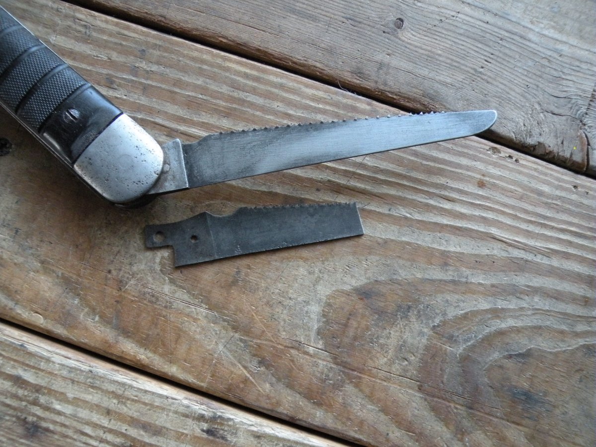

Sorry, as I frequently do, I forgot to take a picture before I got started, so the first picture is with the patient already disassembled and I had already removed the tang spacers from the broken saw blade. I found a 3-pack of Rigid D-692 keyhole saw blades that looked about right on the bay for $16 plus shipping. They are actually a bit thicker than I wanted, so I had to shave down the tang of the new blade before I transplanted the spacers from the old saw blade. Before I reassembled everything, I gave both blades an overnight "magic patina" treatment with white vinegar. The steel pivot pins in these things are massive (about .148" or close to 5/32). So I drilled out the center of the old pins as much as I could (I wound up eventually using a 7/64 bit) and then was able to cut the pins in the normal way. For replacement pivot pins I used 10d steel nails, that turned out to be perfect, and 8d for the rocker pin, which was also perfect.

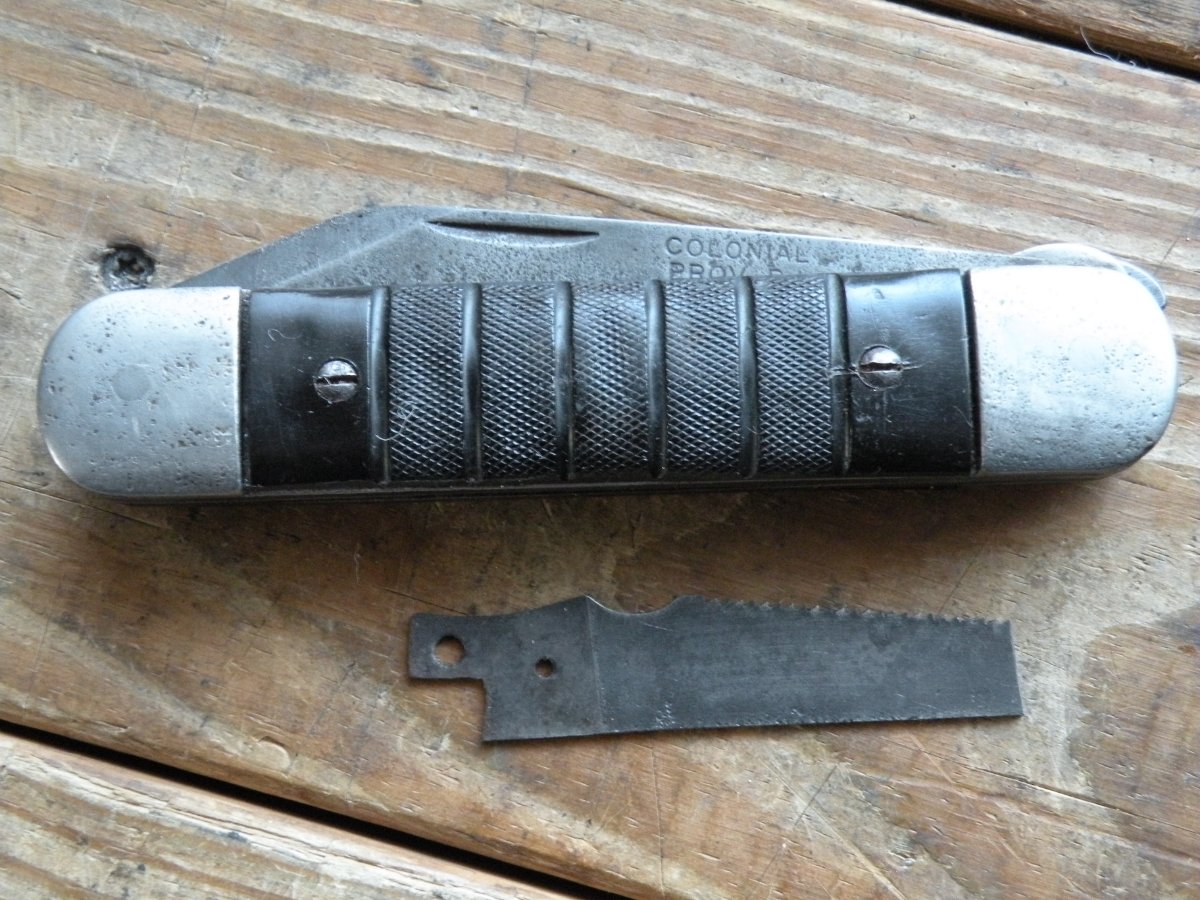

I wish that I could find suitable black composite material to use to replace the black composite handle scales, which you can see have shrunk on the ends. (Maybe I'll just fill in the gaps until I find the right material.) Now that I'm looking at the pictures, maybe I'll darken up the blades a bit more. This was a fun project. :D

IMO the shrunken handles didn't hurt the finished product one iota. In fact (again IMO) they give the knife a vintage look. Excellent job. Looks original.

Very nicely done! I’ve wondered about these blades too. They are usually broken. And the stub rarely shows any use at all. I think they were too hard and snapped pretty quickly.

Looks great! I have thought of doing what you did, but with a sawzall blade. I never got around to it, but seeing yours encourages me to give it a go!

I have two of these waiting for me to repair them. I had been concerned about getting the correct length saw blade. I did not think about getting a longer blade and cutting it the correct length!

Thanks Reverand, and everyone else. Reverand, your comment about cutting the saw blade to the correct length just reminded me about one little modification I made, and will probably continue make on any of these saw blades I replace in the future. If you look at the right side of my last picture, the very right end, you can just see the rounded end of the saw blade sticking out a tiny bit. The saw blades on these do not have a pull (nail nick) and the only way to open them is by slipping a finger nail under the end of the saw blade. I find that to be a nuisance, particularly on stiff blades. So, I cut the saw blade 1/8" longer than the original. I know that doesn't sound like much, but I can easily grab onto the end of the saw blade to open it now.

I've seen some people use Sawzall blades, but I like those keyhole saw blades better. The teeth are a closer match to what is on the original knife. While a blade for wood is more suited towards my real use--these knives were built to make quick work out of aluminum and plexiglass. And, not to mention, a metal cutting blade that long makes the Gerber and Leatherman models that take a short (to the point I've had to cut some wood cutting jigsaw blades down on a bench grinder just so that they would be able to fold into the handle) jigsaw blade look like a bad joke. Some of the big Swiss Army Models (esp. the big RangerGrip line) have some serious saws on them, but the saws aren't that great. There is a metal file on some 111mm knives, but the saw is too thick to properly cut anything. The only "knives" that have big saws other than these are folding saws that take a reciprocating saw blade, but also have a utility knife and/or clip point blade that folds out the other end.
