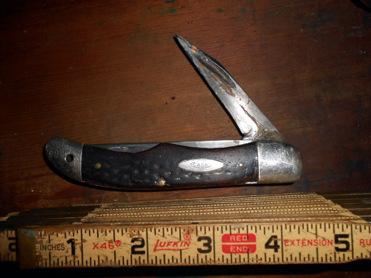

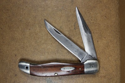

Is it possible to replace this main blade?
Post by Maddogfl »
Or practical? Case was no help to me, "blade no longer available." There was a number on the back side of the blade, but it is too worn to read, even with magnifiers or the camera tricks. Will I just have to whittle a new blade?

I’m not a Case guy but it looks like a 6265 case folding hunter. I’m sure one of the Case folks will be by shortly with more information for you.

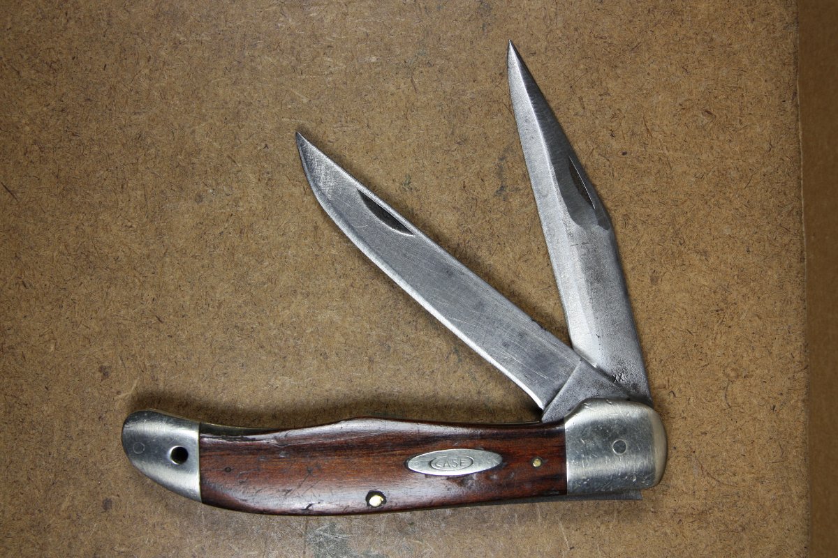

Yes, it is possible, but besides possible you should also ask "Is it economically feasible?" I have a very similar knife that I have been looking for a replacement blade for. Going on 3 years, so I am not optimistic.

If you just want it as an EDC, you might consider having the main blade removed and just use the spey.

I agree with Reverand. I have converted quite a few of those 65's with broken blades into single blade knives, and they make great EDC's. As already mentioned, it is very hard to find one with a good clip, but the rest of the knife is in bad shape. But, if you do find one, they are very easy, solid knives to work on. :D

The knives pictured are old models that Case no longer makes parts for. They are currently making these, but the parts do not interchange with the old models shown.

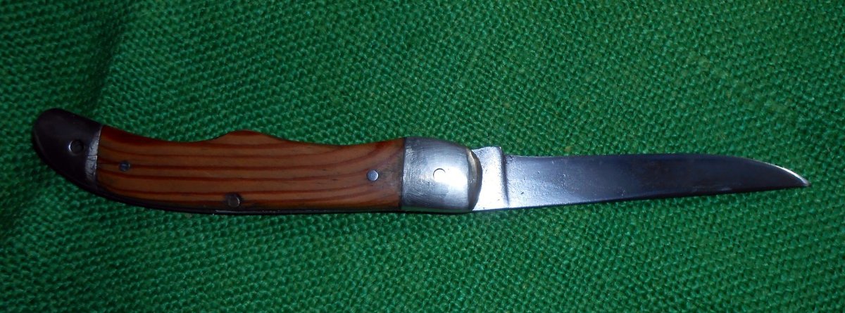

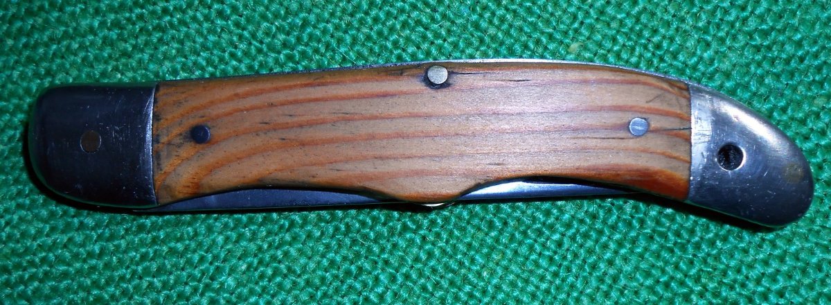

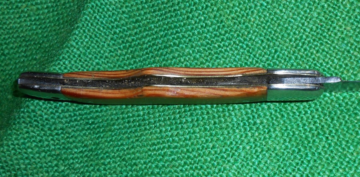

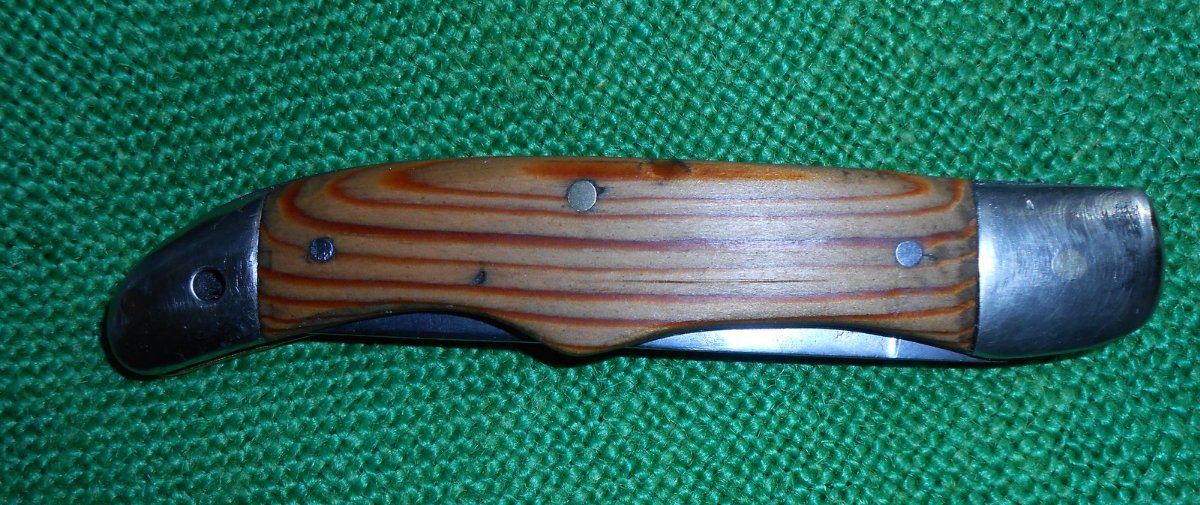

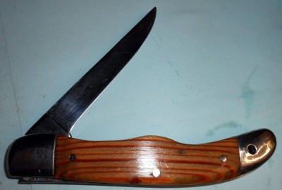

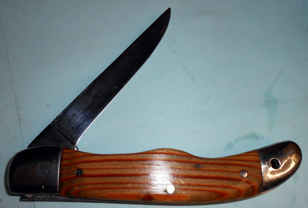

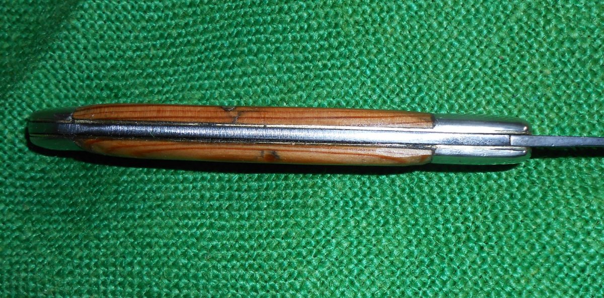

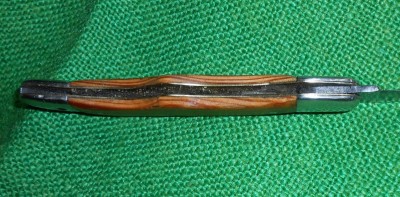

Thanks for the tips. I converted the knife from a case to a knife today, and I winged it. My first disassembly and reassembly.
Of course, I did not have the correct pin stock, so I used the oversized stuff that I had. I redrilled all of the necessary holes in the spring, blade and liners on my cheap drill press. I decided to discard the old scales that were heavily worn and one side was cracked at all of the pins. I didn't have pins for that either, but I did have the appropriate sized nails. ;) I got it back together, it is tight, with good snap and it feels a lot better in the hand. I have stopped before the final sanding an polishing to let the sealer I put on the wood dry so that I won't have to fight the polishing compound. I took some closeup pics that show my worst areas. I will deal with them tomorrow, and start putting final finish on the scales. It will never be a thing of beauty, but it will be something that I won't be ashamed to pull out of my pocket. It was a fun way to spend half a day.
EDIT: I decided to slap some oil on it and call it done.

That looks great! You really changed that from Trash to Treasure! What kind of wood is that?
Jesus is life.
~Reverand
Meridian_Mike
Posts: 5041
Location: Mississippi
Re: Is it possible to replace this main blade?
Post by Meridian_Mike »
Nice job!
That is using your head.
::tu::

OLDE CUTLER wrote: Tue Nov 09, 2021 9:00 pm Yes, it is possible, but besides possible you should also ask "Is it economically feasible?" I have a very similar knife that I have been looking for a replacement blade for. Going on 3 years, so I am not optimistic.
Is the blade in that knife not a Case blade? I have some XX blades for a 6265, but they are about in the same shape as the blade in your picture.

Way better than I could have done, and the perfect EDC and conversation piece. ::tu::
Pine scales? Still USA made too. :wink:
Yes, it is a Case blade, but some rocket scientist thought they could take an old worn blade like that and sharpen both sides and make a folding dagger out of it. Problem is when you fold the blade in, it only covers one of the edges and the other "edge" is out in the open to cut your fingers or worse.

Nice save, good use of what you have on hand!

Nice job, it looks a ton better! Great save! ::tu:: ::tu::

You won't get that pine at the local Home Depot. 25 years ago, I tore down a barn that was over 100 years old to salvage the lumber. When the barn was built the old growth long-leaf pine was so plentiful they only used the heart of the wood in construction. The burned the stuff that we use to build houses now days. The Heart Pine is naturally resistant to insects and rot, it is very strong and very hard. (like me) Not only that but it looks good and smells good! (again, like me)
My next set of scales are going to be cut out of a block of ancient Live Oak that was once a part of the USS Constitution's armor belt. When they renovated the old gal in the 80s, they sold pieces to help pay for the restoration. The block that I have is part of the "Iron" in Old Ironsides. I just need to find the right blade in need of new clothes.
