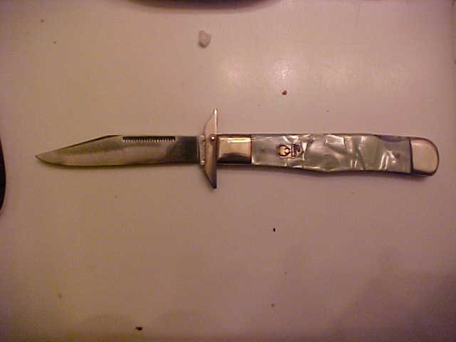

OK, I'm still new enough not to have a real idea on this one. The knife is an Ohio Cutlery Tru-Temper. Secondary blade is broken. The handles are kind of translucent, which makes me think plastic, but there are definite layers, and on the pile side you can feel them. I tried to capture that in the third photo.
Question is: what is this material? I originally bought the knife thinking I'd make it a single blade user like a couple of others I have done, but I'm pretty sure the scales will come apart if I try to take the knife apart. If they're plastic I probably don't care, but if this is some cool kind of bone, then I may leave it as it is.
Any ideas?
Any ideas?

That's beautiful example of some earlier celluloid.
Very similar to the kind that I've seen on some made by New York Knife Co. as well as some of the older companies. I think Ulster made something similar to that also.

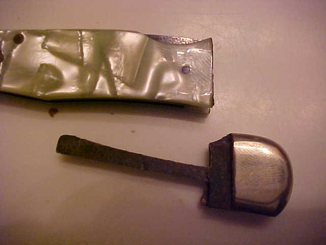

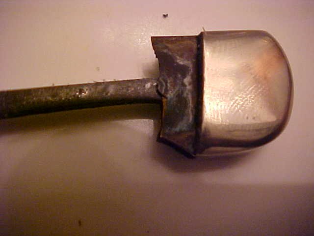

If you're not familiar with celluloid, it does have a tendency to break down over time and release sulfuric and nitric acids. The reddish haze on the bolsters next to the celluloid handle is an indicator that the celluloid is destabilized and is beginning to off gas. If allowed to continue it will pretty well the knife alive.
When I see a knife like that I immediately remove the handles, it's probably pretty easy because it's probably brittle by now. A thin knife blade, like a kitchen knife is probably all it will take to slide underneath the handle and pop it off in pieces. Then my recommendation would be to wash the knife thoroughly in baking soda and water to help neutralize the acid.
Then you can re-handle the knife.
Sorry, in my first post I was answering your question about the material on the handle. After posting I went back and looked and could see that the celluloid was beginning to off gas, so I thought I should inform you about that also.
It's your knife, and you can do whatever you wish with it. I'm not in the business of telling people what to do with their knives unless they ask, but I also don't like to see people new to the hobby be uninformed.

OK, that's what I wondered. Yes, I saw the corrosion on the bolsters and thought that might be the issue, but I've never seen any kind of plastic de-laminate like that before (and I worked in the plastics industry for a few years). It's kind of a pity because I really like the look of the handles, but not what it'll do to the rest of the knife.
SO anyway, I'll do what I originally planned to do, which is take it apart and make it a single-blade knife with new scales. Another handle project!

Actually, I already got the knife apart this afternoon, and it's sitting on my workbench now. I'm trying to think of something I could do with the scales to show them off that will keep them from anything that can be harmed by the outgassing...herbva wrote: ↑Fri Mar 05, 2021 11:30 pm In the meantime, before you start work on it, I recommend that you DO NOT store it with or around other knives. The gas produced by the outgassing celluloid can destroy other knives in the vicinity, particularly if stored in the same container. It is a shame, many of these old celluloid patterns were very cool.![]()

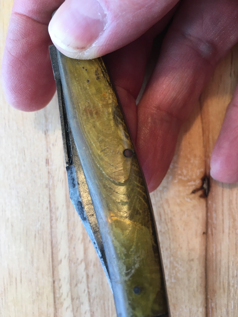

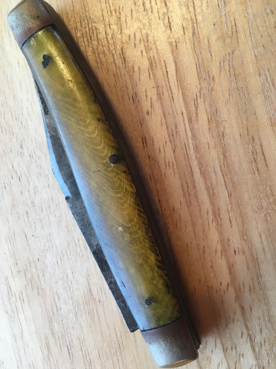

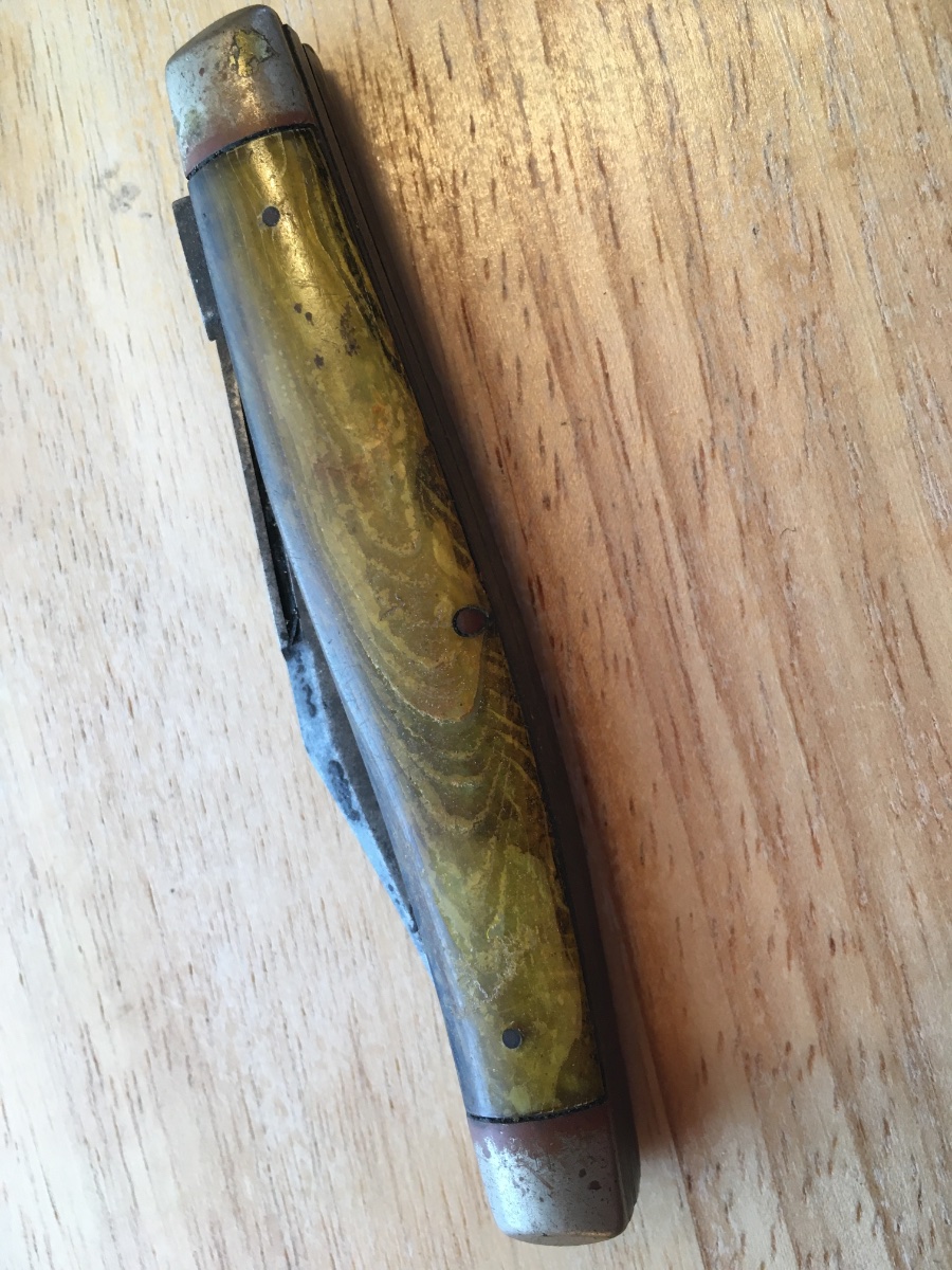

Here is a great example of cel degradation.Looked nice from the outside and when I went to press down on the lock to close it,the end broke off in my hands!
Adventure BEFORE Dementia!

Well, don't throw that one away. A few months ago I bought a small collection of Winchester knives (5) with 1989-1992 tang stamps that had been put away in storage brand new and the cell scales were quietly outgassing in storage. I am guessing that the owner never checked on them until too late. (I don't know who actually made these knives for Winchester, but the celluloid was of course the short-lived variety.) I thought they didn't look too bad from the auction pics (not ebay), but looks can be deceiving. I just finished rehandling the last of them. The last one I worked on is a jumbo toothpick, and when I started to disassemble it, it fell apart in my hands just like your knife. The corrosion actually ate through the liners. So, I had an extra step to do of making new brass liners and transferring the bolsters to the new liners. It is a bit time consuming, but not as hard as you might think.knife7knut wrote: ↑Sun Mar 07, 2021 9:50 pm Here is a great example of cel degradation.Looked nice from the outside and when I went to press down on the lock to close it,the end broke off in my hands!

Threw it out a long time ago.First knife I ever threw away.herbva wrote: ↑Sun Mar 07, 2021 10:19 pmWell, don't throw that one away. A few months ago I bought a small collection of Winchester knives (5) with 1989-1992 tang stamps that had been put away in storage brand new and the cell scales were quietly outgassing in storage. I am guessing that the owner never checked on them until too late. (I don't know who actually made these knives for Winchester, but the celluloid was of course the short-lived variety.) I thought they didn't look too bad from the auction pics (not ebay), but looks can be deceiving. I just finished rehandling the last of them. The last one I worked on is a jumbo toothpick, and when I started to disassemble it, it fell apart in my hands just like your knife. The corrosion actually ate through the liners. So, I had an extra step to do of making new brass liners and transferring the bolsters to the new liners. It is a bit time consuming, but not as hard as you might think.knife7knut wrote: ↑Sun Mar 07, 2021 9:50 pm Here is a great example of cel degradation.Looked nice from the outside and when I went to press down on the lock to close it,the end broke off in my hands!
