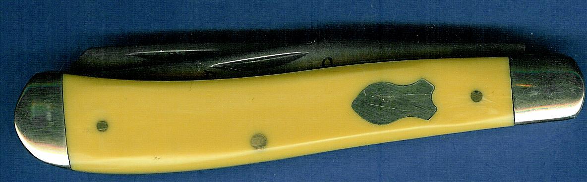

With Schrade having gone out of business then bought by Taylor to be made in China, is this Made in the USA knife New Old Stock or is it assembled from left over parts?
It seems nicely finished and came in the clear tube like the old Schrades did with the correct paperwork.
Tod
Gr8Scout
Here is the unhappy facts about your knife:
It was made in the USA, under contract by the person and/or corporation that now owns the Schrade name. It is a real Schrade, by that definition. It was most likely made in New York State. But not in the town of Walden.
The pattern is a 293Y, but it is not an original, pre-July, 2004 Schrade made in the town of Ellenville. Yes, the clear packaging is probably original, but was found in the old Schrade factory in Ellenville. The insert is close to the originals, but not real close.
Clues: Postion of the clip blade nail nick. The 'Everlastingly Sharp' etch.
The middle, backspring pivot pin which is neatly ground flush to the handle.
BR Levine likes to say "read the knife, not the markings". This knife is a classic example of why one should do that.
Street price on the knife you show us is about $30-40. On ebay it is not difficult to find an original for that price. In any event, your knife is a good user, and the quality is just fine.

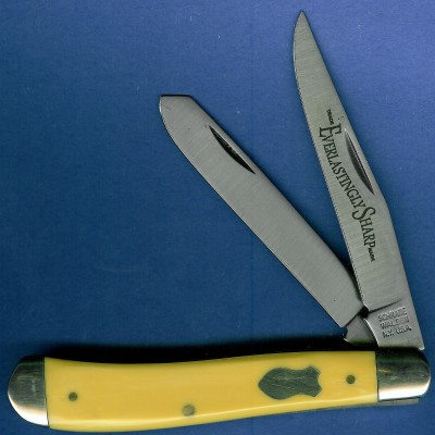

I was just looking at the tang stamp on the knife Testcase posted. Was the tang stamped with a half worn out die? I went looking on E-bay and found a Schrade Walden USA #293 trapper, item #180205220724. I noticed the letters touching each other on the tang stamp of Testcase's knife but, on the #293 trapper on E-bay they are not. Were there two different dies used to tang stamp these knives or is there a time difference in the two knives knives? Testcase, I'm not trying to offend you about your knife. If I have, I Apologize Sir. I'm just trying to learn more about knives and used yours for a lesson.

The eBay knife looks like the real deal (pre-1973) to me. Tod's knife is a modern, recently produced knife.

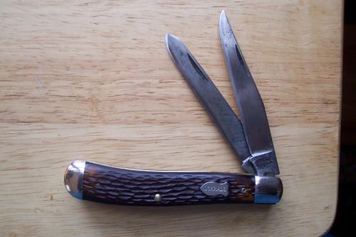

I found one of my plastic tube 293's, didn't notice until I photographed it, that the knife is a Schrade, not Schrade Walden. But anyway, showing the box as well. Can help indentify new from old.
The tang stamp fonts appear different on the new Camillus knife from the one I hold in my hand. Yet another clue.
Justold, don't feel bad. In knife collecting, everyone is wrong sometime.
