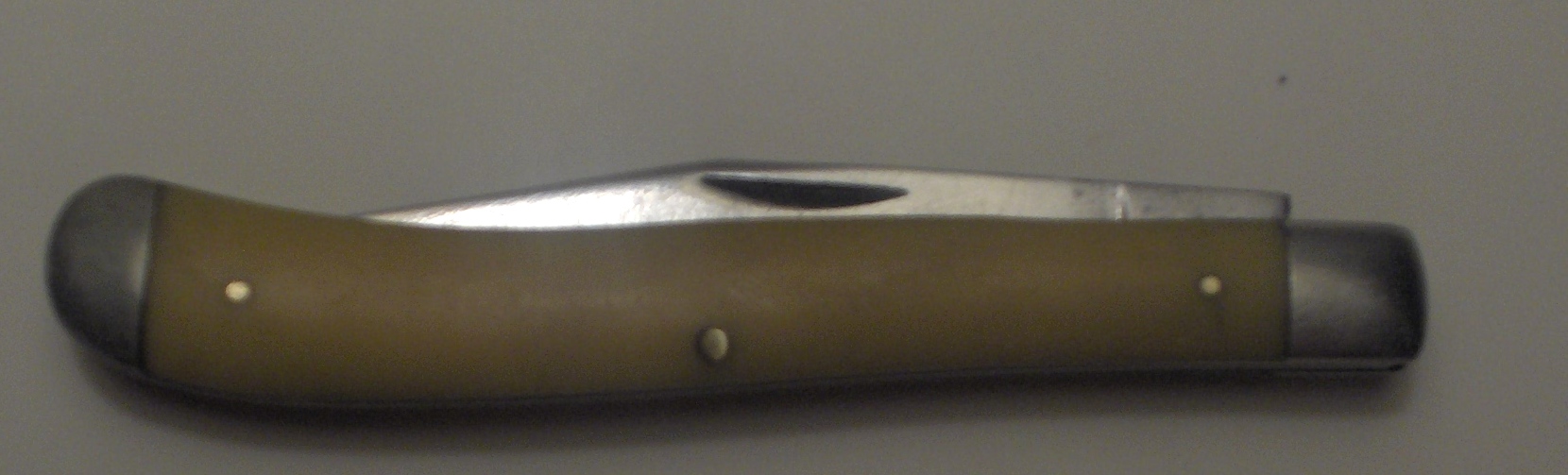

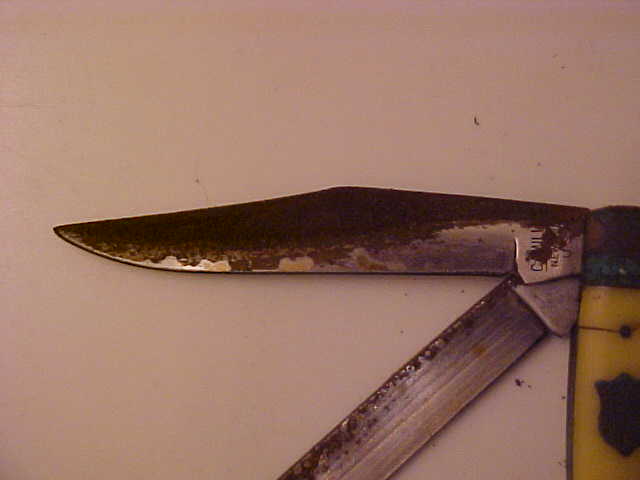

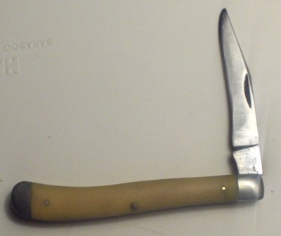

found its way into my pocket today.
She is a little worn, and someone took a grinder to her blade and the markings are all but gone, but she defiantly has the earmarks of a Camillus. I just don't know what patern she is.
Can anyone clue me in. I am growing fond of these little yellow sweethearts.

OK! I assumed there once was a tang stamp because there is what looks like an "A" where I usually see "USA" on the Camillus blades.knifeaholic wrote:The yellow slim trapper is a Queen...no tang stamp means 1960's (they etched the blades but no tang stampings).
I guess back to the books for me lol!

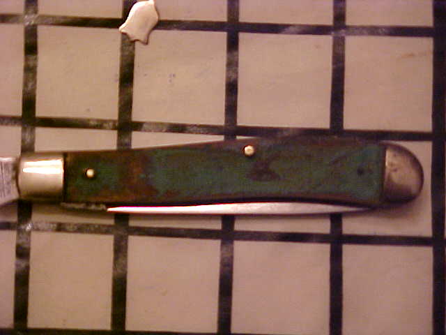

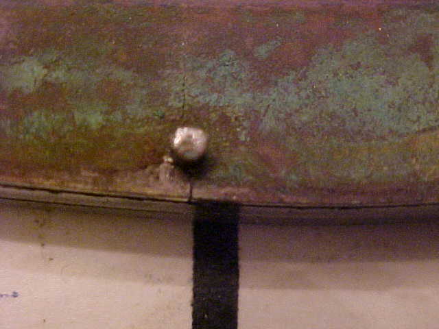

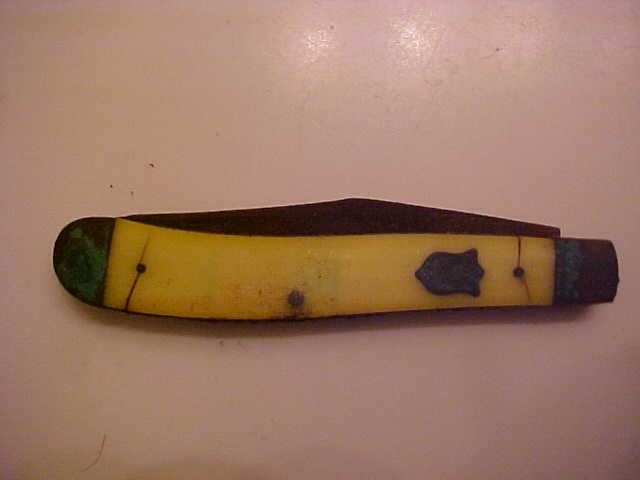

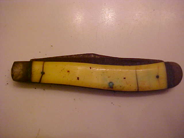

This is a Camillus #35 that has suffered "celluloid disintegration". Had an old Robeson swing guard with yellow scales that did the same thing only just on one side.Still trying to figure that one out.
Dug this out of my "segregated" pile today.Think I'm going to soak it in solvent and see if it will clean up.If so I'll take a shot at re-handling it.
BTW that degradation took only about 2 months.

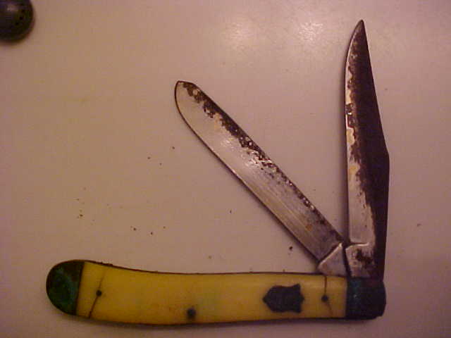

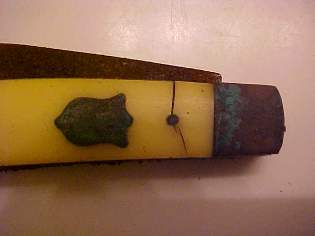

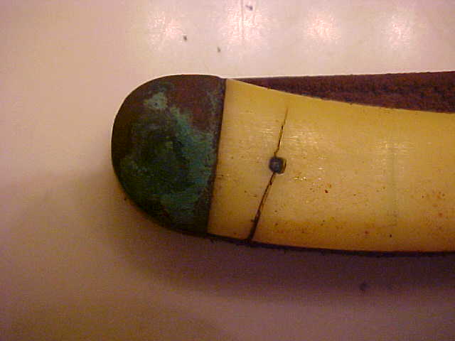

UPDATE:
After soaking the knife in AeroKroil for a day,I removed it from the bag and proceeded to clean up the outside.The blade corrosion appeared to be halted(at least for the present)but the scales seemed to be deteriorating more rapidly.
Using an old blade,I scraped off the rust and then used some 220 grit wet-or-dry sandpaper to remove the rest.Normally I use this paper with AeroKroil and gradually work up to 600 grit paper.The bolsters were scraped and sanded and then polished with Mother's Mag Wheel Polish.
I then proceeded to remove the scales to see how much damage the brass liners had incurred.A lot of green residue covered the scales which readily wiped off(probably due to the soaking in oil).A bit more scraping and polishing and the surfaces were reasonably well cleaned.
Upon inspecting the liners,it was found that a small but significant crack was emanating from the region of the back spring rivet and has spread nearly half way across the liner.
On other knives I have that have deteriorated similarly,it seems that the corrosion vigorously attacks the brass and destroys it in short order.This happened on a Novelty Cutlery Co.letter opener knife as well as the Buck Creek knife shown previously and a couple others.In one the stainless steel blades were like new but the brass liners had literally disintegrated.
On one Robeson I have,the pile side scale was completely destroyed while the mark side shows no evidence of deterioration whatsoever.

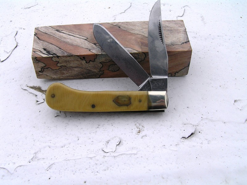

Here is a Picture of a 2005 Bulldog Saddlehorn that I got directly from Parker's late in 2005. Look at it already! YES, the handles are off, NOW.
The auto ignition surprised me but then I do recall hearing about a fire at Camillus, I believe it was. Of course the chemical toxicites are minute in quantity but when I see those temperatures on celluloid, it tells me to use fresh belts when working with celluloids. If an old belt is used, can it build up enough heat to start the breakdown?
Buffers can generate heat also onto the surface being buffed, is that heat enough to start a celluloid breakdown?
Since celluloid breakdown in knives is so random it would seem to point to a human interface element - that is who's doing the work on the knives, different in every company.
So, while I got answers, it gave me even more questions. Since celluloid is handled by humans by shaping and buffing, what part does that play in celluloid breakdown, since it's so random, even from the same batch, it appears to me to be a very BIG variable if I were examining a most probable cause.

Hmmm....that's a nice piece of spalted maple too, Hukk !
Oh, yeah....the topic.
I've been thinking too that something we do triggers the start of cell breakdown. How we store them, what we put on them.
But from what I've been reading, it seems to be self- accelerating as well.

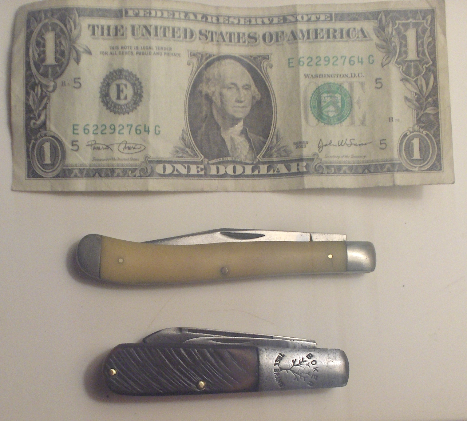

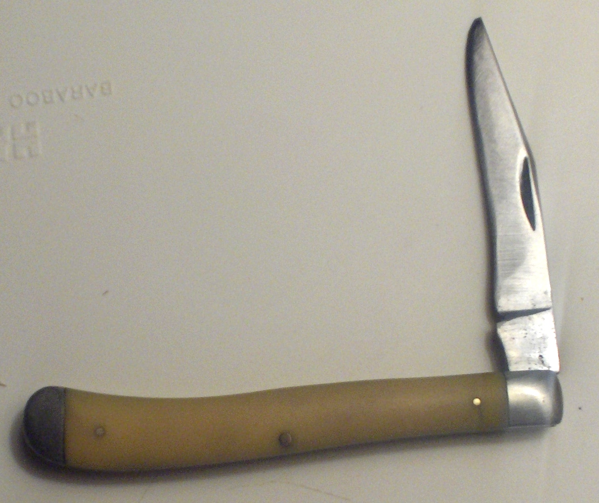

This one on fleabay caught my eye, looks like it is starting to out gas....
The link to the auction
http://cgi.ebay.com/camillus-yellow-22- ... dZViewItem
