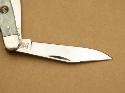

I bought this on impulse on Ebay mainly just out of curiosity to see what the quality is like on modern Hen & Rooster knives.
I find the combination of markings to be odd. The main clip blade tang is etched (not stamped) with BERTRAM CUTLERY GERMANY under the Hen & rooster image (also etched).
Each of the three blades is tang stamped (main blade on back tang) with GERMAN STAINLESS HAND MADE then the pattern number 313-IQ.
As to country of origin?? Who knows. The box says "MADE IN GERMANY". Does that mean that the knife is made in Germany or just the box?
I really wonder who makes these and in what country.
The quality is as expected not up to the H&R's of old, even the 1990's to early 2000's.
That said, this one has no real flaws. Great snap, no blade rub. All decent F&F. The even use asymmetrical grinding on the two small blades to avoid blade rub.

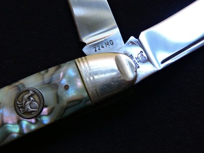

Here is a big congress from Bertram. 4 1/4". This is a very nice knife. It has some unique covers, the name of which escapes me
I bought it so long ago. Some form of plastic. But the action is very smooth and solid. All tangs stamped.

Re: New Hen & Rooster Stockman Odd Markings ???
Here's a link to some of the old codes for handle materials. I don't see MO anywhere though.
"mottled oyster" maybe???
viewtopic.php?p=126922#p126922

Thanks for the link akarangerbluedog.
It's some kind of Corelon.
