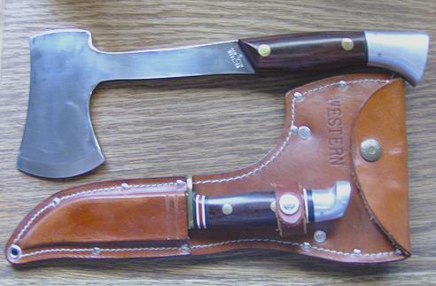

Anyway, you are right for sure about the exact time frame. My knife has the C in the pattern, dating it to 1979 ('77=A, '78=B and so forth), and it very well might be a CV steel, rather that just 1095. Good point.
Here is another Western Combo, but with the impregnated (
) wood handles.....
Bill
Bill
