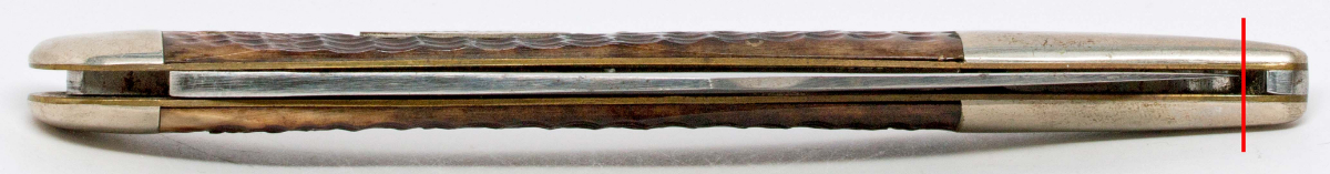

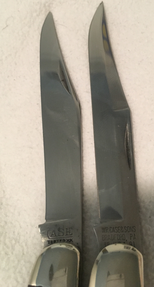

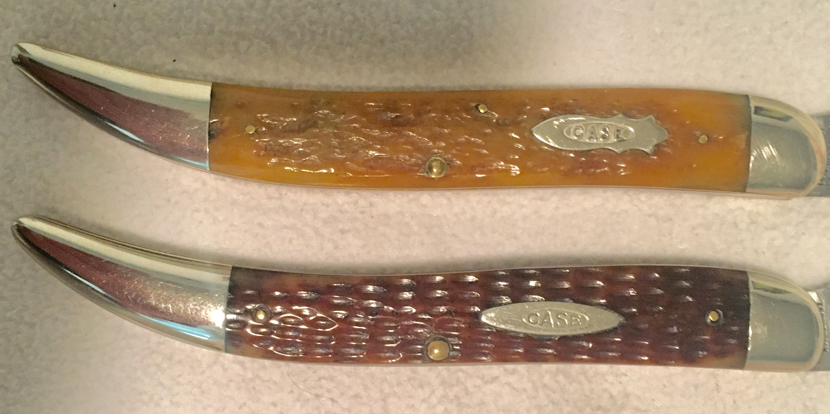

I own--and love-- a number of Case Classic 098 pattern toothpicks (with the 5 1/2 inch frame). Based on the few photos of the original 098s I'd been able to find, I concluded that the powers-that-be in the Classic line pretty much designed their own version of this pattern. My reasoning:
1) the shape of the Tested and Bradford Era 098 frames is a bit curvier with a slightly broader "chest" beneath the bolster and a narrower, slightly longer end cap (See first photo).

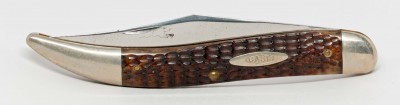

2) The blade on the Tested Era 098s (And the one Bradford Era 61098 I own) is a wide flat-ground clip with a low pull; and that on the Classic 098 is a narrow saber-ground blade with a bayonet- like deep swedge and a high pull. (see second photo)
But I recently found a knife listed by R. Davies that has caused me to doubt all the above. This is a W.R. Case & Sons Era 098 with a frame (as far as I can tell) that looks exactly like the Classic Frame! (I'll include a link so you can check out all the photos of this knife but I include one for a quick comparison). (see third photo)
https://www.ebay.com/itm/RARE-Vintage-W ... SwGUBaMWmh
This is the first ever 098 I've seen with this less curvy shape--sorta like a stouter Straight XX Era 093. The blade is still different and unfortunately this one suffers blade loss that mis-shapes the point somewhat. But, having a saber grind, it is a bit closer to the Classic 098 blade. (It looks to me kinda like the ones used on the Jumbo Trappers Mr. Davies lists.)
I'm wondering if any of y'all own a WR Case & Sons Era 098 with a blade that matches the Classic. It would be awesome to see pictures or at least hear your thoughts on this subject. I only started collecting a year and a half or so ago and have yet to see a knife show as I don't believe there are any in New Jersey. So, besides the three original 098s I've acquired, my study of the pattern is based mostly on the pictures Older Dogs and R. Davies have on Ebay and one or two I've found in the forums. Sergeant (RIP) only shows a Tested era 098.

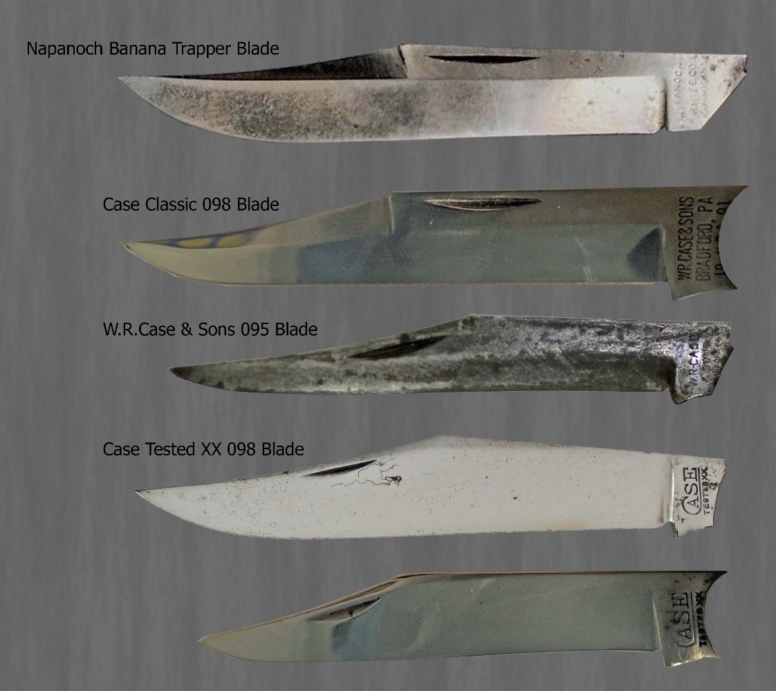

I feel like the Case Classic 098 "borrows" some from the 095, 098, and non-Case knives like the Napanoch banana trapper (comparable to the Case 51) pattern.
Here is a blade comparison picture along with a couple of pictures of my Case Tested XX 61098.
098 Blade Compare
098 Blade Compare

Robo, My 095 is a re-handled B1095. The "B" means the handle was some kind of man-made material (e.g., celluloid) which probably went bad. I measured it with a caliper (see picture below). The caliper says 4.95 inches, but I don't believe I had the knife properly matched up with the jaws of the caliper (please note the red lines annotated into the image). So my guess is that the length would pretty much be spot on the 5 inch length documented for the 095. Five (5) inches is also the documented length for the 093. The 098 is 5 1/2 inches. The blade on the 095 has a different shape than the 093. My 095 blade has been sharpened and may be tad short.
My 098 is in original condition with original blade finish and factory edge with no evidence of buffing. Included is a picture showing where the blade tip lands in the blade well. I agree with you that a short blade is one of the most noticeable things that detracts from an old knife that you want to be perfect :).

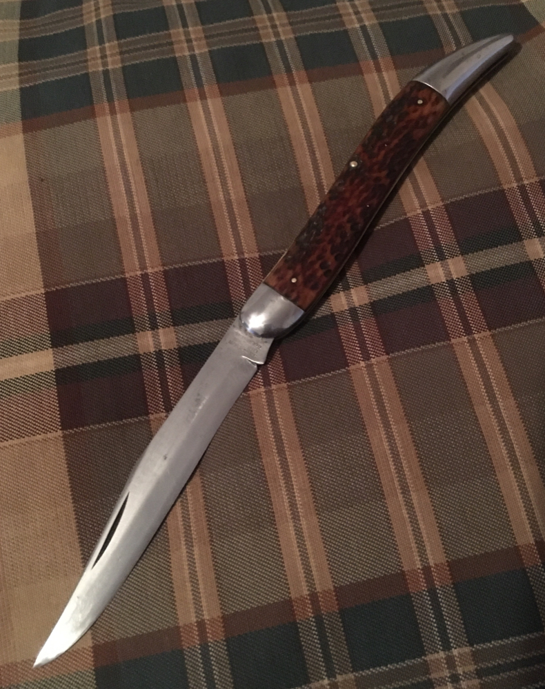

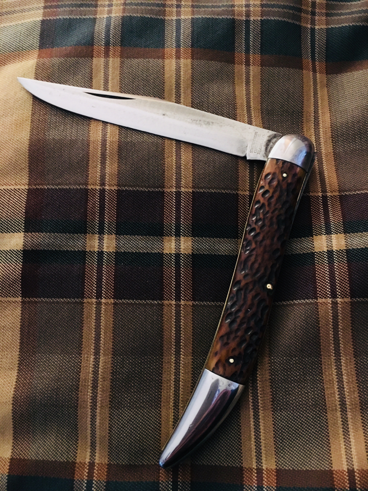

I believe I have solved the mystery of this unusual 61098 pattern. It is a large Tickler Case contracted from Schatt & Morgan. It wouldn't make sense for Case to have two distinctly different Handle dies for the pattern. It WOULD make sense for them to contract a bunch from their Neighbors at S&M. Why? In order to offer a large Tickler with a saber grind blade? To fill a production gap? S&M gave them a deal they couldn't refuse? That's the mystery but the surviving examples are the fact. Below is a very well preserved example of The S&M I recently acquired. Queen City continued to make the big 5.5" But I believe production ceased going into the "Queen" Era. It seems Landers Frary & Clark also contracted this knife from S&M or QC. CHEERS and thanks to all who pitched in on this.
