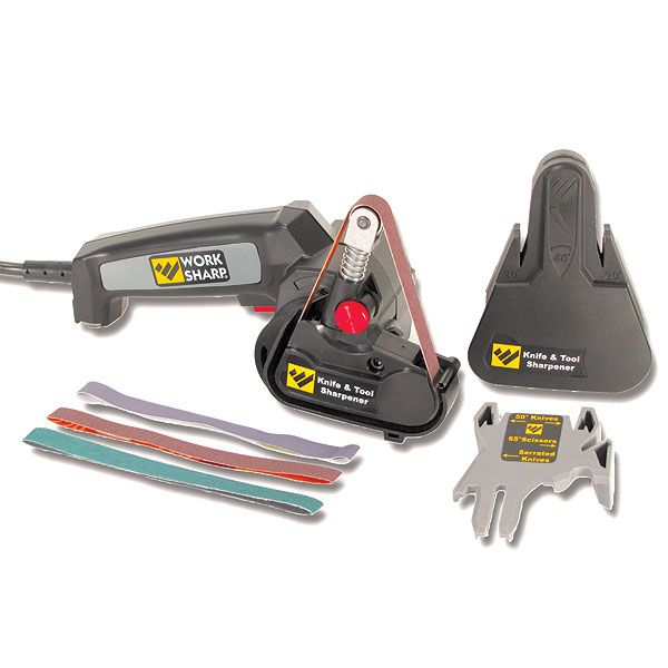

For scissors and kitchen knives, I use the Work Sharp. Works great, just not for pocket knives.

Re: Sharpening Scissors
Thanks Jerry.
Anything out there maybe a bit cheaper? I don't mind something manual.

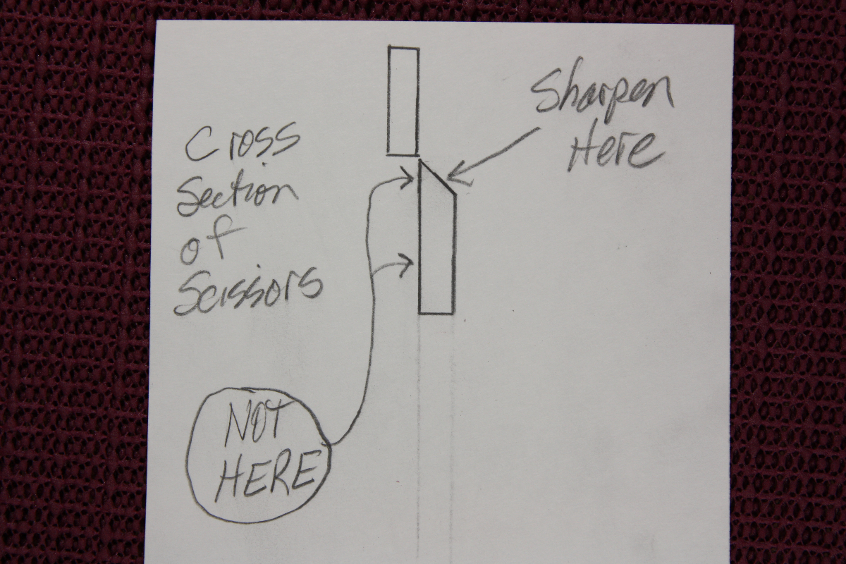

Steve, just a suggestion. If you can take the blades of the scissors apart that's good, if you can't, put scissors in a vice lightly with cutting edge up and determine the edge angle and put a stone to the edge. You have good visuals and control that way.
Lots of light and a visor lens are a big help. Also, in your case a practice pair can be life saving.

Just remember you only sharpen one side on the scissors, they are a single bevel tool. I've seen folks try to sharpen scissors and hedge clippers like a knife or ax, on both sides, and ruin them, Joe.

Yup. That's why I knew my Lansky Turn Box wouldn't work.rarefish383 wrote:Just remember you only sharpen one side on the scissors, they are a single bevel tool. I've seen folks try to sharpen scissors and hedge clippers like a knife or ax, on both sides, and ruin them, Joe.
Great reminder!

The above method is more than a suggestion, this is the only way you can do it. My wife has cut hair for more than 40 years, and buys only the finest Japanese or German hair cutting scissors that cost $100-$150 each. They will last a long time and can be sharpened many many times if done correctly. If you ever cut sandpaper or steel wool, then that scissors will not be useful for cutting anything else. I use diamond stones on scissors and then hone with an ultra fine stone. There are lots of sharpening services that cater to hair cutting salons and barber shops, and most will do an excellent job. But if you can sharpen a knife, then you can sharpen a scissors.FRJ wrote:Steve, just a suggestion. If you can take the blades of the scissors apart that's good, if you can't, put scissors in a vice lightly with cutting edge up and determine the edge angle and put a stone to the edge. You have good visuals and control that way.

A picture is worth a thousand words. I don't know how many pair of good hedge shears I've seen ruined because someone sharpened both sides. I try to explain that's why they call them shears, they are single bevel. If you cut a double bevel on them the blades will spread apart as they close. Sorry for preaching to the choir, Joe.OLDE CUTLER wrote:The above method is more than a suggestion, this is the only way you can do it. My wife has cut hair for more than 40 years, and buys only the finest Japanese or German hair cutting scissors that cost $100-$150 each. They will last a long time and can be sharpened many many times if done correctly. If you ever cut sandpaper or steel wool, then that scissors will not be useful for cutting anything else. I use diamond stones on scissors and then hone with an ultra fine stone. There are lots of sharpening services that cater to hair cutting salons and barber shops, and most will do an excellent job. But if you can sharpen a knife, then you can sharpen a scissors.FRJ wrote:Steve, just a suggestion. If you can take the blades of the scissors apart that's good, if you can't, put scissors in a vice lightly with cutting edge up and determine the edge angle and put a stone to the edge. You have good visuals and control that way.
