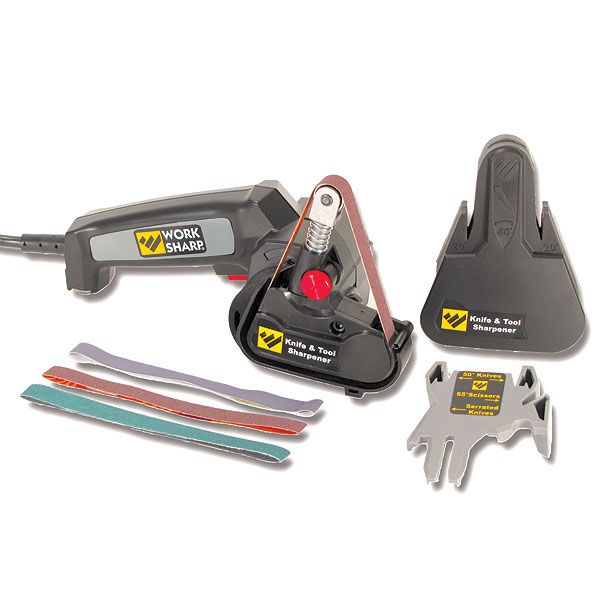

For scissors and kitchen knives, I use the Work Sharp. Works great, just not for pocket knives.
