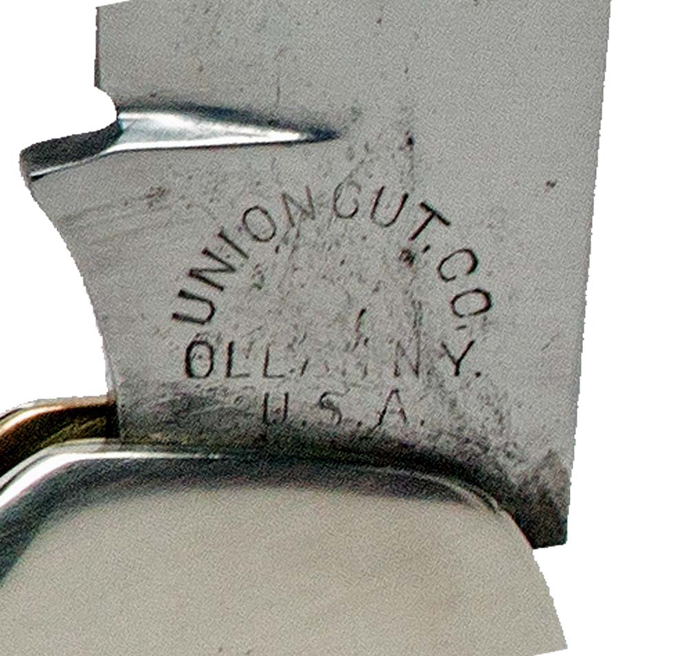

You are most welcome. I'm fine with being called Ralph. I'm a novice Union collector in terms of knowledge, but I really like the old knives they are very well made (IMO). Here is an arch stamped Union that I managed to run across. Maybe peanut740, btrwtr, ea42, or lt will see this and be able to share their knowledge.

Union Knife Works is not to be confused with Union Cutlery Co, they were not related firms. Union Knife Works was a Platts venture in Union, N.Y. and they are marked NYC because that is where their sales offices were. Union Knife Works is a fairly rare mark as the company was only in business for a short time, Goins says 1911-1913. They are also quality knives as were most made by the Platts family.

Just to set things straight regarding Union Cut/KA-BAR. The famous KA-BAR brand began in 1923. The Union Cut mark on KA-BAR knives was discontinued on most knives by around 1942-43 and the knives will still have KA-BAR in caps but over Olean, NY. Around 1947-48 the mark changed again to KA-BAR caps over USA and in 1952 it changed again to Kabar, italicized letters with no hyphen. Model numbers were added to the blades when Cole National bought KA-BAR Cutlery Co in 1966 and the mark was still Kabar lower case italicized letters. The KA-BAR stamp chart on this site and the one put out by the old KA-BAR Collector's Club has many many errors in it. The Queen made KA-BAR Club knives will sometimes have a Union Cut mark on them but they are not the same quality as the original Union Cut knives and are easy to tell the difference on. The quality of the knives also declined when KA-BAR/Union Cut went into military production mode and the stamp changed to KA-BAR over Olean, NY. The military knives were of excellent quality but the civilian hunting and pocket knife quality definitely declined in this era.
Regardless, the OP knife was made in Union, NY by Union Knife Works which was not in any way related to the Union Cutlery Co. in Olean, NY. Union Knife works was a shirt lived company started and run by Platts family members.
