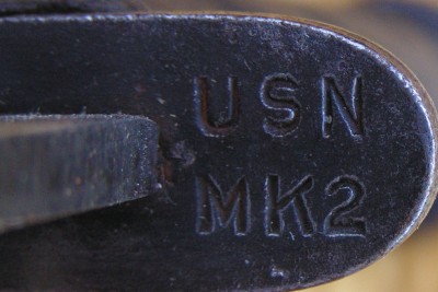

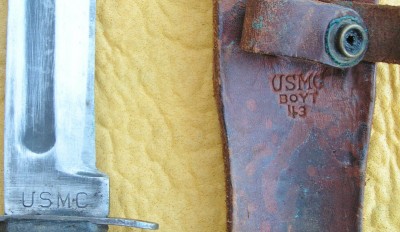

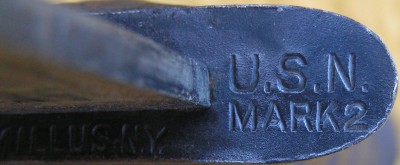

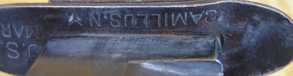

Are you wanting a Kabar Kabar, or do you want any WW2 1219C2/USN MK2 knife? The knives are the same. The only difference is whether they are stamped USMC or USN-MK2.
The question is not as facetious as it sounds.
If any old WW2 1219C2/USN MK2 will do, there are lots of them available, especially on fleabay.
If you are looking at just Kabar Kabars, we still have a question to answer ---
Do you want a 1219C2 (USMC version) or a USN-MK2 (Navy version)? If so, your available options are more restricted.
There were 4 companies that made some version of the knives during WW2- Kabar, Camillus, PAL and Robeson-Suredge. Camillus made the most, Kabar the second most and PAL and R-S made a token number by comparison. Boker had a contract but never made any.
One way to tell the WW2 versions is if they are guard stamped and mainly show up with thin (1/4") thick pommels that are through-pinned (the pin shows on both sides. Those were only made in 1944 and 1945.
The 1943 and early 1944 versions had thicker (3/8") pommels and were peened on only. The first ones had round tang stems peened at the pommel and the latter-half 1943s had square tang stems peened at the pommel.
If you see a thick (3/8") pommel Kabar that is blind-pinned (pin is visible on only 1 side) and unpeened, it is a reproduction/post-1976 version.
Another tell is to look at the stamp. The ricasso stamped Kabars used a font that has very thin strokes of the letter segments and the stamp is relatively shallow. The post-1976 Kabars have stamps that are both fairly deep and have broader letter segments.
Camillus versions come in 3 flavors - WW2, VN and post-contract loss versions. Stamp and construction difference used to tell which is which.
Then there are the non-Camillus VN versions, Conetta and Utica. And then there are the post-VN versions - MSI and Ontario.
And then there are the non-contract post-VN versions - Kabar, Imperial, and Case

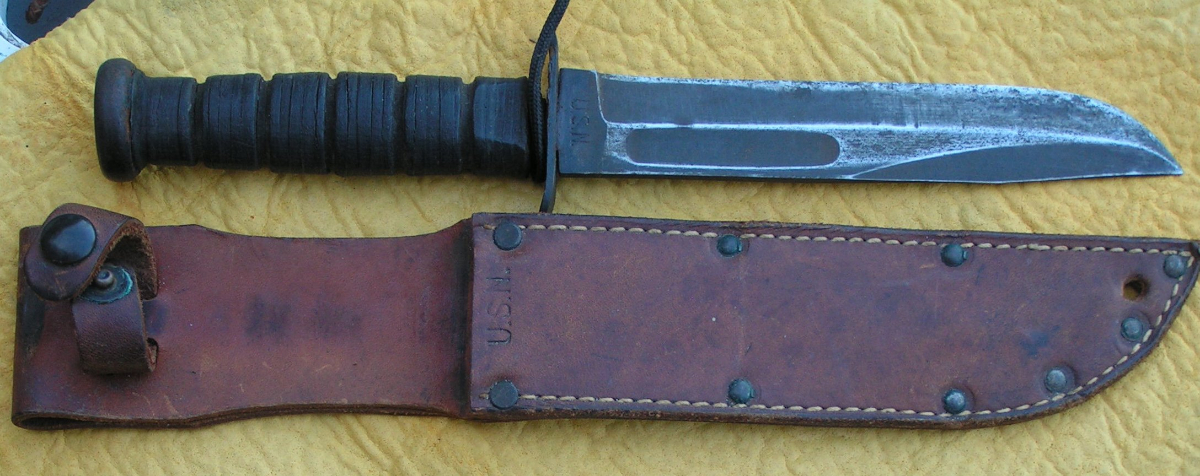

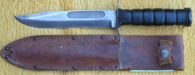

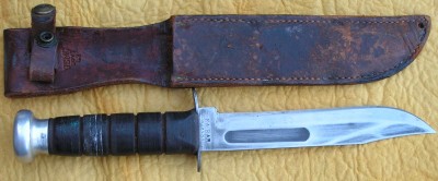

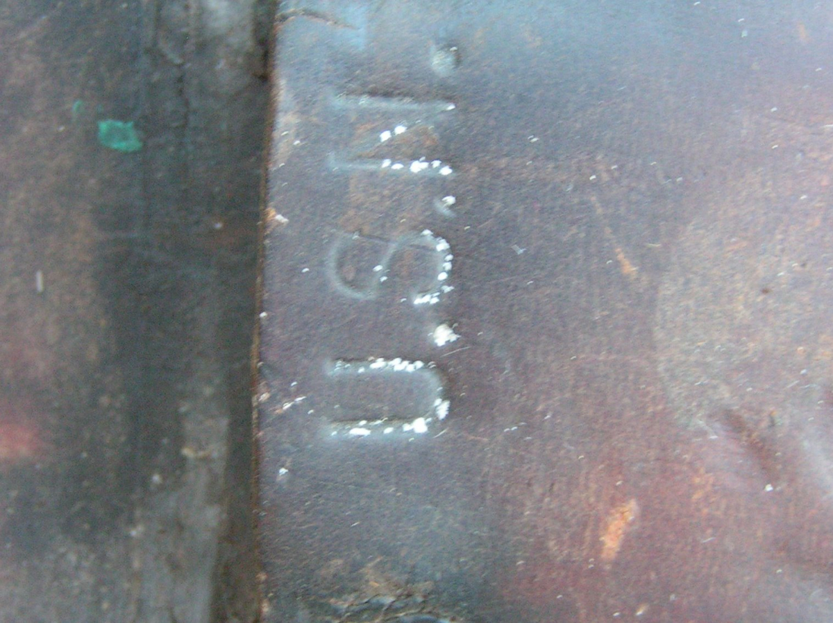

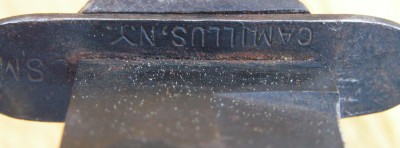

If and when you find one that pleases you you have only just began. I would suggest you attempt to find one that is still in its marked 43 Boyt sheath. Here is a Carte Blanche of I think all WWII MK II's there are a couple that are wrong that I missed when I acquired them and that is why I tell people when they find mil. knives and sheaths they have most probably a pommel strap or leather ring or something that someone needs to make a correct knife. All the different ones are great, I like the Pal the best with the UTICA coming next just because they were hardest to get. You did not say but your first marked KA BAR and marked sheath make you feel like you accomplished something. I do have a round tang pre 43 but it needs some rescue work. I have not been able to track down the MCmann sheath from Portland Or, for being a period piece. The are several versions of the hard sheath which are very nice also..

The Utica is not a WW2 knife. I don't know what you are showing with that aluminum pommel but it is not an original on a WW2 MK2.
- Posts: 2484
- Joined: Sun Oct 09, 2005 11:50 pm
- Location: S.W. Wa.
Re: how to know a WWII KABAR?
You are absolutely correct and that is what I was speaking to earlier. No matter how hard you try one sneaks thru the cracks.
What makes the pommel really wrong was it is on a USMC marked KA-BAR. I just hope that enough is left of the tang to take a correct pommel. In fact you are technically correct about the Utica with only the US above the maker mark they were not issued until some time before or during Korea, they were used then and in Viet Nam.
Thanks for the heads up. The rest of the field repair is the first three or four photos that the wrong pommel is on.

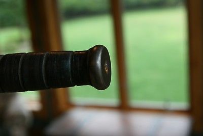

Hi everyone. This is my first time putting a message on this forum. I realize this is someone else's thread but I was wondering if I post some pics of a knife, could you guys identify it?
I just bought it off ebay thinking it's from WW2, definitely hoping it is. It as the Olean, NY and ka-bar marks, along with USMC. It also has an old leather sheath with boyt 43 and usmc on it. I have the ebay pics now, but can take greater detailed one in two days when it arrives at my doorstep. Hopefully that's okay, let me know if I can post them.

Thanks for the warm welcome! I'll post the pictures I have from ebay (knife still has another day or two before it gets to my house), but I can post higher quality pics one I snag it up. I really hope I did enough research to get a legit knife made in wartime. Thanks everyone for your time!

As you have read I am susceptible to being wrong. It does appear to me as being a correct Marine KA-BAR. With the screw on pommel the indications are that it is an early one. The sheath looks correct to me. We shall see if I am full of it or not this time. Whether it is 100% or not you still have a knife that is highly desirable. Good catch.

Yes, it is a WW2 Kabar 1219C2. Thin font on USMC stamp, Thick (3/8") peened on pommel. Leather sheath is correct.
Its an early version, probably 2nd or 3rd production run. First run had red spacers. 2nd run and later had black spacers. Later versions had a rectangular peened tang on the pommel end.
While some Marines may have had the USN-MK2 fiberglass sheaths by trade, snitch, or purchase from a sailor, but officially, 1219C2s only had leather sheaths. Marine Supply Centers only ordered leather sheaths.
That does NOT mean the USMC marked 1219C2s were only issued to Marines or that USN-MK2s were only issued to sailors. All knives and all sheaths went into the Navy supply system FFT to Navy or Marine supply CENTERS.
Marine centers would order XXX knives and XXX leather sheaths. Navy supply centers would order XXX knives and XXX fiberglass sheaths. The Navy Supply DEPOTS would ship XXX knives and requested sheaths to the ordering Center.
The Depot personnel didn't give 2 rats' behinds as to what the knives were that they shipped. Whether they were stamped to be 1219Cs or USN-MK2s, the Navy considered them the same knives. When the Depots received the knives, all cases of knives were stacked together. Marine Supply Centers might receive USMC marked knives or USN-MK2 marked knives or both. Ditto for Navy Supply Centers.
That means while not "officially" correct by some "purists" attitudes, a 1219C2 in a fiberglass sheath or a USN-MK2 in a leather sheath, and vice versa, is still correct. Especially since the USN-MK2s were issued with leather sheaths from the initial USN-MK2 shipment by Camillus in January 1943 until the fiberglass sheaths started being produced in November 1943.

So I just got my Kabar! I'm so excited.. First one ever. I do have a question though. The sheath looks like it says boyt 43, but I remember reading somewhere that there's supposed to be 9 rivets on the back of the sheath and those that have 6 or 7 are newer. It looks like this only has 7, but perhaps they're just worn out. Can you guys still check to make sure the sheath is also legitimate? Thank you. I will attach some others pictures too, just out of excitement of course.
EDIT:
Sorry, I was too hasty. Upon further inspection I think I see the other two at the top, they just aren't green anymore. I'll still leave the pictures up just in case, or for entertainment. Thanks everyone. Feel welcome to post yours too, I love looking at them.
EDIT:
