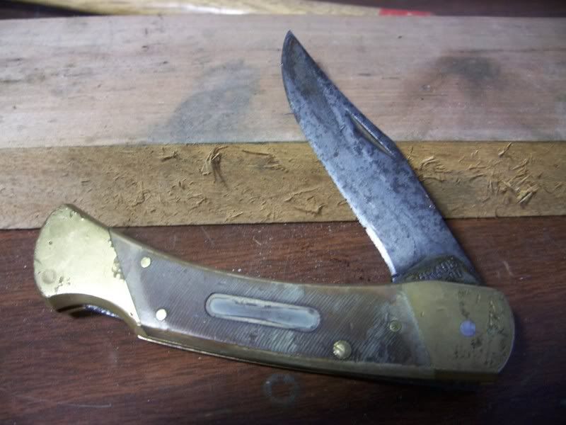

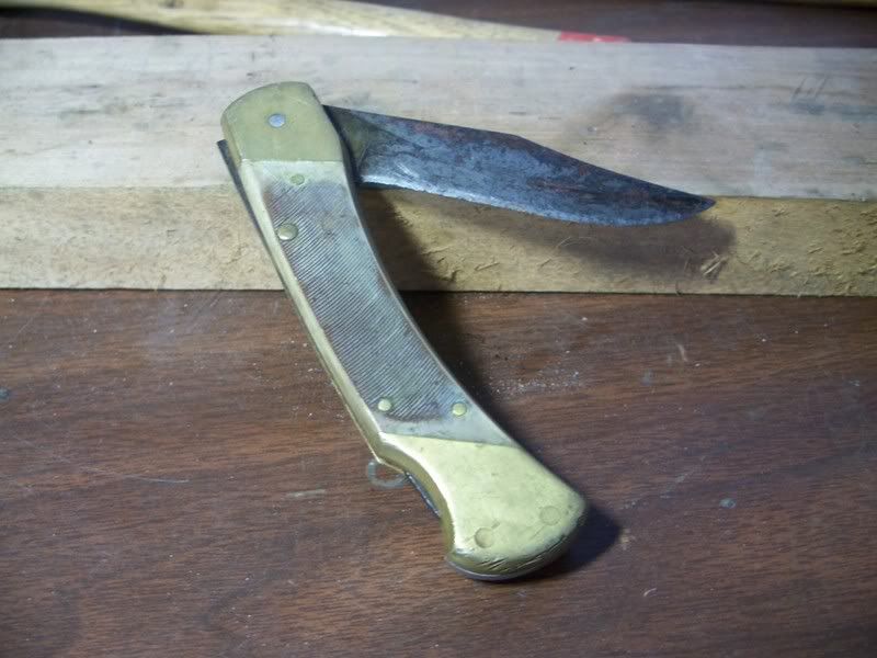

Here is a trashed 7Ot I bought a while back for $3 at a flea market. The nice thing is this one is 1095, not the usual schrade+ stainless steel (which I am not a fan of) but a result of that was a rusted and pitted blade. Other problems included battered brass, broken spring ect.
Here is what it looked like before

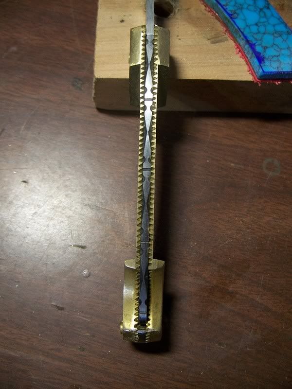

I had went ahead and reground the brass to remove all the bad dings, so I decided since I was doing this much work to it I might aswell go all out, I serrated the liners and did an arrowhead pattern on the lock bar.
