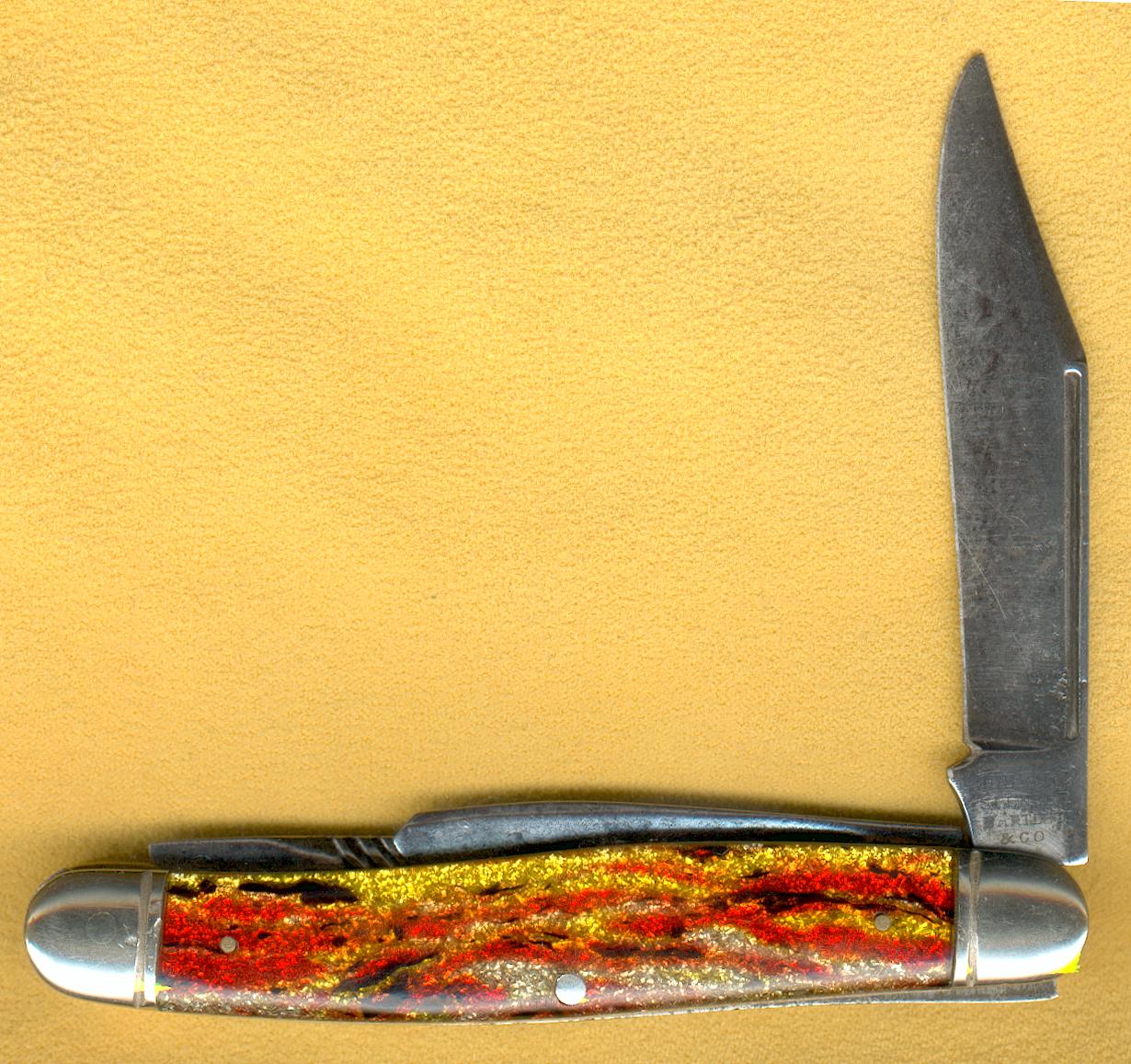

A fellow on the"other" forum sent me this knife for an opinion (like I'm an expert or something :shock: ) as to its authenticity etc. The exercise was such fun, I thought I'd share it with you appreciators of older knives!

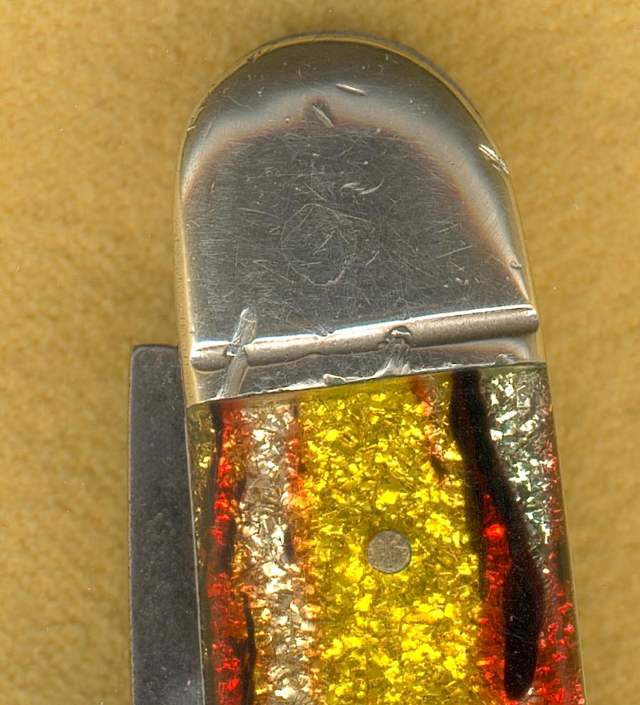

It is stamped Hibbard Spencer Bartlett Co. and has Christmas Tree (CT) celluloid handles. Looking at the outside, I noticed the main backspring pin didn't match the liners, or the handle pins, so right away, it looks like a re-pin or a re-handle. American knives, with few exceptions, will match the pins and liners. Nickel with nickel, and brass with brass.
Looking inside (sorry I couldn't get a pic of this) I see signs of holes, filled, where a shield would be, so it looks more like a rehandle. Then some marring on the bolsters doesn't match the handles, so this confirms new Cell handles. Those marks would surely have damaged the cell also.

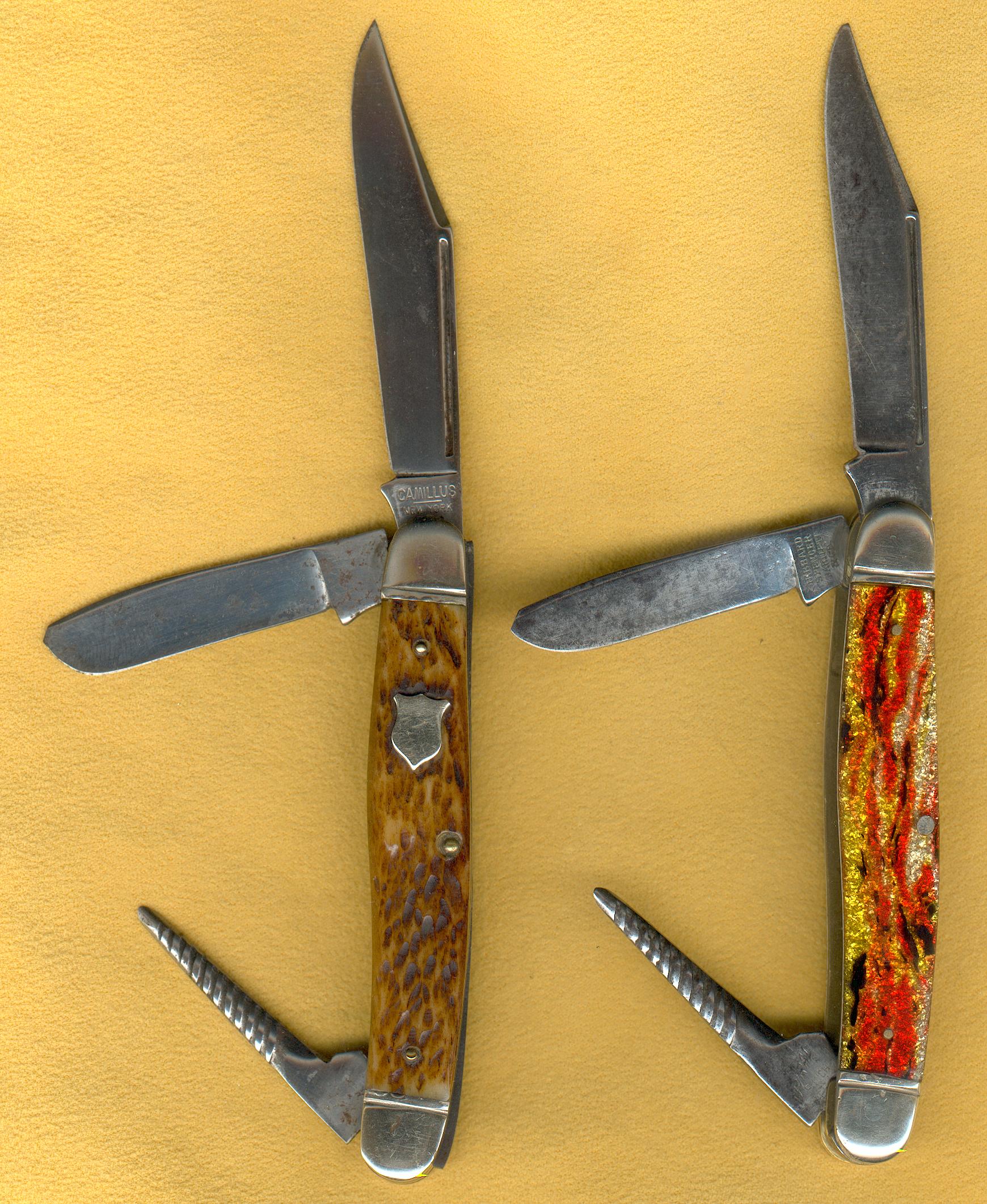

The punch looks like a Camillus, so I looked in my meager stash of Camillus knives, and lucked out, as you can see. Camillus is known to have made knives for HSB. I've never seen CT on either, but I certainly haven't seen them all.
Verdict: Made by Camillus, and re-handled. Otherwise, a good old, solid snappy knife!!

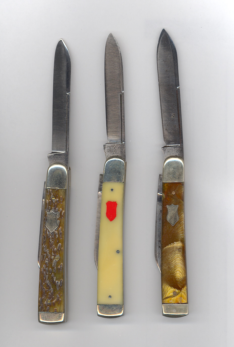

You always start some good subjects for discussion. Often they make me go to my collection and get reaquainted, this was no exception. I am posting, just as information, three antique Schatt & Morgans, not doctors knives as some people call them but congress jacks as Levin calls them. All have brass liners. The brown celluloid and the bone have brass pins while the red shield has NS pins.
I have a dozen or so old Schatt pearl handled knives, all but two have brass liners and NS pins, the other two are fancy with NS liners and pins. I have also noticed that some of the old stag handles knives have brass liners and NS pins.
So maybe there are no rules here but thanks for getting me back to my collection on a pleasent Sunday afternoonhere in Georgia.

I guess there are a lot of exceptions on the pin thing. I go by the knives I collect, and Case and Schrade tended to keep that "matching" tradition. Most of my Empires are matched as well.
