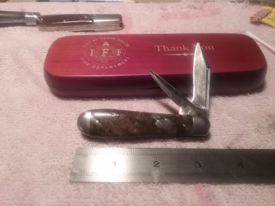

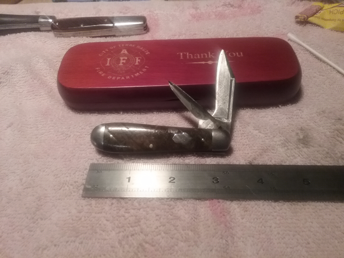

I picked this one up at a flea market this last weekend.
I'm trying to figure out the pattern number and the name of the pyremite covers (brown pearl, brown agate ??).
Remington teardrop harness jack. Main blade is clip, secondary blade is punch.
3 3/8 closed
Acorn shield
3 3/8 closed
Acorn shield

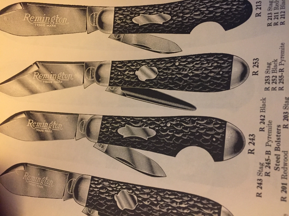

Looks like a R255-r according to the Remington C-5 catalog.

The books list an R255 as 3 5/8, mine is 3 3/8. What does your catalog say?

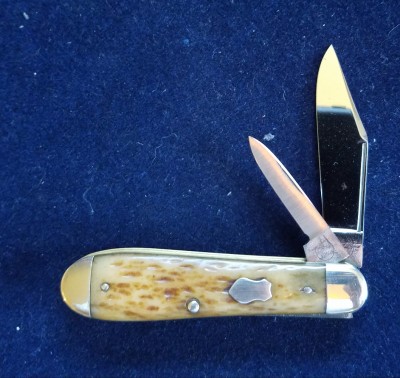

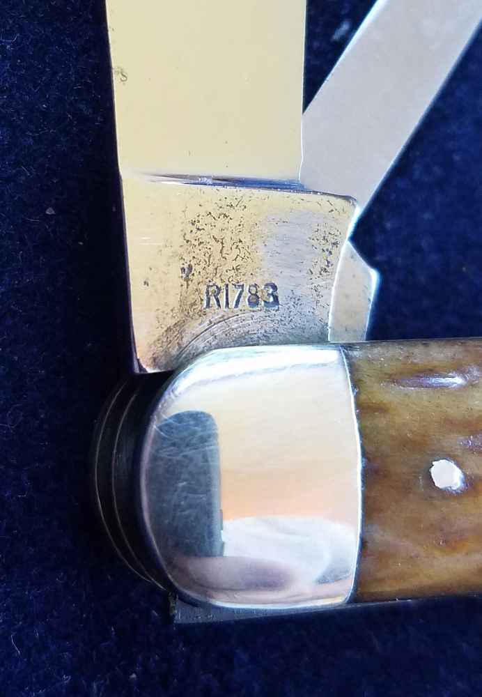

Edge213. I think you need to think of your knife being 3 1/2 inches long. I struggle that the precise measurements of knives don't actually match the book. This is a R1783. Book says it is 3 1/2. Actually is 3 3/8. I didn't find your knife in the short time I looked but maybe that will help you find it in your books.

David, I would like to toss my 2 cents in the pot if your ok with that...
The Remington catalogs # 1 (1921) and the C-5 catalog (1930) list your knife as the R255-R with (pyremite scales).
It's length is 3 5/8 inches closed.
I find the most intrigue in reading the catalogs and understanding that the catalogs we have are guides/illustrations and never state having complete illustrations of "all" the knives Remington offered. On the contrary the disclaimer is, "This, the first issue of a Remington Cutlery Catalog does not pretend to illustrate and describe the very complete line of American Pocket Knives which we have planned and prepared to make at the Remington Cutlery Works." Even in our modern Remington catalogs the authors state similarly the same.What I'm trying to convey is that we sometimes get caught up in the absolutes, but these are catalogs that offer a sampling of Remington's cutlery line. Remington stated many times that any catalog could change at a moments notice and considering Remington produced catalogs that spanned several years between each offering things did change. There is ambiguity in Remington's cutlery production, but I think the early production years 1920-1930 are strict and detailed as to the specifics of knife production as clearly stated in their early catalogs and guarantees. As one moves to the 1930's and DuPont's influence on production cost as well as the influence of economic times generated by The Great Depression, one begins to see the vagueness or ambiguous processes in Remington's cutlery production. I do not believe that this disabled the quality or superior craftsmanship of Remington knives but created future voids in the precision of collecting Remington knives. Is your knife a true Remington production knife? Yes! There are many selling points of your knife that would substantiate that claim, with regards to the closed length of 3 3/8 v/s 3 5/8 I think it falls in that void as a transition 1930's production knife based on similar discussions in other posts on the subject. On a humorous note. I don't know why we men get caught up in measuring the length of our knives and miss the importance and enjoyment in the functionality of our knives.
