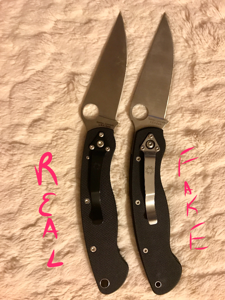

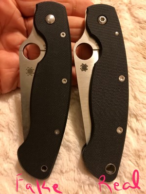

Some while back I bought a "Spyderco" Military from a friend (an honest and honorable guy who'd been taken in himself). I loved the knife. It was very well made, tough, good steel, and held up well to hard use. But one day I hung the pocket clip on something and bent it all to pieces. I even stripped one of the screws on the pocket clip.
So I called up Spyderco and ordered a new clip. Lo and behold the screws were too small. So I called up Spyderco and described my knife and the problem and the guy at the Spyderco outlet told me it was probably an older model of the military ad they no longer stocked the exact screw size.
Next I contacted Spyderco warranty and repair and they confirmed that at some point they had changed the design of the clip and the screw sizes and they could probably modify my knife to take the current set up. So off to Spyderco it went along with a $5 check for return shipping and the clip and screws I had purchased.
A few days later I received a phone call from Spyderco. They informed me that although mine was about the best they'd seen, it was still a fake. Now that will ruin your day right there. They gave me two options. 1) they would send my m knife back to me just like I sent it in. 2) they would keep my knife and destroy it, and sell me the real deal at a 45% discount. According to Spyderco it's worth it to them to get the fakes off the street, and to quote the tech that called me, "we want to take care of you guys." I thought that was a nice touch.
Since I couldn't pass up a deal like that, I bought the new Military straight from the factory. Also, when I informed my friend, he did apologize and gave me another one of the knockoffs which my oldest son now carries like it is a rare treasure.
In the next few posts I'll put up some detailed photos of the real and the fake, including the boxes. Hopefully, this will serve as a good resource for anyone buying a Spyderco in the future. Even if you're buying another model, many of these things hold true across models.

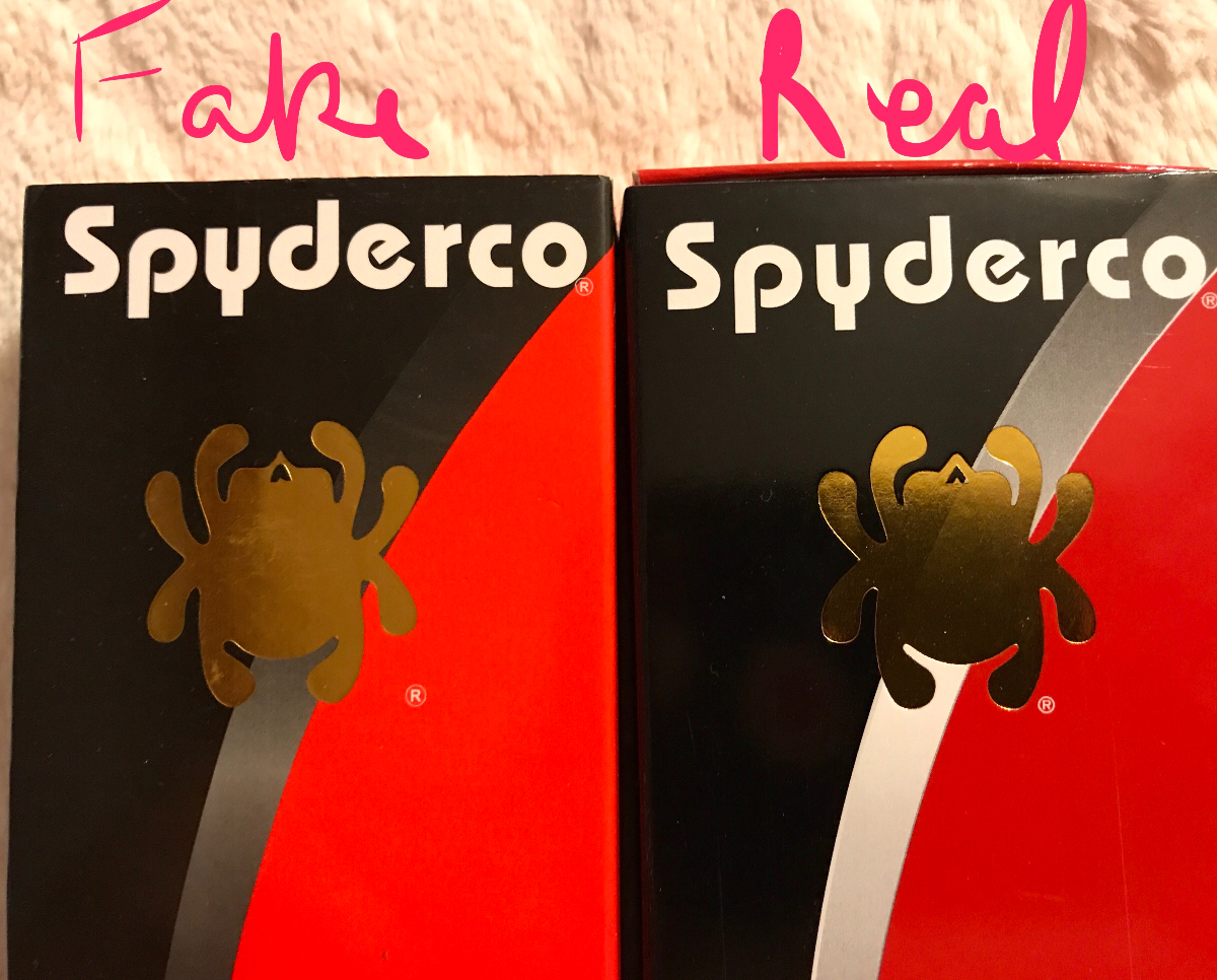

First, let's compare the boxes.
Notice difference in the red and the stripe that goes up the front of the box.
There is a difference also in the font of the writing between the real and the fake. Both the size and the style. Also there are ver subtle differences in the Spyderco on the box. In the fake the mouth comes to a sharper point and the body is a bit larger and more square.

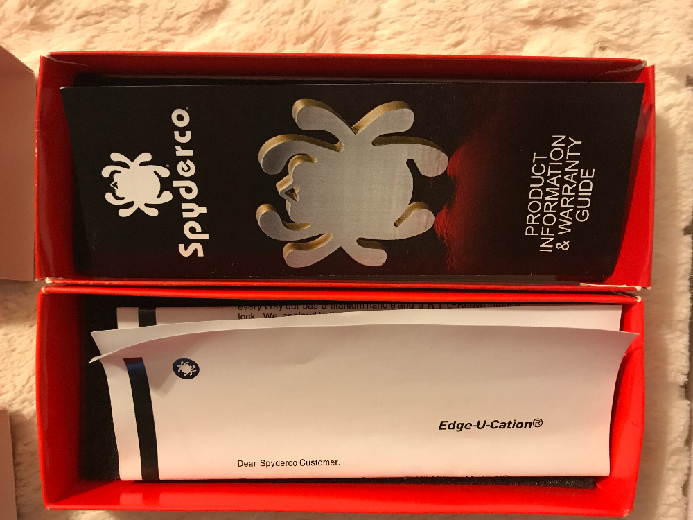

There's also a difference in the paper work that comes in the box.

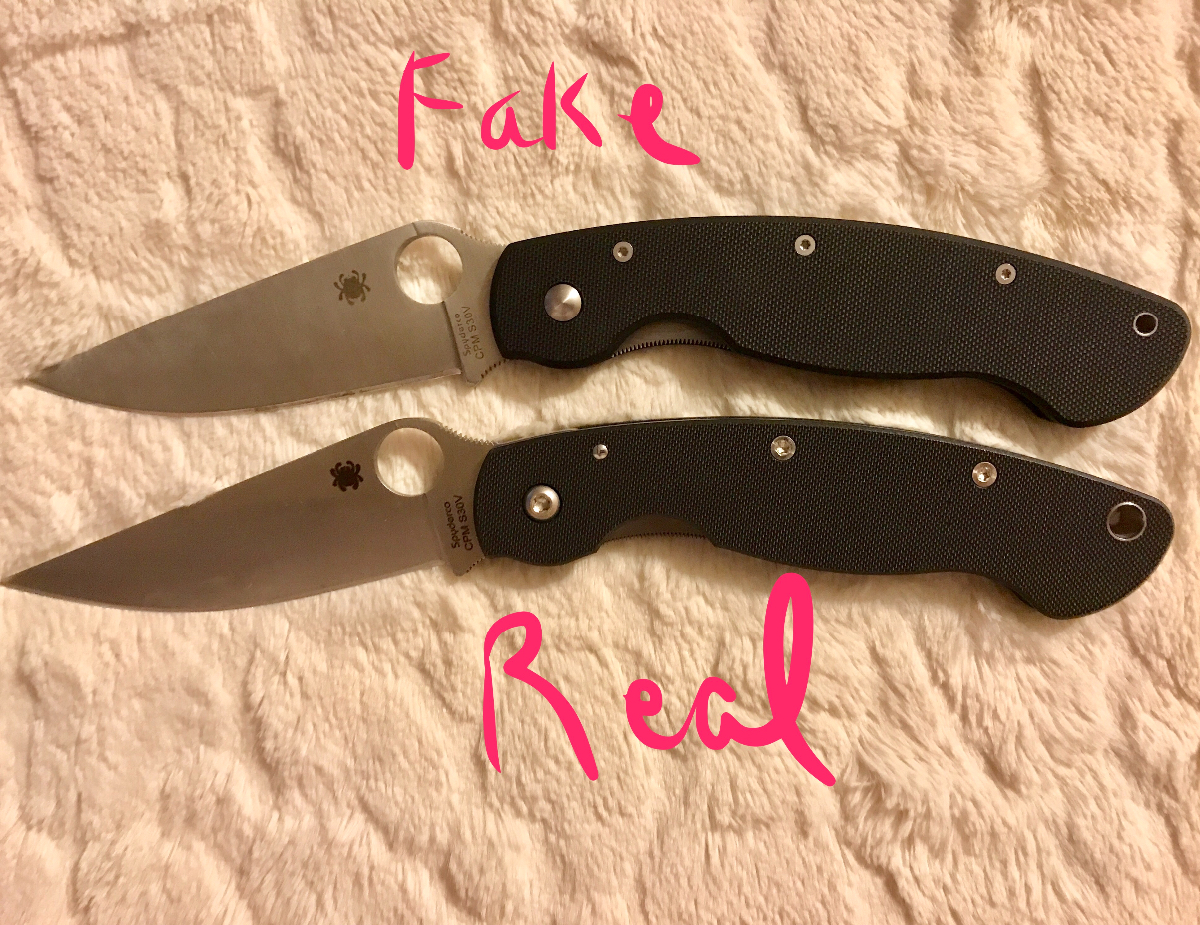

Also notice the difference in lanyard holes. You could drive a Mack truck through the hole on the real knife, but the one on the fake is much smaller.

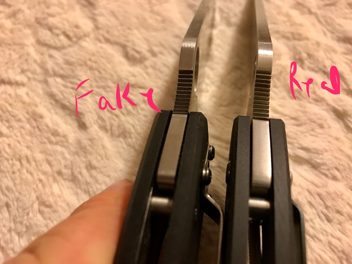

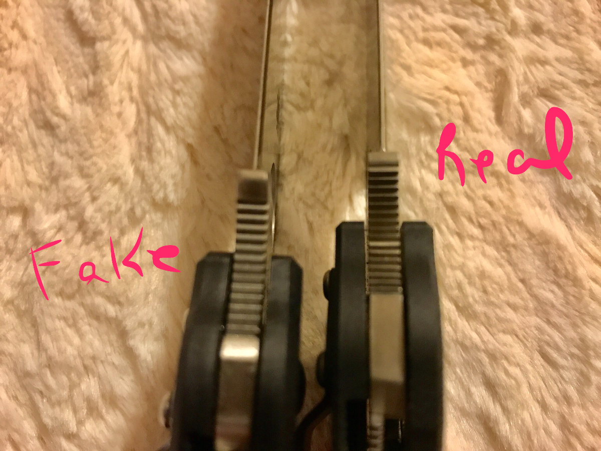

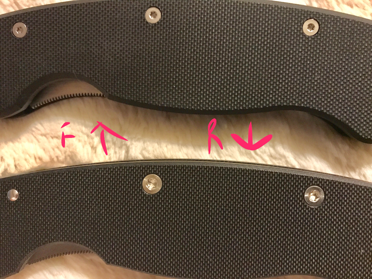

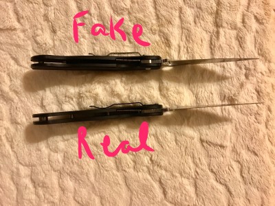

The tang is cut different on the real vs the fake where they meet the liner lock.

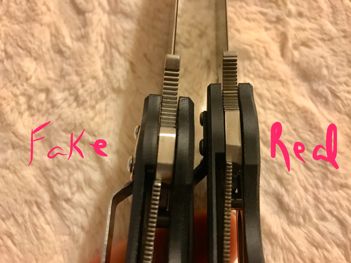

Also, notice the difference in the jimping on the choil. In the fake is is much larger.

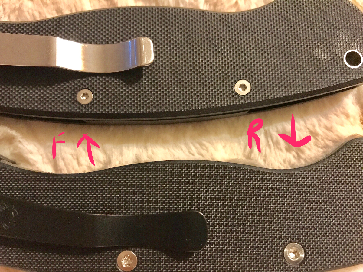

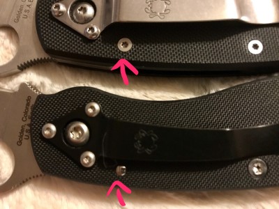

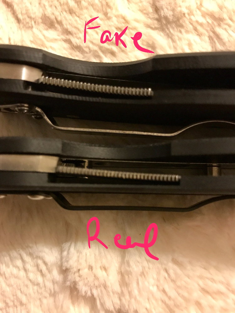

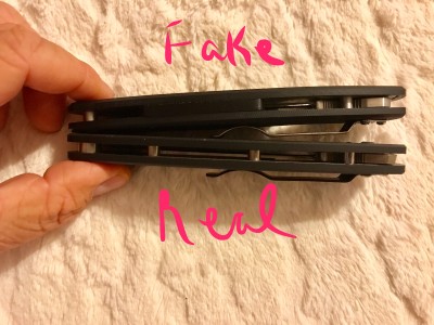

There is a big difference in the G10 that the handles are made of. On the fake the pattern is much more open making it feel smoother. On the real Spyderco the pattern is tighter making it noticeable rougher and more grippy. Also, there is a difference in the screws. On the real Spyderco the screws are real torx screws. On the fake they look similar, but are not real torx screws. The size of the screw heads are also different.
On the real Spyderco the stop for the blade looks like a pin with no screw head. On the fake it has a screw head. Also the blade pivot screw has a head on one side on the fake and both sides on the real.
Also, the liner lock jimping is different. Like on the choil the jumping is larger or more open on the fake and smaller on the real.

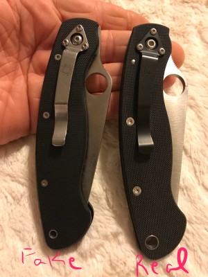

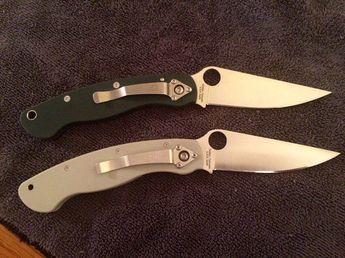

These are very good comparisons Wade, thank you for posting. There's a couple things I would like to add for posterity.
I have included two of my genuine militaries below, one a cruwear steel sprint run (gray) and one a 204p steel sprint run (green). They illustrate some of the recent subtle production changes. There are earlier versions of the military that are more different, but I have no examples of those.
The frame screws have gotten larger and the front most screw has been replaced with a pin. The clip is more rounded near the end on the newer ones. The lanyard holes have gotten larger, the smaller hole on the fake is the same size that was on real ones for a long time until relatively recently.
And lastly the newer ones have a pivot screw on each end, as opposed to the old screw on one side cap on the other.
Another thing about the fakes is they are rarely marked with anything other than s30v steel and the texture of the g10 handle is more smooth than the real deal.

You're right in the texture. I tried to capture that in the photo and describe it, but it's hard to get in a photo.
Thank you for sharing about the lanyard hole. When I bought the fake I looked at a lot of photos on line trying to check it out and it looked real. It was a good fake.
