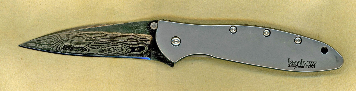

I have a bunch of Kershaw knives. They were our best selling brand in the cutlery store I managed in the 1980s.
I am familiar with the old and the newer Kershaw knives and how they cut and hold an edge.
I have a Damascus Leek that is the sharpest Kershaw I own and one of the sharpest knives I own. The knife is scary sharp, as scary sharp as the BG-42 Buck 110 I got from the Buck Custom Shop. This knife alone made me a believer in Damascus steel!

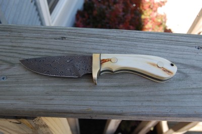

Re: Question about Damascus
If it ain't broke, don't fix it!

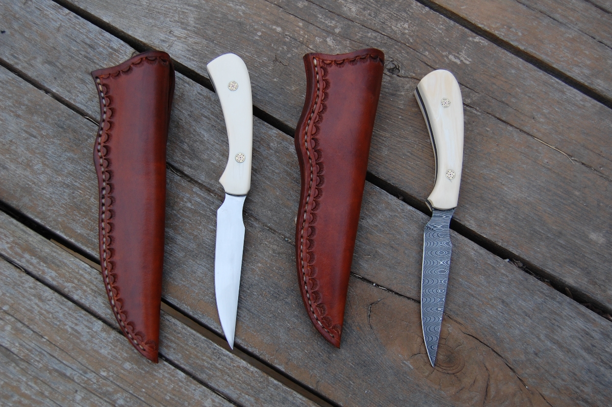

Beautiful knives, Terry.
Grumpy, to answer Your question, if the Damascus is made from high carbon steel, not stainless, it will get a patina on it. Most of the high contrast Damascus I use is made from 1084 and 15n20. The 1084 will get a patina but the 15n20 probably will not because of the high nickel content. The 15n20 doesn't turn blue after etching and will remain silver color. (that is where you get the design from). Hope that makes sense to you.Grump01 wrote:If I may add a question.....I have been wondering if Damascus patinas like or similar to Carbon????
