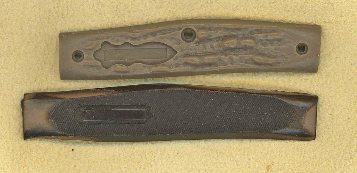

Inletting a shield is more of a challenge than most people thing. If a large company had the automated CAD/CAM machinery to cut these inlays by laser or water jet, one might expect a near perfect fit on all shields. I have been in the Benchmade Factory several years ago and saw the CAD/CAM machinery and the water jet (as I recall) that they used to cut the sheets of steel into blade blanks to get the maximum number of blades from a single sheet. The operator programmed the machine and the robotics did all the actual work. It was fascinating to watch. Of course the machine had to be reprogrammed for each type of blade made.
I suspect Schrade used similar technology to inlet their shields in the Delrin.
Here are a couple Schrade Delrin handles ready for shields.
It is pretty easy to get a perfect fit when you are a large company who has the latest machinery to do precision work.
It is an entirely different story when you are trying to inlay a shield, by hand into uneven material that has varying densities and hardness within the material.
I am not sure the same technology Schrade used on the Delrin could be applied to something like stag or bone.
In addition in order to be financially viable, the batch of handles must be large enough to make the expense of the setup pay for itself. To use that technology for a single knife would be a big time money looser.
