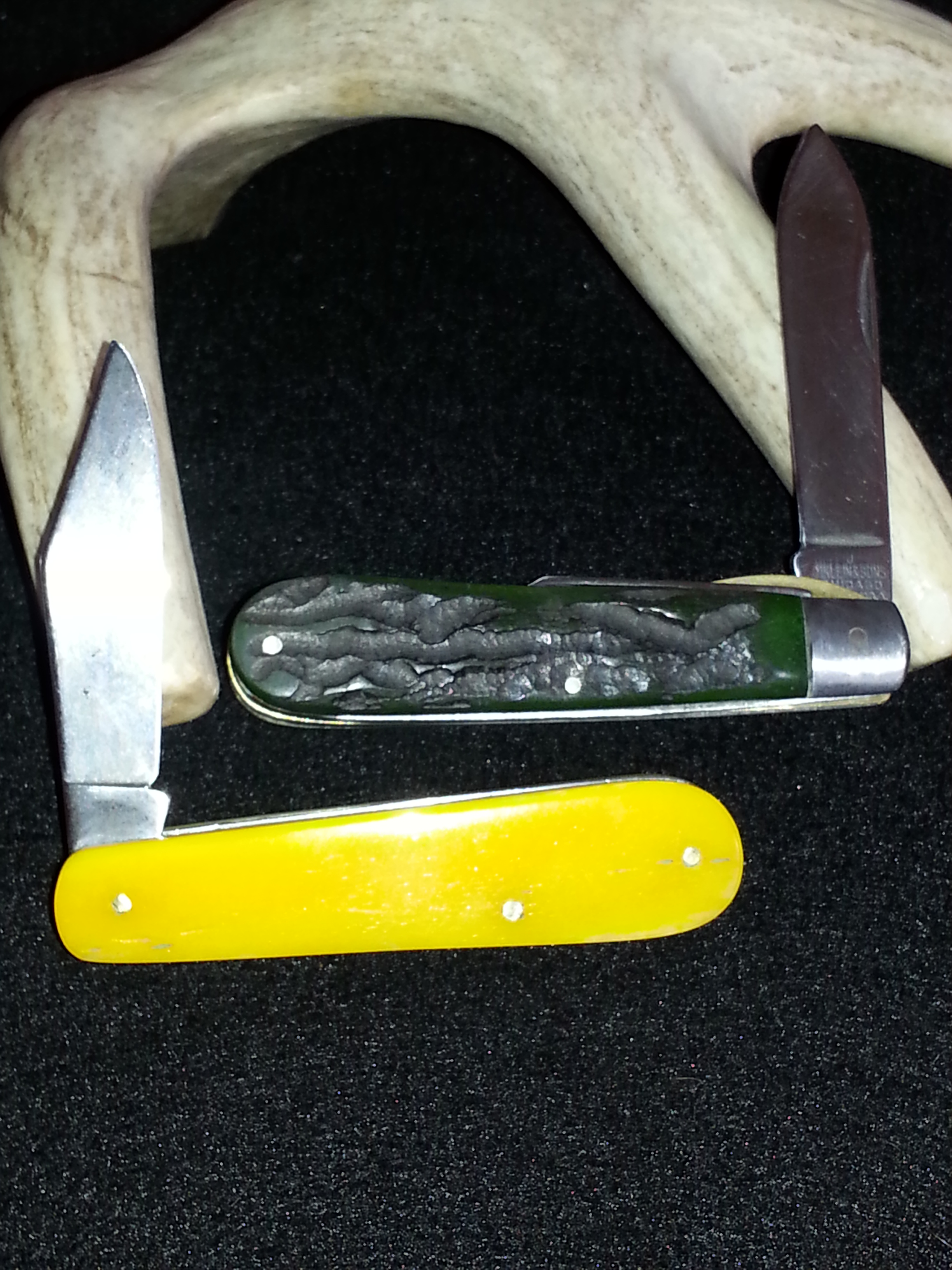

OK be gentle these are the first 2 I have ever even tried. I got a lot more sanding and polishing to go the yellow handled 1 is and old Imperial 2 blade Barlow I got from the flea market for a whopping $2.00 with no handles and the other is a M.Klein & Sons electricians knife I got back when I first got in the trade in 1990 and it was an older knife than as it came from my old journeyman and I don't have any idea how long he had it before me couldn't have been long it was in great shape when I got it, used it till one of the handles broke that didn't take long and been a drawer ever since. tell me what you think and any pointers would be great (I got a thick skin) Robert (sandmak)

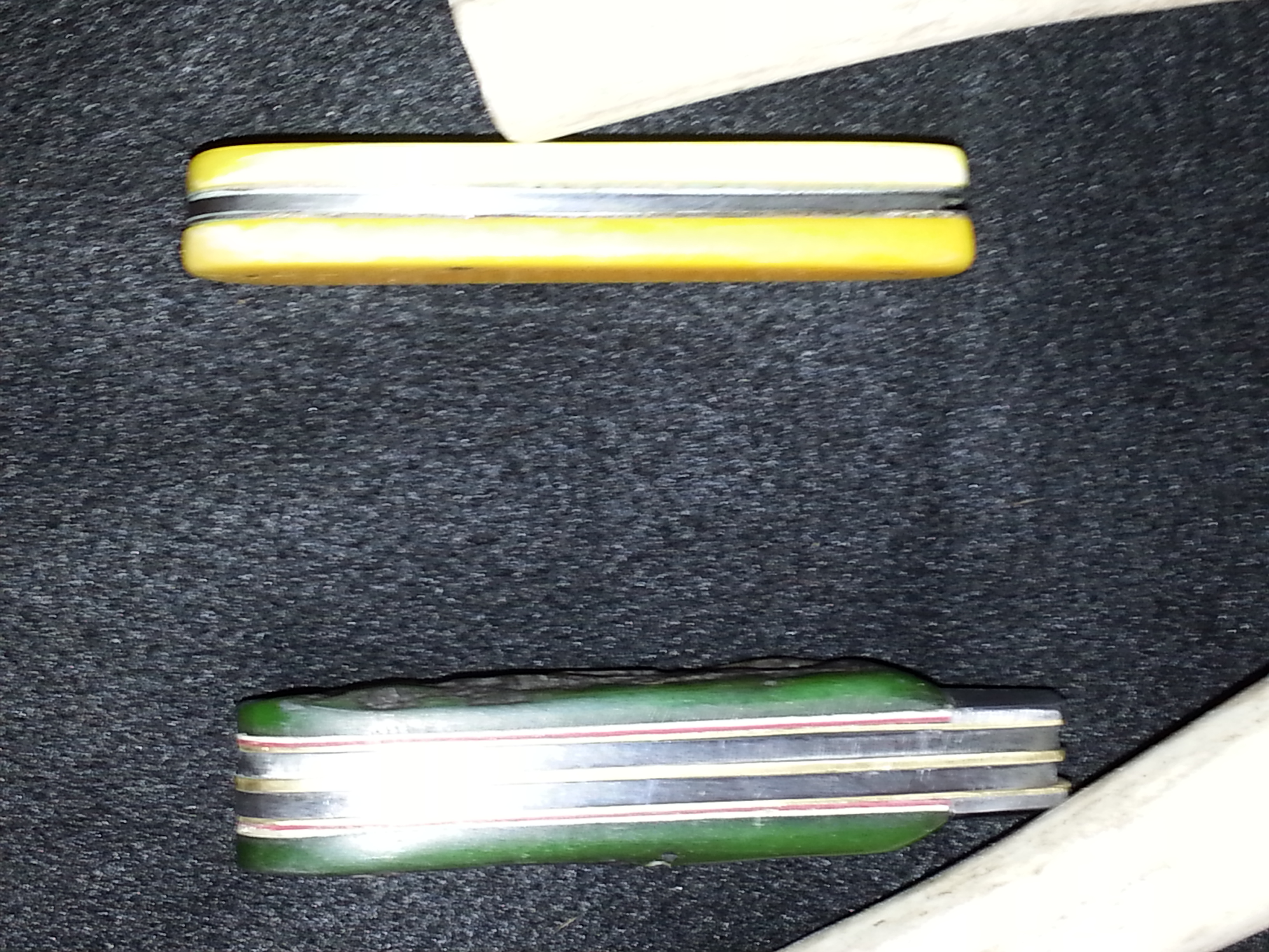

For your first try, I think you did very well!
Now to the gentle critique. Never be afraid to take that bone down some. That yellow one has a good shape, but the covers seem a little thick. You could thin it down some, or even taper things to give it a more round shape so it fits better in the hand.
The green one looks good. Some people like that "fat" look on the covers, but I have never been too much of a fan. If that is the look you are going for, then it worked. If not, then don't be afraid to thin that down some. I see you tapered the jigging around the bolsters. That is what I am talking about. Let the jigging guide how "fat" you want the covers to be, then you can taper them to the bolsters like you did. Hope that makes some sense, and I hope I didn't offend you with my critique. I'm by no means an expert.
BTW, I like that you pinned everything.
Glenn

Glenn said it all. Very good for your first try!

I agree very good for a first attempt!
They look great mechanically; thickness and contours are something you have to develop an eye for, IMO.
You can thin the bone quite a bit and what I like about taking the bone down is the colors that develop an the different depths and the variations of color that show up where the bone changes density.
Great first mods!
Great first mods!

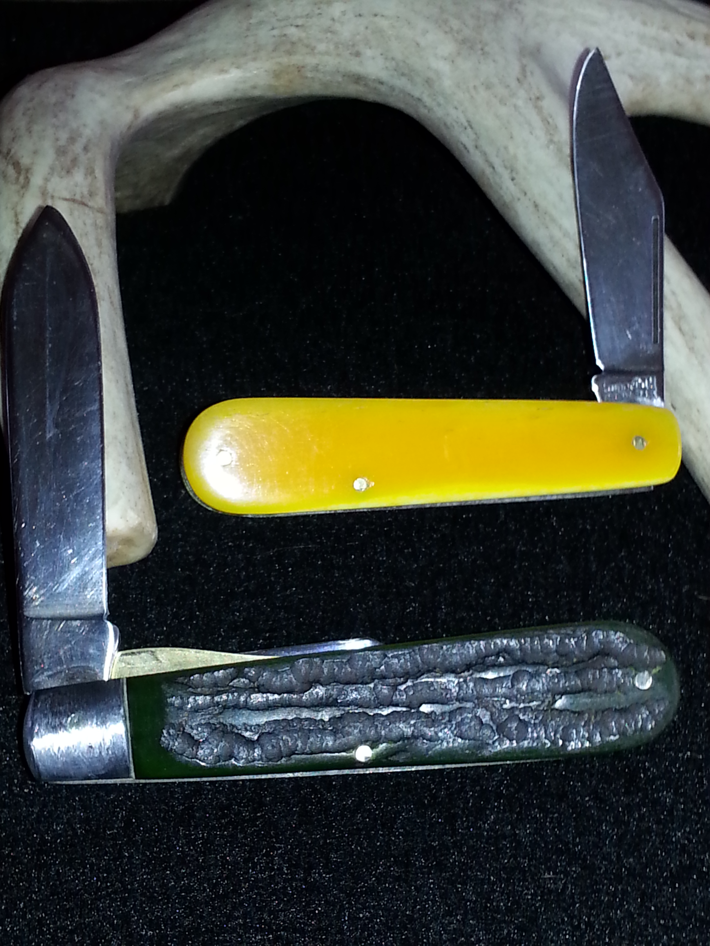

Thanks guys , I will post pics of the finished product in few days after a whole lot of sanding and polishing. I gotta get some tools. Both of these have decent snap on opening however they both need to be pushed closed not like before I took them apart any ideas? Thanks as always ( I think I'm doomed woke up thinking about these darn knives) Robert (sandmak)

Were they opening and closing properly during assembly? I mean when you had everything peened but not finished. Did you use a slackener when peening the pivot/blade pin?
Make sure your knife blades operate smoothly before you finish them. You can tweak the fit of everything while the pins are still peened and proud. If you try to do that after finishing, your pins will sink below the bolster.
Hope that helps.
