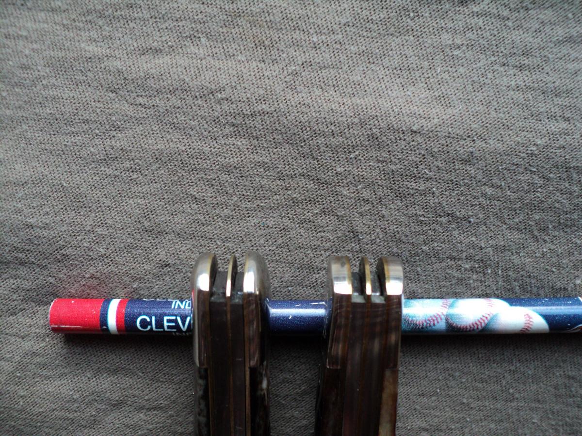

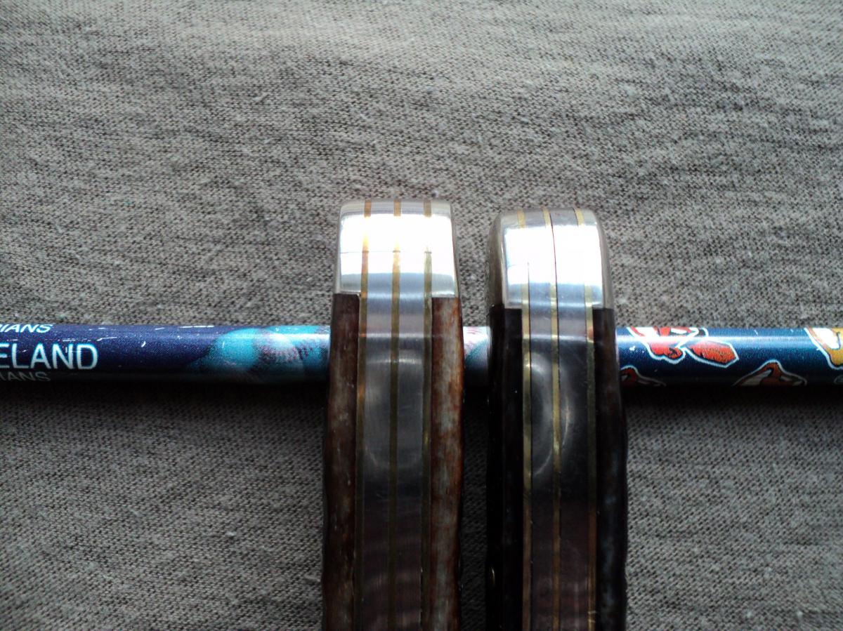

I have a small collection of 1970's Case knives (my "Significant Decade Collection") and all of them are great knives - 1978/1979 included. I have started on a 1980's decade collection and I can see differences in fit and finish (bolsters more squared and bone not as well rounded on the edges, etc.) but the walk and talk is still there (at least in the early 1980's). In sheer numbers of knives I own I skip to the late 1990's up to the current day (only own a few late 1980's/early 1990's) and I find the current fit and finish better than the late 1980's to the early 1990's. In fact some of the Barlow's I have bought from the 2000 decade are as well built as my GEC knives (fit, snap, walk, centering of blades, factory edges of the bolsters and bone handles, etc.) I have several Case knives from the last 15 years that I EDC and they are good knives - I like stainless steel equally well to carbon steel for EDC use, so I don't get too bothered by the CV vs. SS debate (patina's are nice, but not necessary in my view). I think you can buy a current Case knife with confidence - I don't think they will ever be collectors items equal to the 1970's and before, but they are as good a USA made EDC as you can find for the money in today's market. Compare these bone handled Case 6249, a 1978 (stock) and a 1986 (Firefighter); you can see the small touch differences in the 1970's vs. the 1980's - for lack of a better term I would call the mid-1980's knife "blocky". OH
Ps in these pictures, from top to bottom; the 1980s knife is on the top, in the center picture it is on the left, and bottom picture it is on the right.
