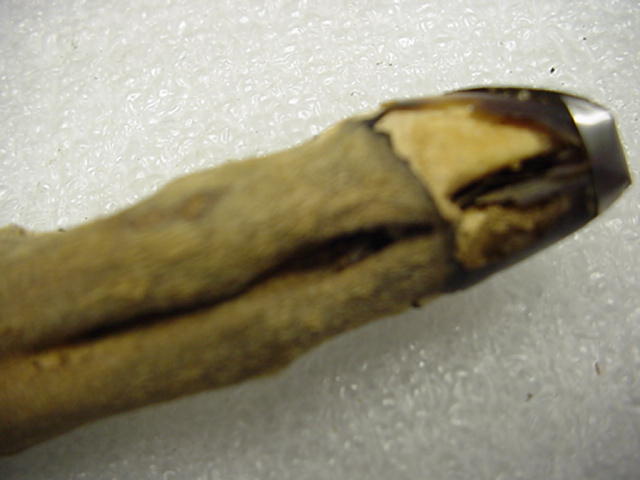

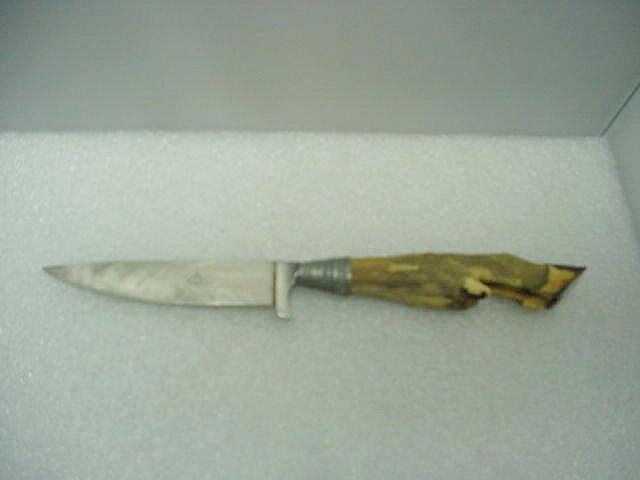

I am willing to bet that knife had a deer foot handle on it before you found itwhitebuffalo58 wrote:Question is, how would the original handle have been attached? The tang doesn't look to be broken off, but it's too short to run all the way through the handle and be peened over. Also no holes for pinning it on. I've never known a factory from those days to glue on handles. Any ideas?
I have had small dirks from the 19th century that had the handles glued on with cutlers glue, Dale has mentioned how well this stuff holds. They glued on MOP, Horn, Ivory and other material in those years.
Modern epoxy will hold very well for you, if it is going to see hard use or you are worried about the epoxy not holding, drill a single hole through the handle and tang in the center and pin it.

Dimitri, I imagine your dead on with the deer hoof handle. The sheath has a fixed (snapless) strap and the knife probably had a ferrule, rather then a guard.(?)
Epoxy sounds like the way to go, but probably in deer antler, rather then deer hoof. I never have cared much for the idea of furry handles on knives!

Me neitherwhitebuffalo58 wrote: I never have cared much for the idea of furry handles on knives!![]()

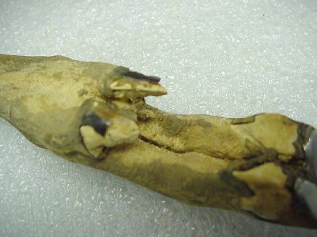

Here is a prime example of what I am talking about, bought this a while back in this condition. The beetle larvae devoured the hair and hoof part and left the bone

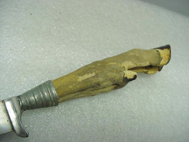

Same as this onewhitebuffalo58 wrote:the knife probably had a ferrule, rather then a guard.(?)

Wow, they do take a toll don't they? That poor handle looks like road kill after the vultures get through with it! It's a shame, the knife looks like a good one otherwise. I do like the ferrule/guard setup on it. I might have to see if I can find one of those. I have the perfect Sambar Stag taper that could be made to fit that ferrule opening just right. Maybe a nickel silver butt cap to finish it off?
