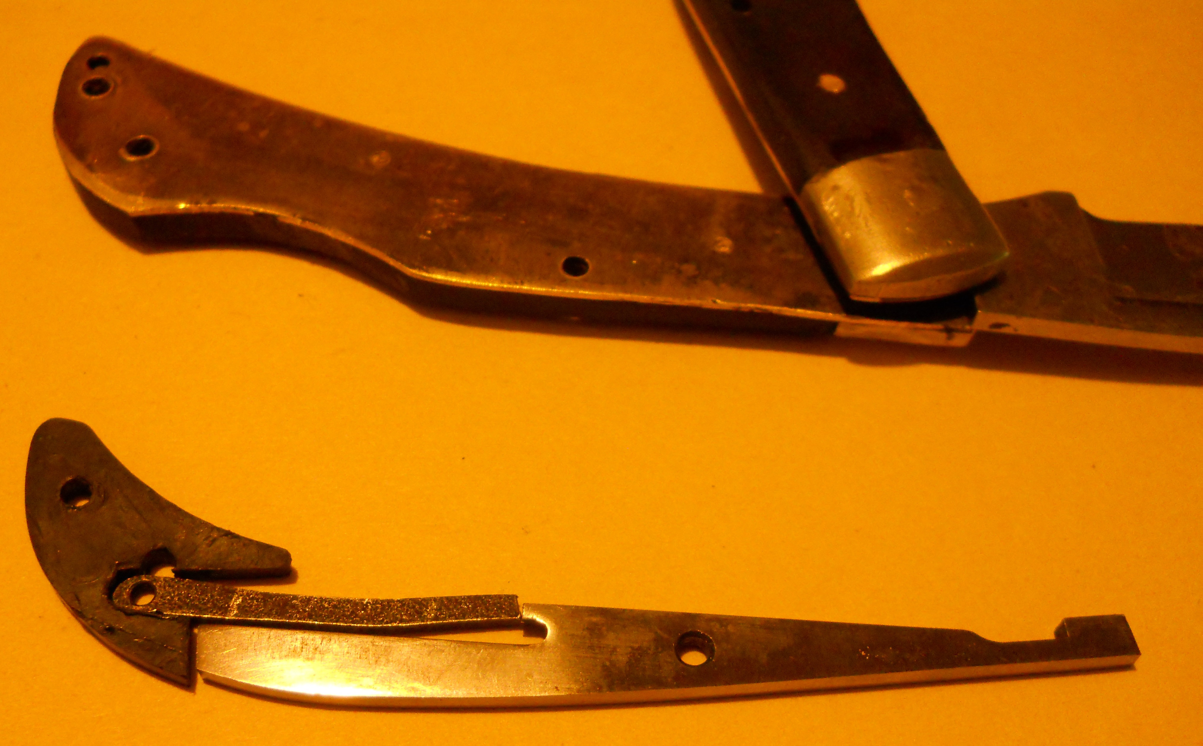

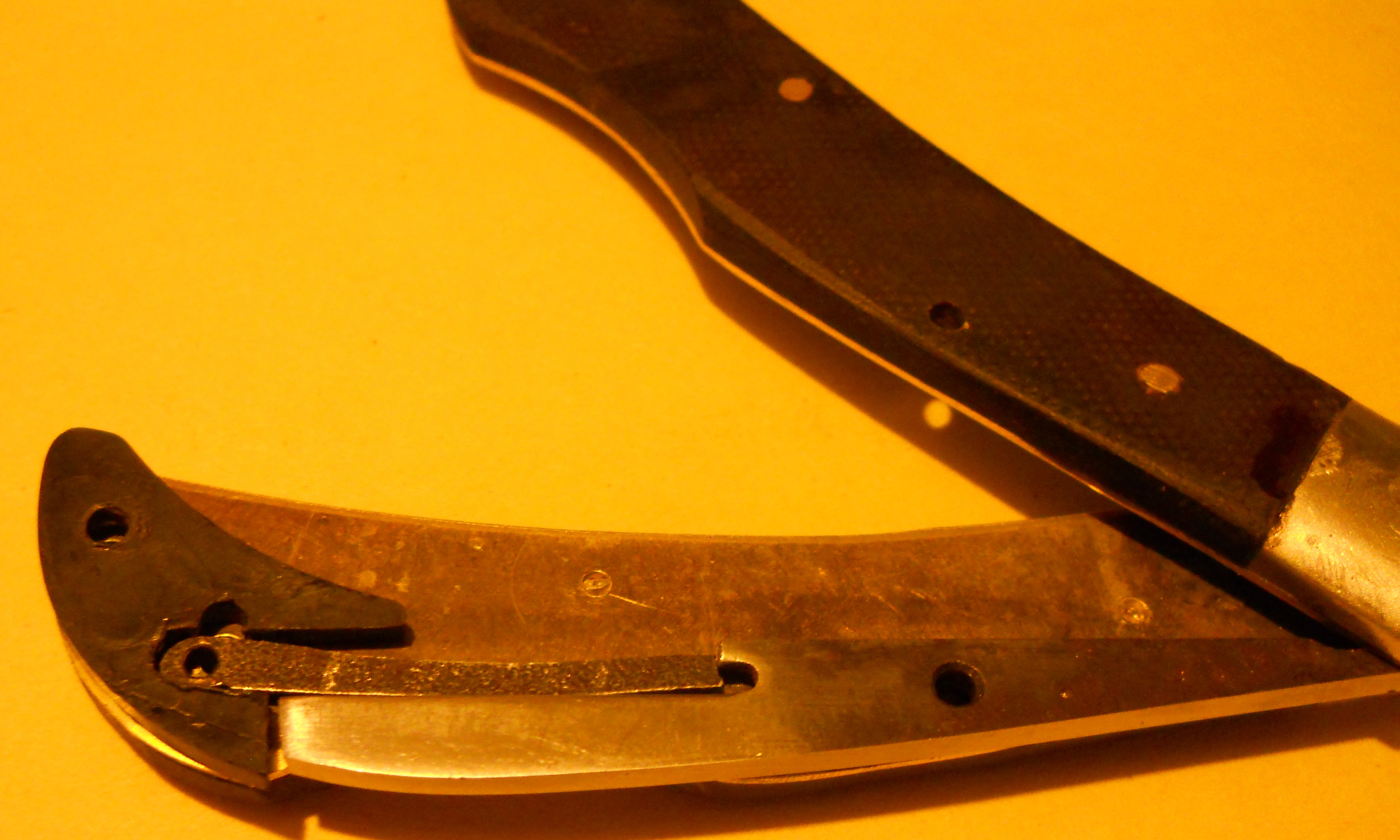

Here is the locking assembly on a Case P1051½ SSP. This is a cheap knife and if you compare it to Dale's pics it has a different mechanism for operation. The tail pc on this is either plastic or fiber. I had never had one of these apart and bought this in a junk box with broken handles on it.I thought this was a cheap opportunity to experiment on. It will have fiber handles when it's done.

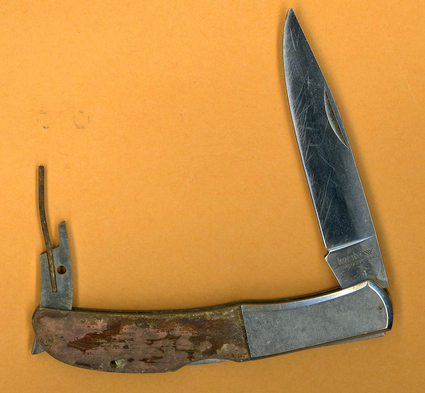

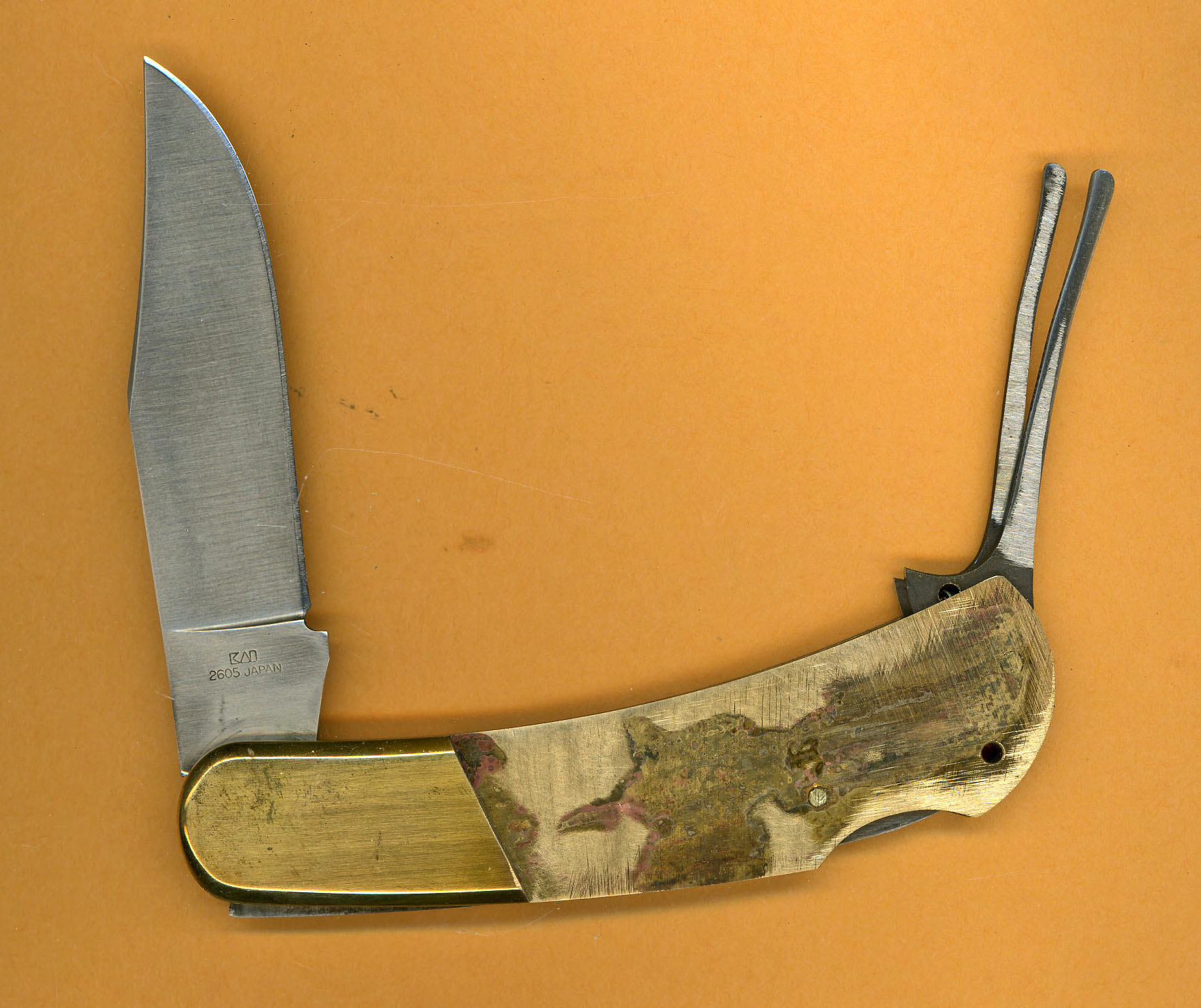

Here is a Kershaw Wiley that is partially apart for new handles.
It uses the two flat springs like Schrade used in later years. At least some of the Kershaw Wild Turkeys used the spacer and bar like the earlier Schrades. The principal is the same in all these locks though the parts & shape varies.
A piece of spring steel (held in place by a spacer or 2 flat pieces) pushes up on the lock bar to engage the locking lug into the lock notch in the round end of the tang.
It might be interesting to see other variations of this principal if anyone has pics or if they discover any new ones in knives they are working on.
