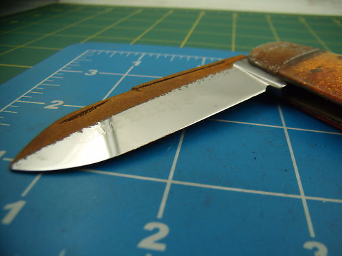

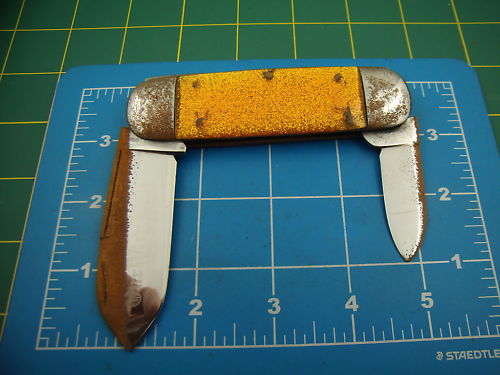

Here are a couple of examples of Out-gassing that I posted a while back:
hsb out gassing2.jpg (25.04 KiB) Viewed 1122 times
hsb out gassing.jpg (37.47 KiB) Viewed 1122 times

I am not a chemist, but I find it interesting that the when they gas like that, it seems to affect the exposed blade the most. ::hmm:: Does the brass liner protect it in some manner? ::shrug:: Maybe there's something to that and it could be formulated to help protect our knives from this monster? ::paranoid::
Everyone I have seen is just about the same. Rust on the exposed top of the blade. Didn't matter if the knife was stored on its side or upside down.
Just and observation. :(
