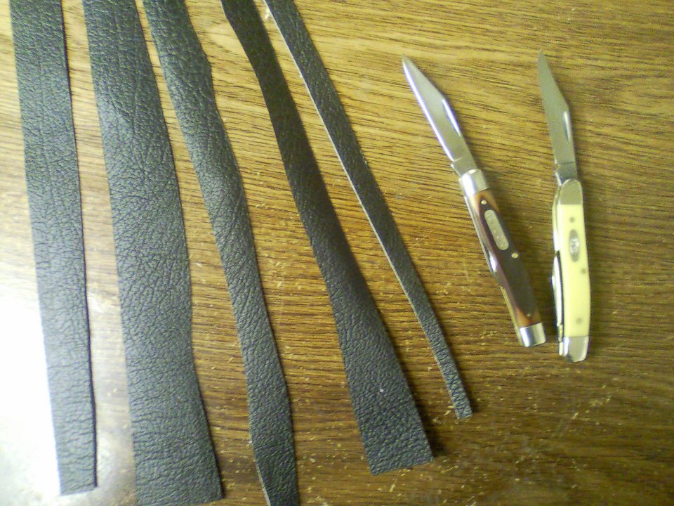

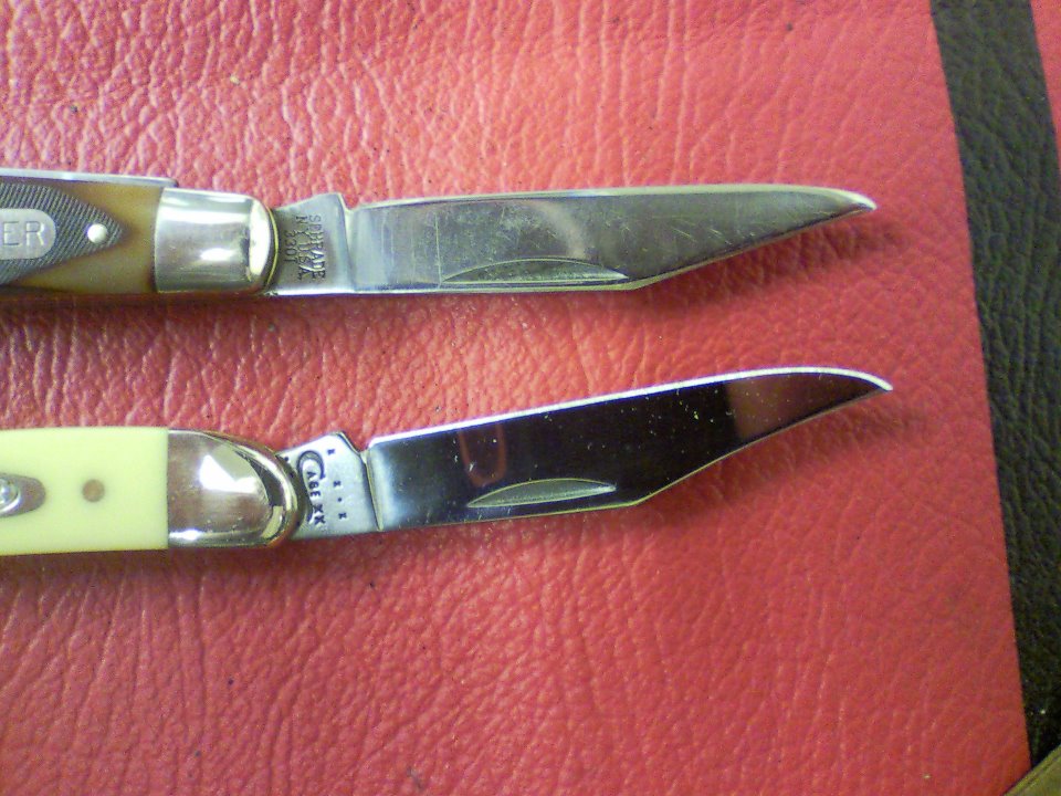

After reading your posts I signed up and did my own little test out of curiosity using a CV case 109 pen knife and a Schrade USA Old Timer 33ot. After digging through the collection I found these 2 knives to have the most similar blades as pictured. After putting as sharp of an edge i could get on them (used the old arm shave test until the hairs popped off easily) I alteranetly ran them equal amounts of times through leather, cardboard and paper. I even included my carry knife (a SOG Twitch II with AUS6) just for fun but it gave out about half way through. Honestly I was kinda rootin for the Old Timer. After about 20 mins of taking my time and trying to be as even and fair as possible the 33 OT finally started to struggle. However, only three 12" paper slices later and the CV was at the same stage and beginning to tear instead of cut. So at this point the CV seems to have the "edge" in my test. Now I decided to see which one would sharpen back to its original edge the easiest. This was a lot easier than I thought it would be. The CV was back to normal with a few swipes on the stone and a couple of passes on the strop. I had to put almost double the time into the 1095 (33 OT). Of course were only talking a difference of about 40 secs to about 1 minute 20 secs. If both of these knives had the same price tag Id have to go with the Case CV (I also prefer the yellow handle cause I tend to lose thing while coonhunting). But considering that you can get on Ebay and buy 2 or 3 of the 33 OT's for the same as one Case CV 109 Id have to go with the Old Timer. But as Time goes by the good ol' USA made Old Timers are getting harder to come by and ya may have to fork out the 40.00 to get this kind of quality. And in case your wondering I mistakenly bought one of the Chinese made 33 OT's on Ebay just last week. At first glance they are the same quality as far as tightness and snap. But theres a little lighter feel to the Chinese 33 OT. And I have no idea what kind of steel they are using in them but it doesnt hold an edge like the Pre-2004 USA made ones do. Hope this helps guys! I had fun doing it. Now I got a mess to go clean up. Anyone need some confetti?
