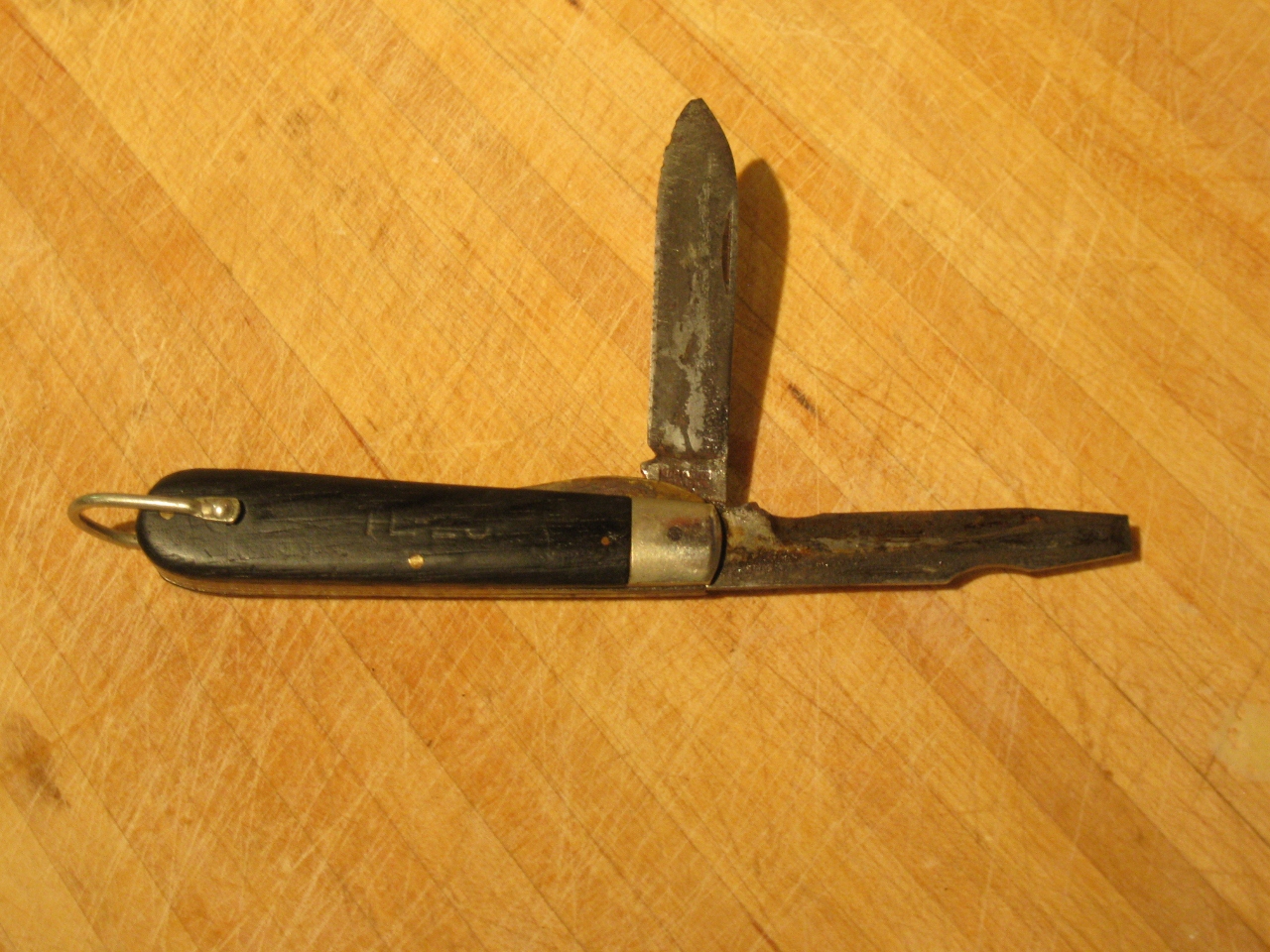

In an effort to learn more about making folders I have ripped apart a couple of "more than gently used" US made electricians knives. Here's my question: the holes on the blade, bolsters and liners all seem to be different sizes, this also appears to be true with the holes in the backspring, liners and liner lock. Were these pins pressed in at the factory cause it doesn't look like they can be replaced with a couple medium taps with the good old hammer, can anyone help?

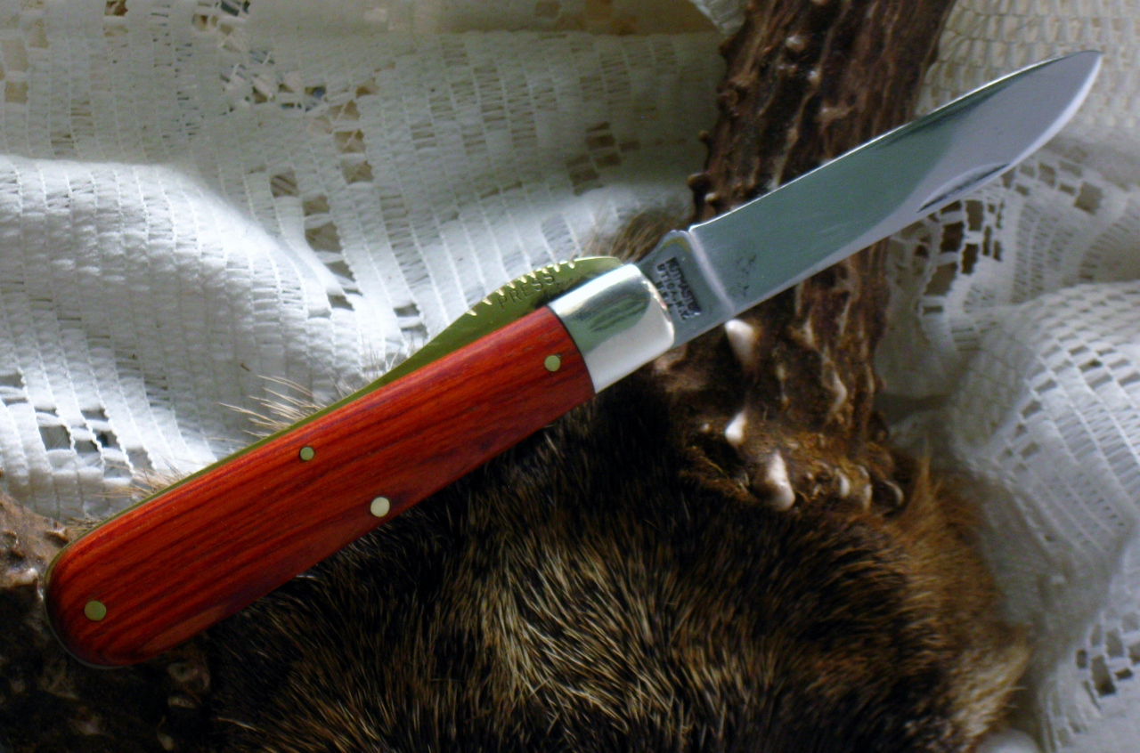

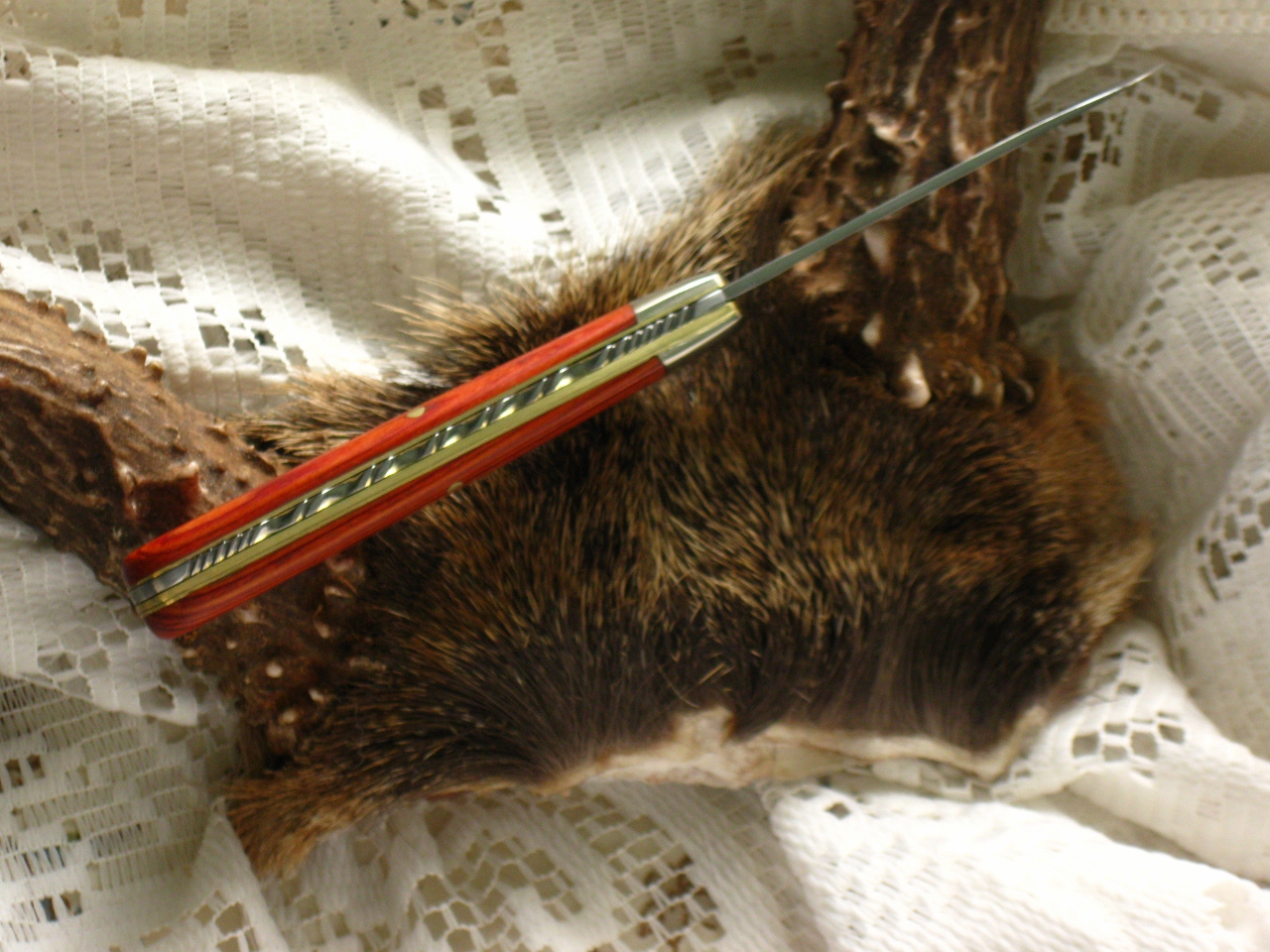

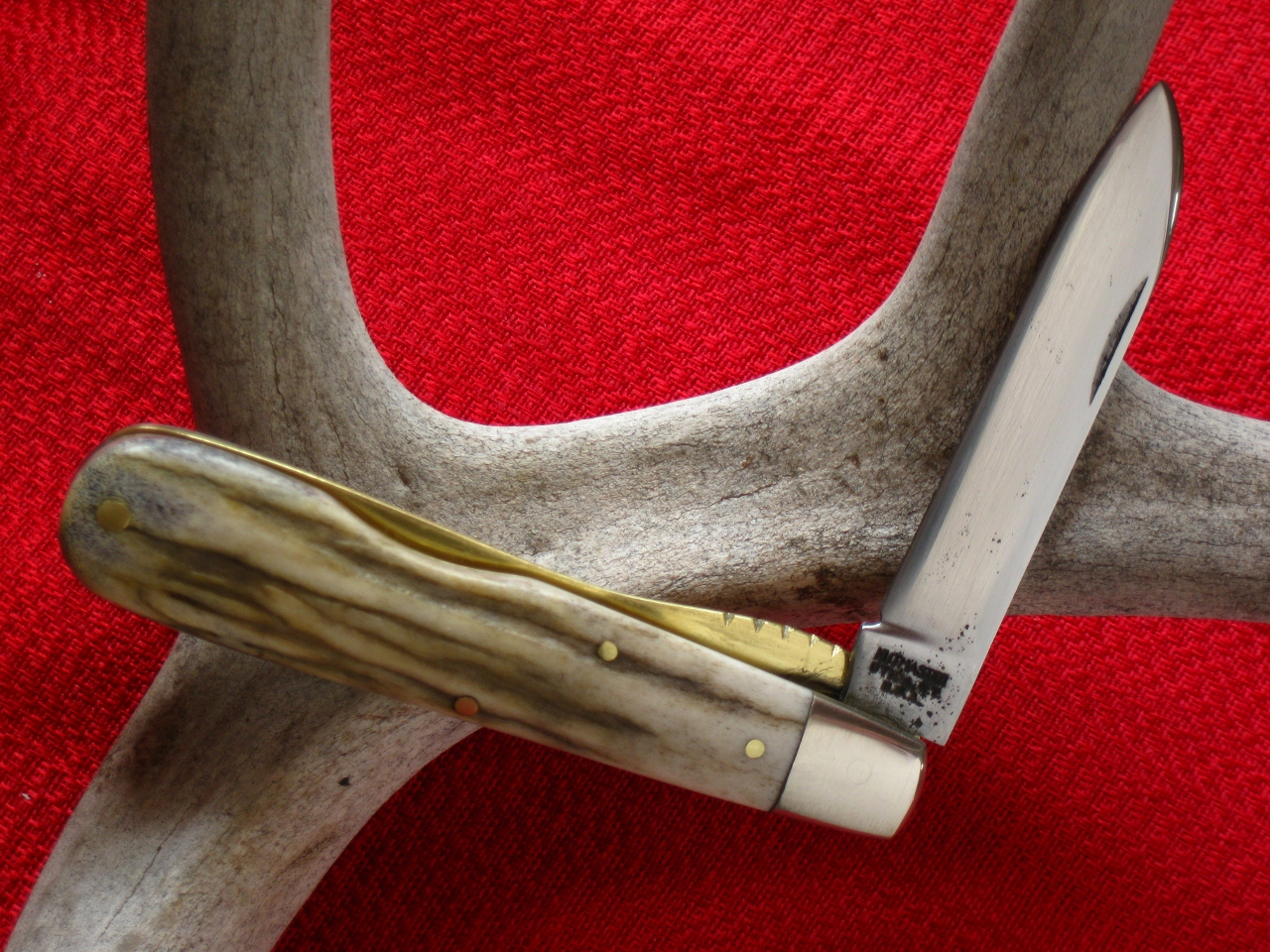

The blades and spring holes are larger than the liners, liner lock, and bolster holes. The holes for the handle material are close to 1/16".
Most of the liners only have one of these next to the bolster. I have taken 1/16" pin stock (brass rod from Ace Hardware) and 3/32" and turned them down to fit. I found it's easier to just drill the liners with a 1/16" drill bit and counter sink the inside a little to peen the handle material on I also add a second one towards the top of the knife. The two pins for the springs can be turned down from 3/32" stock, or again just drill your liners, liner lock and handle material with a 3/32" bit. The hole in the bolsters I always turn down and never re drill, the nickel silver stock is 3/32". The pictures should enlarge.
