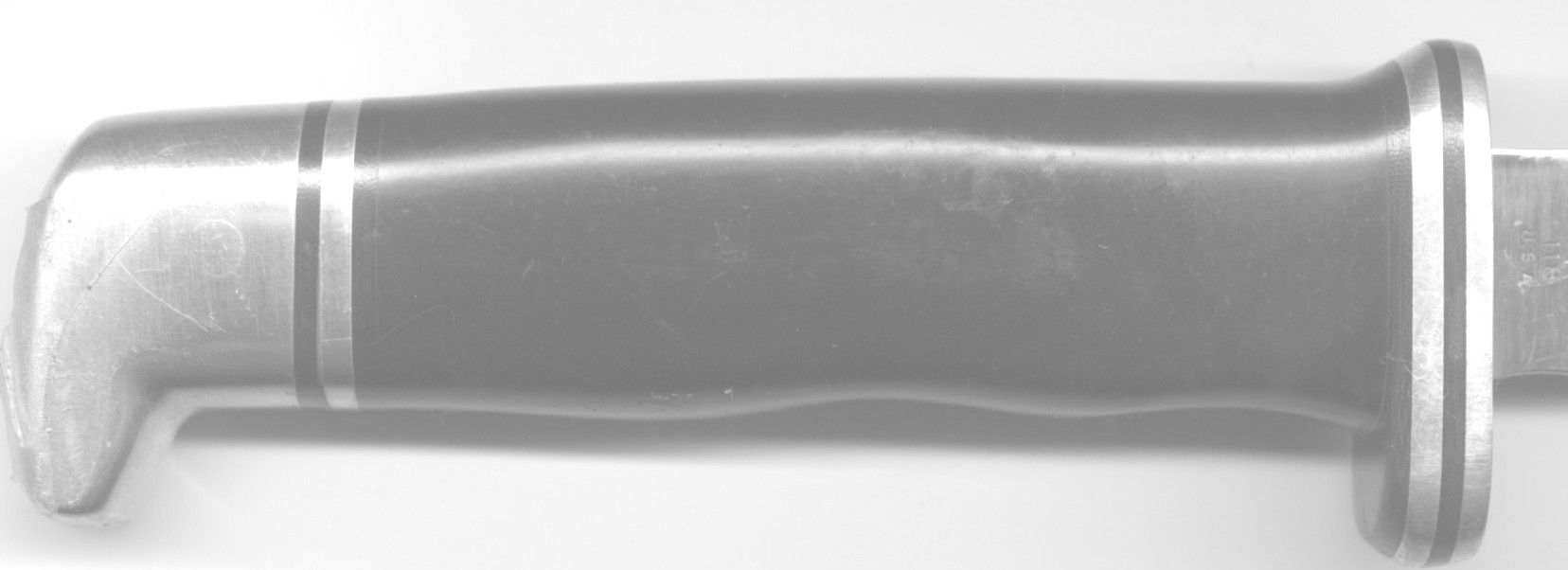

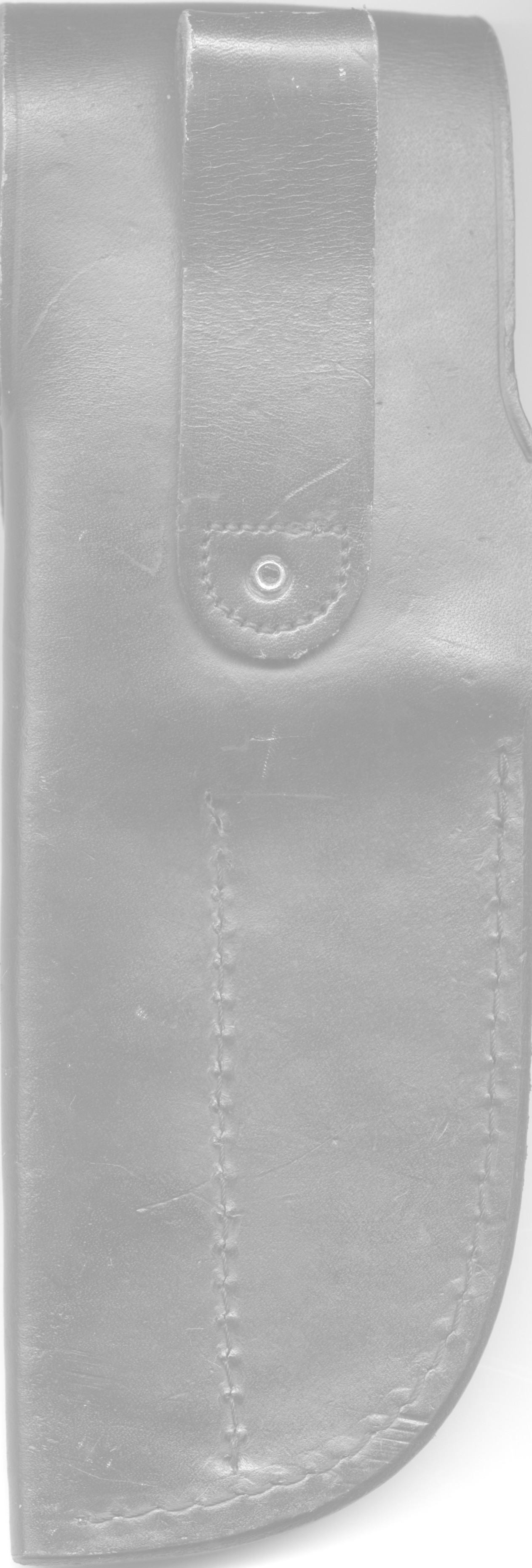

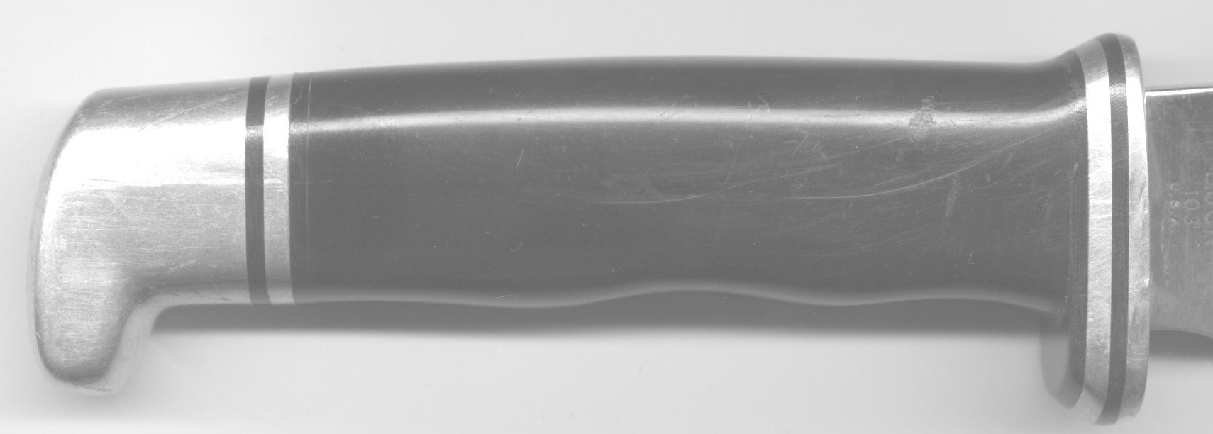

I am inserting three more exploded scans to hopefully substantiate my reading of the knives, sheath and Joe's treatise. I would have to say the knives are group 1 1972 and the sheath as a guess and hope would be early in the first run as it has no marks on back.
I Thank you both for your replies and am looking forward to your take on the above.
moss
Edit: Darn I mis-read, They would be group two 1973 and later as the stamping is not inverted. Still no explanation for the sheath.
Re-Edit: I think I shall refer to it as a 1976-77 that way I will be with in a three or four year span. Still pretty close.
moss

There are a few of the twin sets on ebay right now. One of them with the three line stamp like your's showed the back of the sheath and no stamps on it just like your's.
