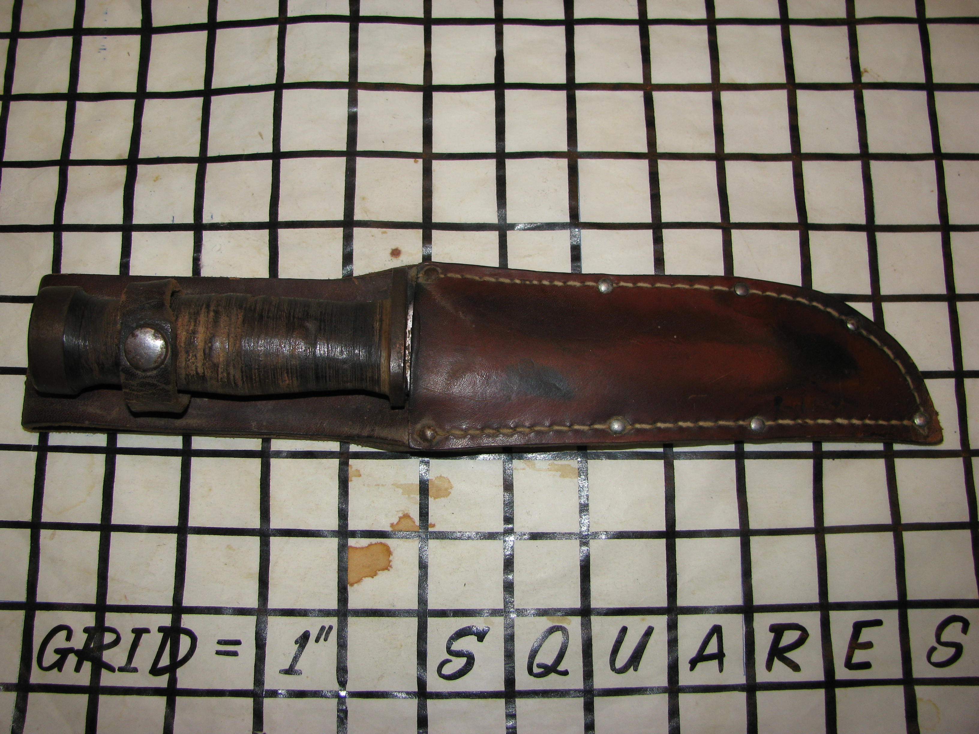

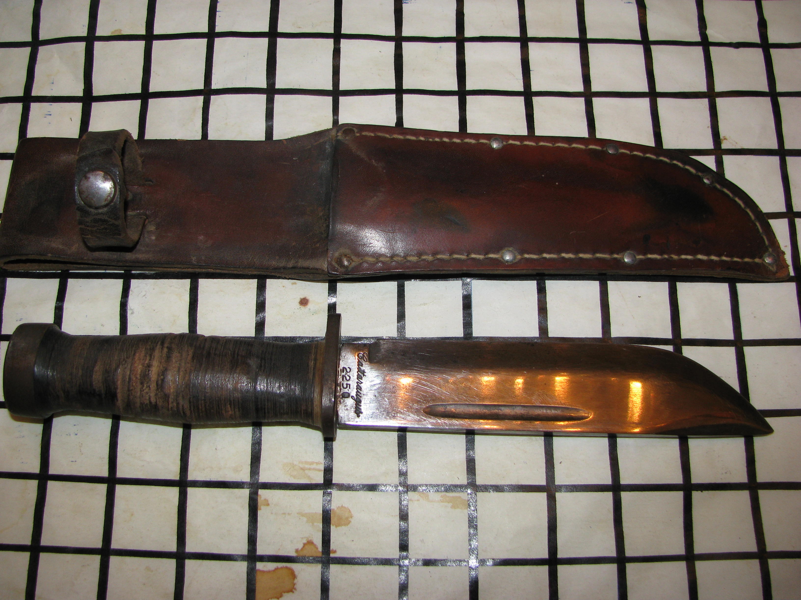

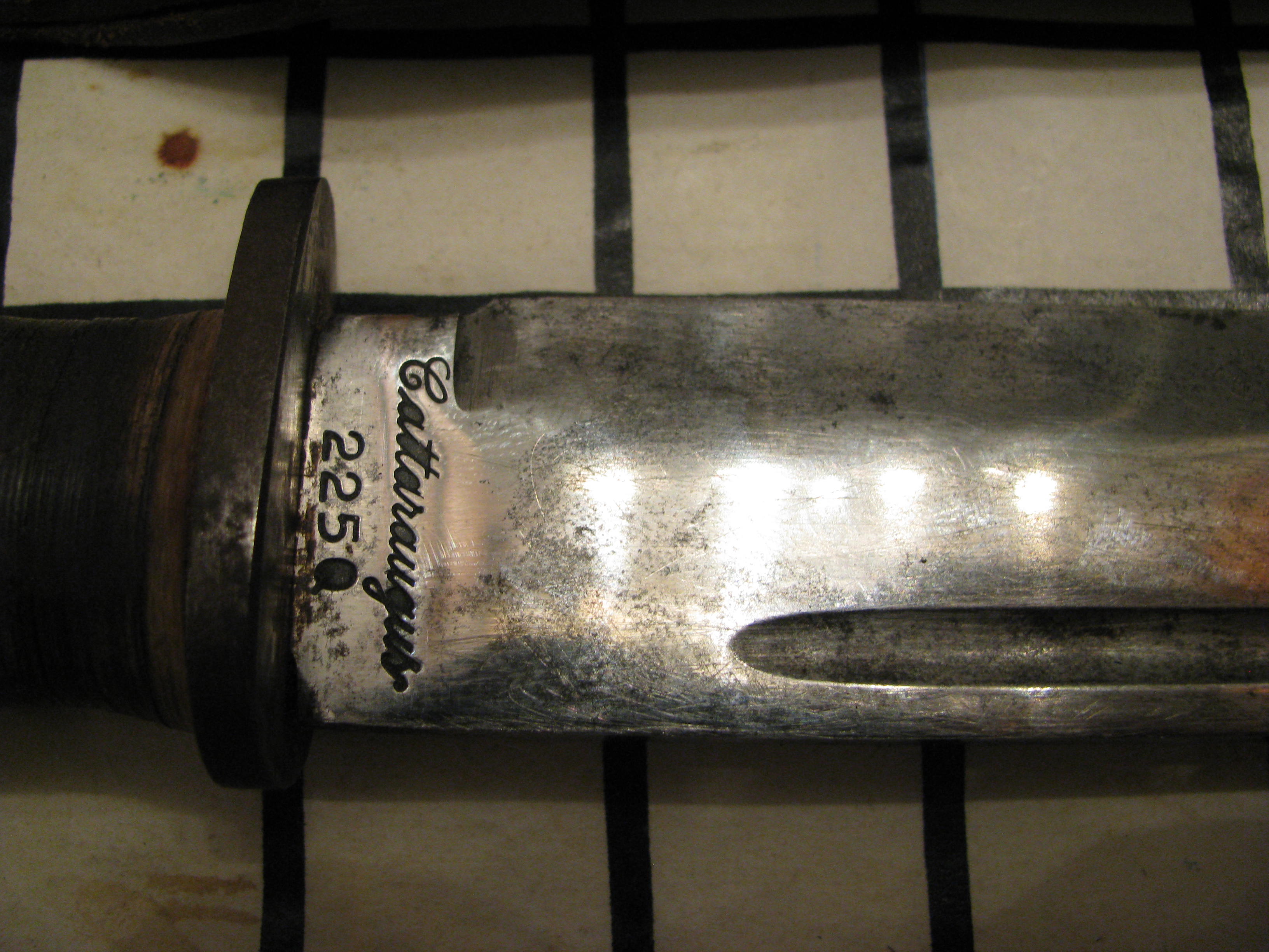

Just had this given to me the other day.Had some light corrosion and looked as though it had never seen a stone.Clean up;sharpen;ready for service.

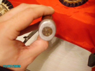

i have one from my father inlaw.....he carried in vietnam.....
pics to come
......but as i look @ it, the "c" has a tail that goes under and across (like the old case tested type) and "the better quality knife" under that.
on opposite side marked : made in usa
has brass,leather ,black and red (plastic???) washers.....
both guard and butt cap are aluminum..................
pics to come
- Junebug 2016
- Junebug 2016
Re: Catt 225Q
is this a 225Q???????
rehandled?????stock?????
also butt cap is a lil' loose.....how would one tighten???? any tips???? thanx guys!!

Re: Catt 225Q
JB,
Your knife is not a 225Q.
It is Catt`s top quality hunting knife line. They also made a hatchet.

Re: Catt 225Q
do you have a pic of said tool......?????????thanx M.B!!!
