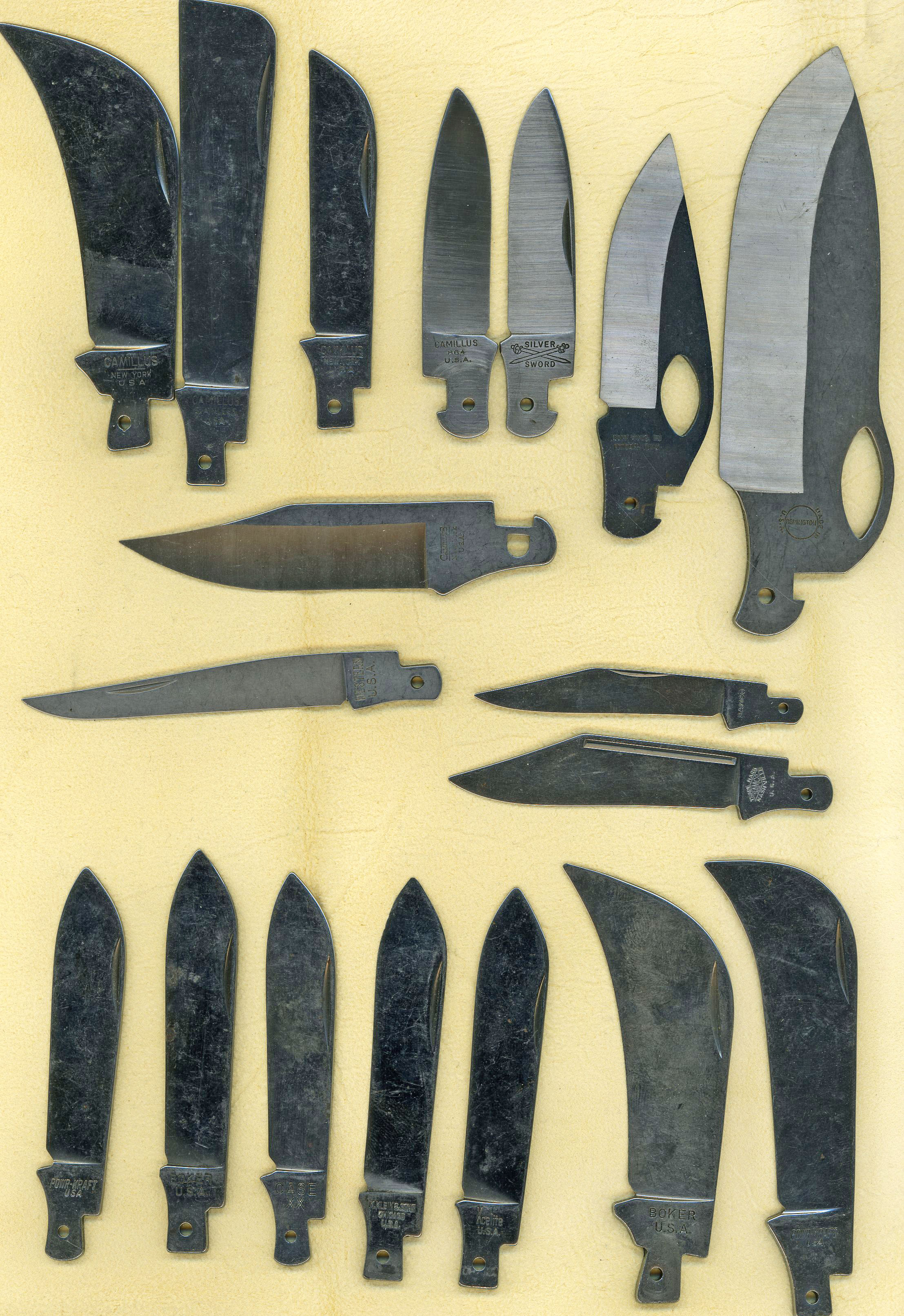

I was talking to Charlie on the phone & mentioned some blades I had made by Camillus.
He asked me to post a pic of them.
Many of them came from Tom Williams (CAMCO), and the others I bought off ebay.

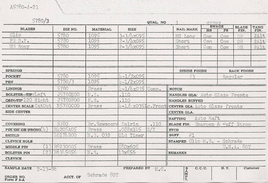

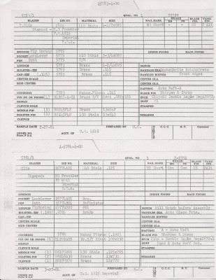

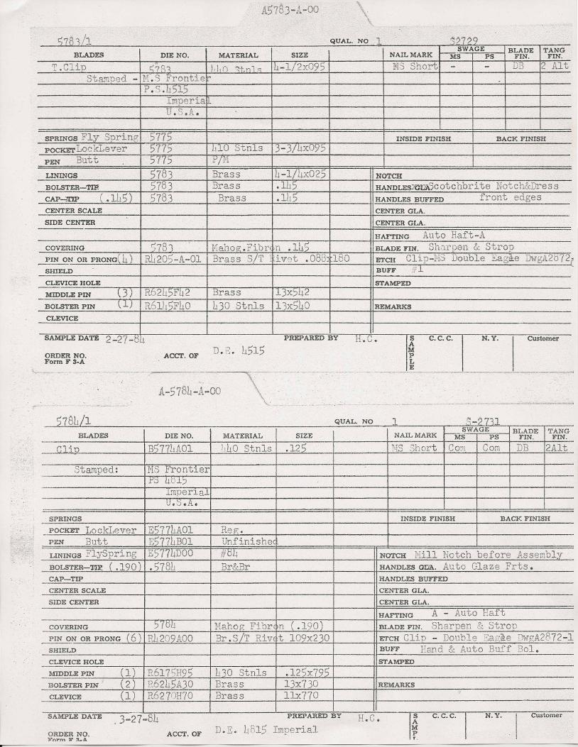

Here is a Camillus S-Card for some February & March of 1984. They are for the production of the Frontier 4515 & 4815. As you read the S-Cards you will see that it gives the people in the factory all the production details they need to know to make the knife.
The S-Cards are courtesy of Tom Williams (CAMCO).

Thanks Orvet for the S-card post. I have 15 or 20 Frontier knifes in my collection. Is there a way of knowing which company (Camillus or Schrade) made any given Frontier knife with out taking it apart?
orvet
Posts: 19893
Re: Who makes them now that Camillus is gone?
Post by orvet »
hot tempered steel wrote:Thanks Orvet for the S-card post. I have 15 or 20 Frontier knifes in my collection. Is there a way of knowing which company (Camillus or Schrade) made any given Frontier knife with out taking it apart?
Not that I am aware of.
I can't tell the diff between a Camillus made 8OT & the Schrade version, except for the fact that the Camillus version has no Swinden key.
On a knife without a Swinden, such as a LB-5, I couldn't tell you which company made it.

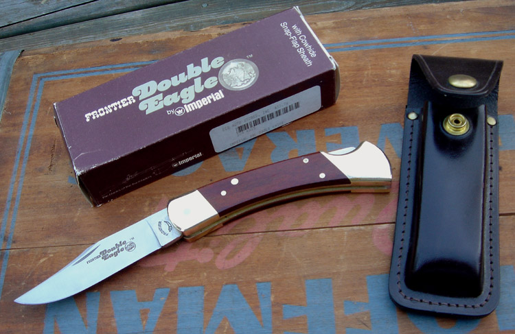

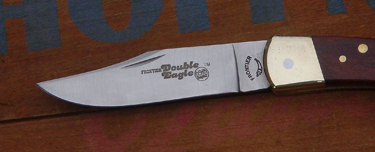

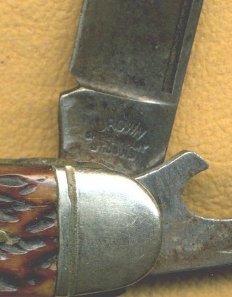

Here's a shot of one of the 4815 lockbacks on the s-card in Dale's post. Great reference Dale! Sorry I didn't reply sooner Hot Tempered Steel, hadn't gotten back to the thread in a couple of days. Dale's answer is a LOT better than I could have done though ::tu::
Eric
PS- They used stainless pins on these for added strength.
Imperial Double Eagle mark side.jpg (55.43 KiB) Viewed 4834 times

They made the 8OT and many others.
I was shocked one day in my shop when I took apart a 61OT and found it did not have a Swinden key.
That is because it was made by Camillus.
When you think about it, Albert Baer owned both companies. If Schrade's production was booked, why not have Camillus make them? Better to have both factories running at near capacity than have one backlogged and the other running under capacity.
Here is a copy of the S-Card on the 8OT.
hot tempered steel

Texx - Please post pics of your knife. Phil can probably tell you who made the knife.
Thanks again Phil.
