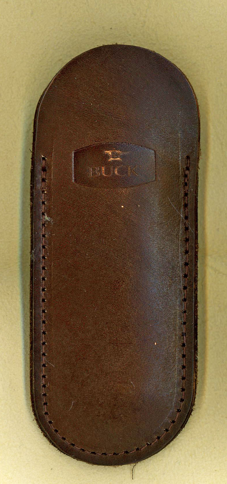

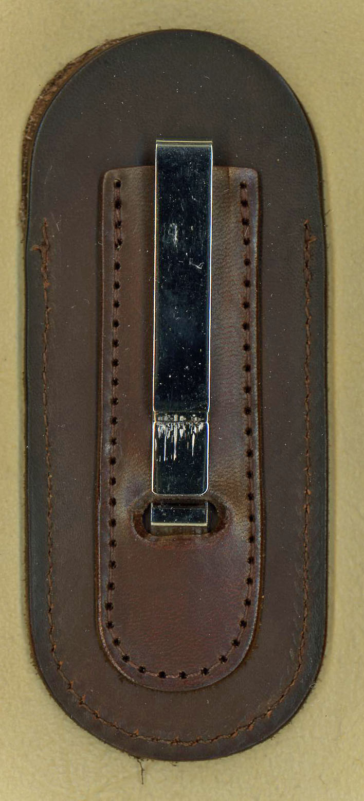

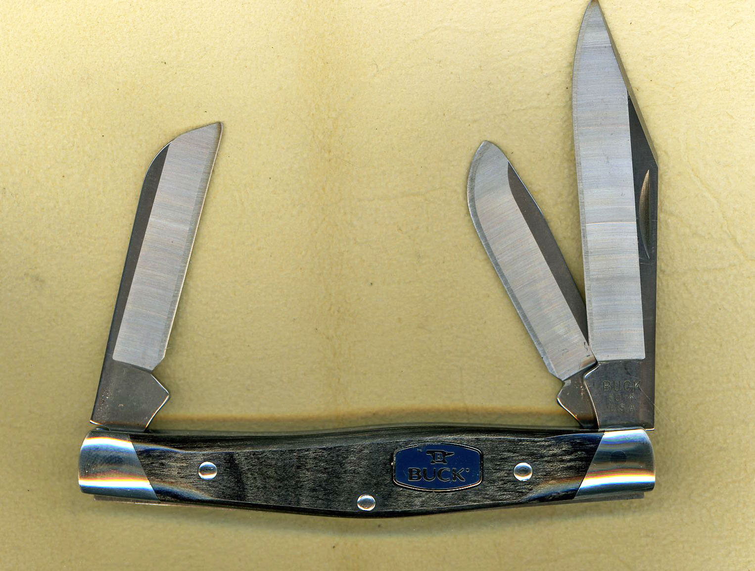

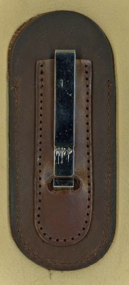

Not to beat a dead horse, nor to tell Joe & Chuck how to run their company, but I do believe that the market is also ready for a line of Buck knives (slipjoints) with bone handles.
It is not necessary to go overboard like Case does, (IMHO) with 25-30 different handles in each pattern, but a few bone handled Buck slip joints every year or so would be snatched up by collectors before they had a chance to set too long on any shelf.
It will be interesting to see how well the Companion, Lancer, Stockman & Cadet patterns do in the Charcoal Dymondwood® series that Smoky currently has running. (see pic below)
I bought the Stockman in this series and I am very impressed. Though the color would not have been my first choice, but the slanted bolsters and the new shield sets the knife off nicely. It works! The pouch type sheath with the clip on the back makes an nice looking & functional accessory.
I do not know if this item is exclusive to Smoky or not, but I imagine it would do very well in retail outlets other than Smoky.
I would love to see Buck step into this market. The choices we collectors & users have for quality American made slipjoints is shrinking. Buck makes a quality product at a very reasonable price. I believe they would do well.
