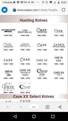

When it comes to Case tang stamps it’s easy to be confused. One thing to keep in mind is, for stamps used prior to 1965 no one knows for sure the exact dates they were used. There are no existing factory records so they’re all “guesstimated”. Compare the chart John posted with these from other sources.
Or this one on the Shepherd Hills Cutlery web site https://www.casexx.com/Library/TangStamp.asp
