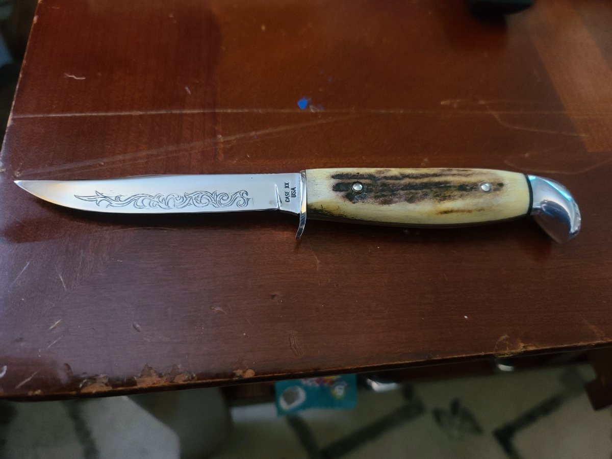

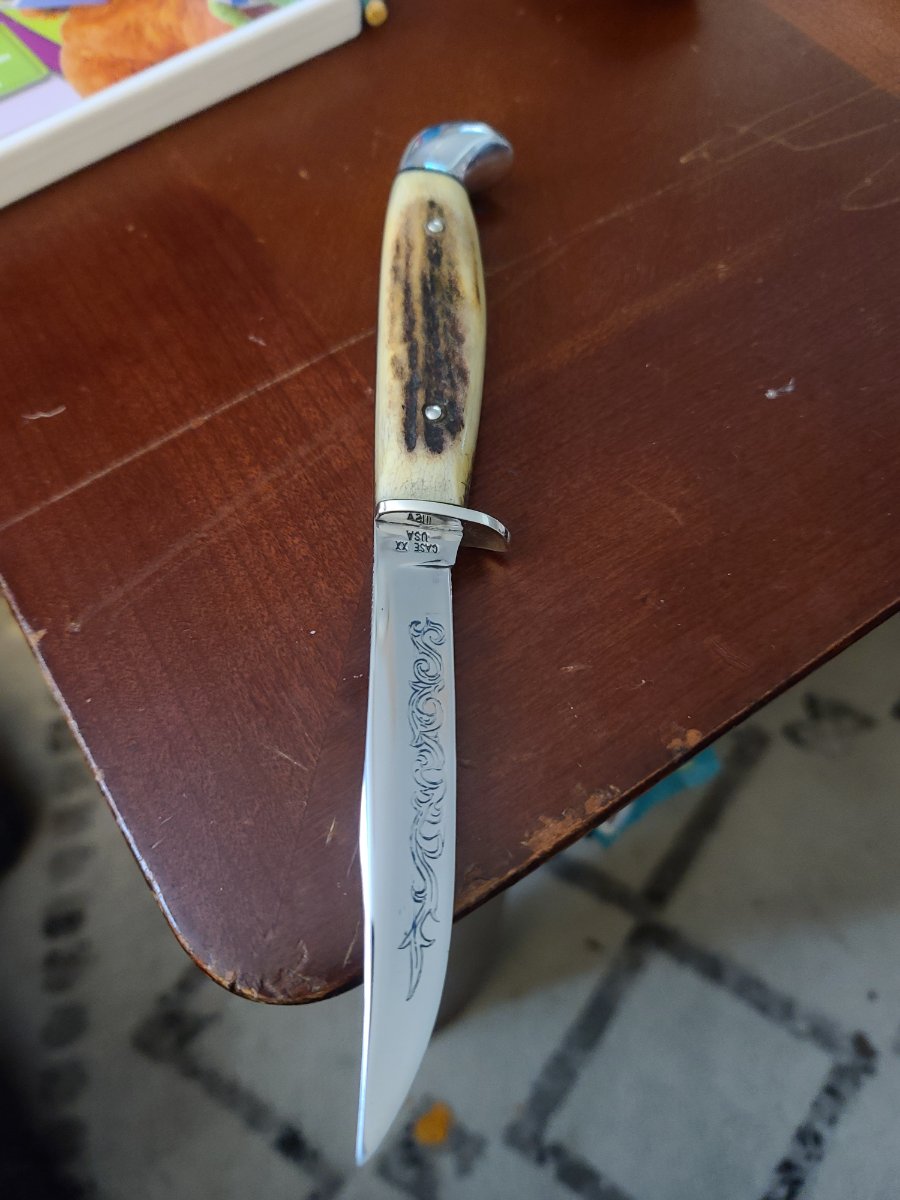

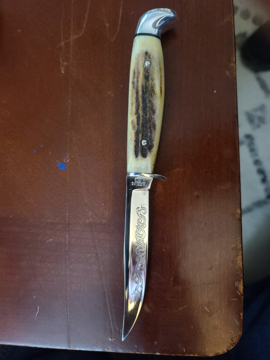

I found 2 rusty fixed blade knifes a 5 Finn and a M5F but thru more polishing than I care to admit they are back to like new condition all but the paint. I have tried Enamel but won't stick after it dries, I'm preparing to try Enamel Paste when it arrives in the mail but if this doesn't work I'm kinda outta ideas. Any knowledge on the subject would be greatly appreciated Thanks.

Does anyone know the method Case used to paint the 1977 Blue Scroll edition knifes.

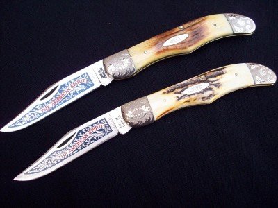

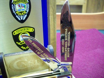

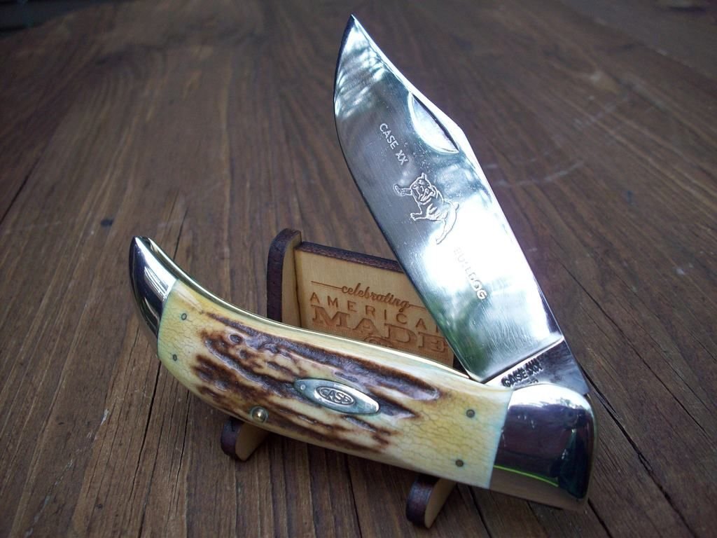

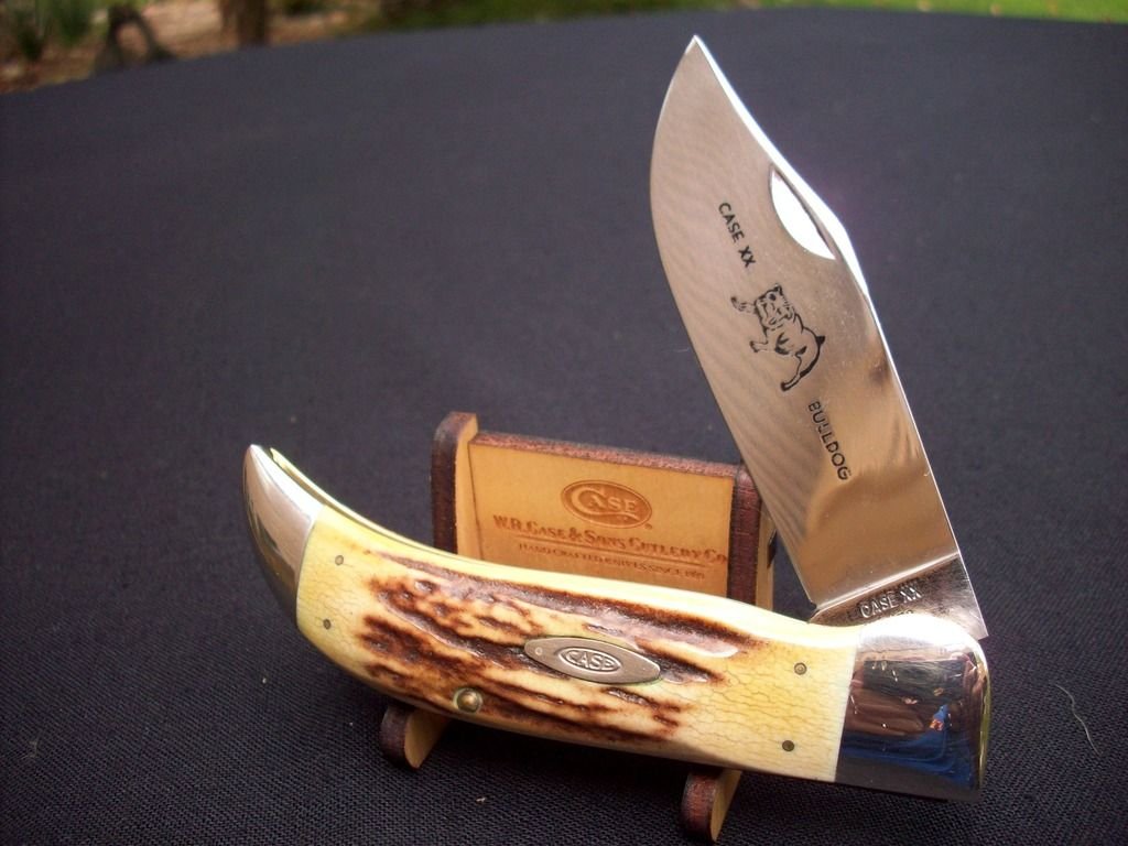

Per Ken's suggestion, this has been copied and pasted from my very first post on this Forum.
This process only works on DEEP BLADE etches. If you try what follows on the more modern surface "etch," which is really just paint on the surface of the blade without the color actually being deposited in a subsurface depression in the blade, I suspect you will do MUCH more harm than good.
If the etch needing repair has a gold fill, a good product to use is Liquid Leaf from Plaid. If it is any other color, use a good grade of enamel, the kind that is sold in tiny bottles for hobbyists. Clean the blade thoroughly using first mineral spirits and then alcohol. Vigorously shake your paint as the product has a tendency to settle and separate very quickly. Using a fine tipped artist's brush (cheaper the better), paint over the letters or design of the deep blade etch with your paint/coating. Do not try to paint the letters, just paint over them. Be sure you completely cover the etch and the area around it. At first, the paint/coating will hide the design of your etch under the coating. Then, you wait. You need to let it dry completely. Hours, not minutes. As it dries, you will see that the paint actually dries flat to the knife surface and the deep blade etch again becomes visible through the paint coating. Then, using a single edged razor blade, carefully lay the sharp edge of the razor blade very, very flat on the knife blade. Angle it slightly, being sure to keep the edge of the razor blade flat against the knife blade. Applying some pressure to the center of the razor blade to insure that the blade stays flat to the surface, slowly and carefully pull the razor blade along the length of the knife blade. (Remember, you are not trying to remove metal, only the unwanted portion of the coating. So, don't press too hard.) The razor scrapes the paint/coating off of the raised surface of the knife blade, leaving behind the paint that fills the subsurface areas of your blade etch. It may take a couple of passes to get it all. And, that's it. The blade etch is once again color filled. If you didn't get it completely the first time, try again.
Remember this only works on knives with a subsurface, preferably deep, blade etch. Here are pictures of some blades repaired using the above process. The Case Railsplitter Jack 5299 1/2 had lost its gold etched fill completely. So, there was no color at all on the blade. No black, no gold. The process described above is what brought the color back. The third picture is of two Case 5165 Folding Hunters that go back to 1976 and were a Bicentennial Commemorative. The top one shown was used by its previous owner and there was no color fill left to any part of the blade etch. It was 'restored' using the above process with blue and red enamel. The bottom knife in the picture is a factory original Bicentennial Folding Hunter to use for comparison. This one was more difficult as the blade etch was not as deep. So, this took several passes. I hope this helps you out. Finally, there is a picture of a Case Bulldog Clasp knife, both before and after.
